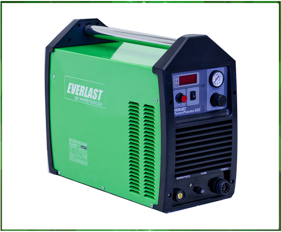

Plasma Arc Cutting (PAC) can be used to cut virtually any metal, including stainless and aluminum. The high temperature flame exceeds 10,000 degrees Fahrenheit. The flame exits at supersonic speeds, making quick clean work. Accurate cuts can be made easily without special equipment. Almost anyone can learn to use a plasma cutter with very little instruction. Initial purchase cost for a typical plasma cutter is much higher than the usual investment required for Oxy-fuel equipment. Also, a plasma cutter requires a suitable air compressor to supply the ionizing gas to create the plasma. Demand is quite high, so a larger compressor will need to be purchased. On average, for most small plasma units, a minimum of 30 gallons and over 5 cubic feet per minute output at 90 psi will be required. Air dryers are a must. Dry air is essential to plasma cutting and must be considered as part of the maintenance price to operate. Electricity requirements must also be considered. Most plasma cutters capable of cutting more than sheet metal thicknesses will require 240V, and up to 70 amps. Inverter plasma cutters such as the Everlast PowerPlasma series reduce power consumption, though and lesson power demands over transformer based cutters. Consumables are also part of ongoing cost, with price ranging from ten to more than twenty dollars for a full set. Improper use and abuse can reduce consumable life to make it an expensive option. Most plasmas are limited in practical cutting thicknesses. Many companies offer a "real" cut range, and a maximum severance cut. Be sure to evaluate the real range when buying the unit as your base guideline. Most plasma cutters are not intended to make extended cuts at the severance cut thickness. With that said, most plasma cutters that would appeal to a small shop or homeowner will offer a real cut range under three quarters of an inch, not meeting the thickness of cut offered by even the smallest oxy-fuel systems.
