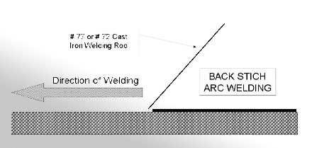

First the cast iron that is being welded has to be cleaned properly. This is done with a degreaser. Any accessory parts to the material should be removed. If you are welding a small crack, you have to determine the beginning and ending points of the crack. You should then drill a 1/8 inch hole, also called the ‘stop hole’ at each end of the crack. You can use sand paper for grinding and also look through a magnifying glass to se the hole. A ‘V’ shaped has to be ground down the length of the crack. You should take care not to go all the way through the cast iron.
Pre- heating of the whole cast iron material to be welded to 500 degrees C is very essential. This helps in prevention of any damage that may be caused due to heat from the welding process. The right welding rods should be used and welding should be done on low heat at each end with short tacks. While welding, you should do it in the same direction each time. Where ever the crack is too long, short welds should be made. While welding cast iron, short cool down time should be allowed between welds so that heat is kept to a minimum.
It is very essential to let it cool down slowly to an ambient temperature. It should be placed in a hot oven. The temperature should be kept at 50 to 60 degrees per hour until air temperature is reached. The material can be wrapped in a fireproof blanket or dry sand can be used, in case a hot oven is not available.
