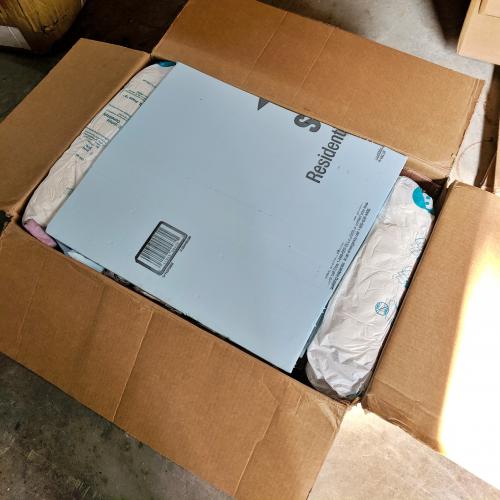

Well Done!
  • Size of the box was correct for the type of machine. The foam board and "foam-in-bag" expanding foam properly supports and protects the unit.
  • The packaging used is both on all sides of the machine, creating a resilent and protective packaging.
  • The box was shipped new and was double walled.
  • This machine would not jostle inside of the box during shipping and would be well protected.

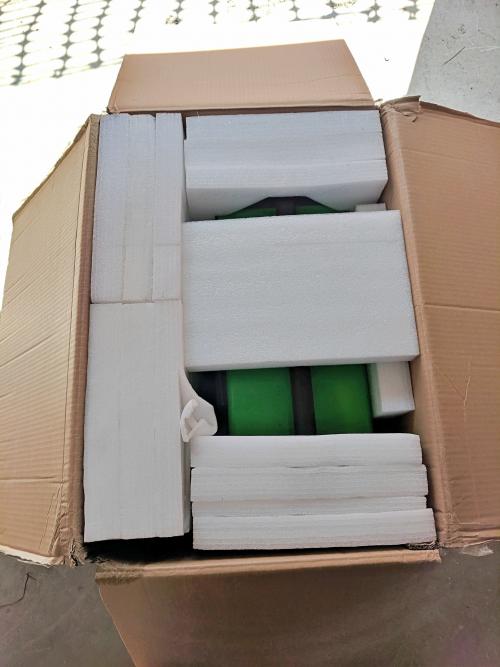

Well Done!
  • The size of the box is correct.  It does not allow the machine to exhibit any excess movement.  There isn't  a lot of excess room around the product, but allows for enough packing to protect the unit from movement and impact damage. The packaging is very sturdy.
  • The packaging used surrounds all sides of the machine with no extra space around the unit.  It is reselient and won't break down.
  • The  type and condition of the box itself is correct.  It was not a used box and was double walled. This machine would not jostle or move around inside the box during shipment.

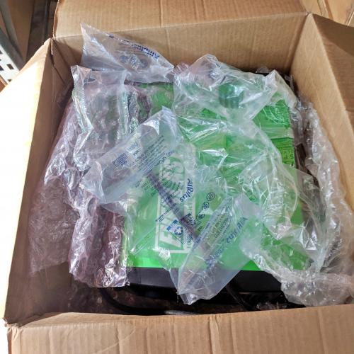

BADLY DONE!
  • All machines, including smaller one, should be packed in a box in a way that does not allow it to move inside of the box.
  • Bubble wrap and air filled pillows are not protective materials for heavy objects with corners or edges.
  • Unit was shipped on its side.
