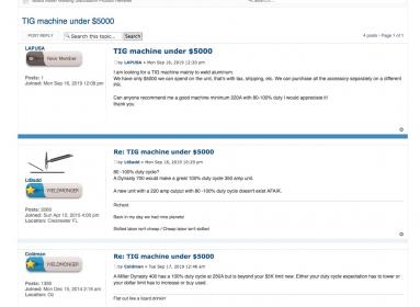

    Here’s some text of someone seeking advice elsewhere (where I'm permanently banned) on a potent TIG unit with a high duty-cycle:
    “I am looking for a TIG machine mainly to weld aluminum.
    We have only $5000 we can spend on the unit, that's with tax, shipping, etc. We can purchase all the accessory separately on a different PR.
    “Can anyone recommend me a good machine minimum 220A with 80-100% duty I would appreciate it!
    “thank you”
    And the responses are like the blind trying to lead the naive:
    "80 -100% duty cycle?
    A Dynasty 700 would make a great 100% duty cycle 350 amp unit.
    A new unit with a 220 amp output with 80 -100% duty cycle doesn't exist AFAIK."

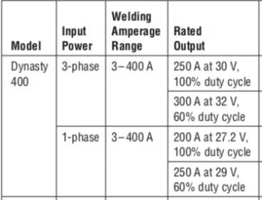

    "A Miller Dynasty 400 has a 100% duty cycle at 250A but is beyond your $5K limit new. Either your duty cycle expectation has to lower or your dollar limit has to increase or buy used."
    [That's not quite accurate, as the Dynasty 400 is 60% duty-cycle at 250 amps on single-phase power, but on 3-phase power it is rated to 100% duty-cycle at 250 amps.]

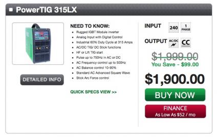

    But, that Everlast 315LX is certainly a beast when it comes to duty-cycle, with 60% at 315 amps, and 100% at 250 amps. That's even better than the 350EXT and 325EXT, which are both quite robust in their duty-cycles.
    I mean, if you don't really want any added waveforms, what a beast that 315LX is, and at single-phase power input, no less!
