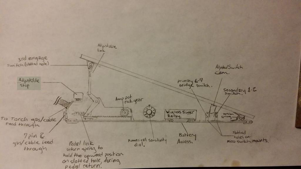

    I'll post pics of my draft soon and the parts that I have. I'm using a chrome foot gas pedal, for fun.
    This layout is mostly final. I think the primary 6 -7 pin bridge switch and 1-2 pin bridge switch will be closer in adjustment to each other, in actuality. I want the 6-7 to be active before and after the 1-2, but these adjustments are all going to happen within 1/4" at the toe, which is when I want the amp control pot on the rack and cog setup and linkage to come in.
    The picture in the thumbnail explains the functions much clearer.
    Once I get the components installed, after it is designed, I will draft a basic wiring diagram.

    With a SPDT micro switch, you really only need the single switch in your design. The control voltage changes depending on if you are running on 120 or 240 volts. It's 5 volts on 240 and a lot lower on 120. Also you might want to check that your 185 doesn't already have panel control for max amps even with the pedal. Others have reported that newer models do while older models do not. For sure a pedal or hand amptrol is very nice to have. As far as your remote, it's not just the frequency of the HF you have to worry about. When actually welding you have a very nice wideband spark gap transmitter going right in front of you. DC isn't too bad but on AC you will get interference all over the band. Some circuits can take it while others can't. Before you commit to something I would do a few tests. Have fun.
    It's definitely going to be apart in a pile of wires, while in trial and error, before I end up using anything in the pedal. The volt range for the signal seems like it's well within the micro switch capability. Good to know.
    I'll definitely do a wiring test run with the remote switch, with AC. Maybe I'll lock the remote button on and see what it does when the torch moves near it. I'll try it through a range of frequency on the AC control, but I know that Miller makes a completely wireless pot foot pedal that works, so someone is doing it. I'll see how close I can get it to the arc of the torch on AC, while I play with the analog on the machine, before I have it activate the torch. It does come with two remotes, so I suppose if I fry one, I'll have another to do something else with. If it's an issue at the torch, I suppose I could clip the leads long on the switch at the torch and hack the transmitter to wire the switch to the transmitter and get it away from the torch.
    I think I'll connect my multimeter to the relay on the receiver through the entire test with 110 and 220 to see if it has any continuity/ contact issues. I suppose aside from the obvious safety tests, function is also going to need testing. If it works, though, it would come in super handy.
    An SPDT switch would work. I over thought toggling between hand/ foot and forgot how simple it is. 6-7 bridged is the pedal, off will be hand. I've got the SPDTs , so I think I'll just run the center pole and clip the other lead off, or leave it and use them as an -/o switch for 6-7 and 1-2.
    This 185 is the newer model, so I know the analog becomes a max value on the pedal, with 6-7 bridge. The operator's manual came with a pinout for a 22k pot 7 pin, but there are also pictures of a torch and a few other variations that my package differs from. I still don't know if I've got a 22k or 47k, which is why I went ahead and got a 25k and 50k pot set. I'm gonna try combinations of both in place on the gear rack and the sensitivity, with and without a sensitivity adjustment. If the machine will set max value, the only good a 2nd pot on the pedal will do is to slow it down for more accuracy and inherently limit max value below the machine setting. I still think it's useful to have on the pedal, even though it may be a bit redundant, I can see myself using it to set the machine up on test metal for each project.
    Decided to skip the adjustable link on the pedal. All that would do is adjust L arm to pedal distance, which I don't feel is necessary. The idea was to get the rack and cog adjusted to absolute ohm when the pedal is on the its respective stop, but I went ahead and built the rack arm of the L linkage a little longer, so the linkage has 1/8" more throw than it needs, just to be sure.
    I can just put a stop screw through a push spring on either end of the rack mount for stops and call it good. The pot has stops in it, but they are only designed to stop an index finger and thumb from cranking it further. I've got my foot on this thing, so I'd rather have the linkage rely on it's own stops, even with a set of pedal down & up stops. The pics don't show the linkage, but I moved the slotted hole down into the bottom hole of the vertical link. It has 3/16" of slide travel, which I think should be enough for the pedal travel to engage the 6-7 and 1-2 switches, before moving the amps.
    I'm still waiting on the CK line, transmitter/ receiver and a few odds and ends. I'm going to wait on the rest of the parts to arrive and test the transmitter/ receiver (thanks Rambozo!) before I make the pedal casing.
    If I'm using this pedal under low amp conditions and pulsing the pedal, I will be releasing it almost completely. There is a time delay on the gas, but I wonder if I should put a time delay off switch in the 6-7 bridge, or if it matters? I'll see what happens when I connect a micro switch and leads to the 6 and 7 pins to see how responsive it is. If its instant, I won't need a delay to keep it in foot pedal mode. If 6-7 activates a relay or if it's recognized digitally, that may change my mind. I'd rather not wear something out in the welder by having the 6-7 constantly switched, although it may not even be a valid concern.
    I think I'm going to put an adjustable light tension ball bearing index on the rack, at the very least, so I can hear and feel an audible click, aside from the micro switches, at min amps before the trigger is released, so I can dip down to min amps for pulsing without losing an arc. I'll just be sure to put a larger bearing in it than the dimple, so my foot has no problem running back out of the index with ease.

    Neat project, Dave. I'm watching it with interest. I like the idea of routing a lead extension along with it.
    If you haven't found it yet, there was another project here where a guy was adding electronics to his pedal to add pulsing and 4T ramping. A different goal, but there are probably useful bits about the pedal interface there.

    On the real pedal the 6-7 is just a shorted wire between those pins. I't sole purpose is to tell the welder that the pedal is attached and to change the amp control to the remote jack. No need to switch it.
    Setting it up so you can feel the min setting before it shuts off is a good idea. However, it might not be an issue as there is usually an area of deadband at the end of the pot travel where the value doesn't change. So you kinda know where minimum is. A lot will depend on pedal adjustments, so YMMV. The big thing is to try to eliminate any slop in your linkage so the pedal has good control and feel. For thin material it really helps as there is not much margin of error, between full penetration and blowing a hole. A small flat spring under your rack to keep it tightly meshed to the pot gear might help, too.

    Rambozo, the 6-7 switching would be actuated at the first portion of the pedal, so when it's not in use, it automatically defaults to the hand trigger. I want to try this, so I don't have to switch anything to toggle between foot and hand controls, for tac welding in awkward areas and running beads. I'm wondering how quickly the 6-7 pin bridge activates the machine for this. I think you're right, this is just gonna be a trial and error thing. I can see a future laundry list of electrical testing before I get into final build. Especially if I am going to run a pulse control for DC in it. I might as well. It would be nice.
    I like the idea of the spring tension on the gear, but I would be afraid of the teeth spreading. The less taper a gear tooth has on engagement, the more outward force it applies. This is why VW engines always need align bored when rebuilt, from timing gears spreading and why some aluminum case manual trans designs have issues with countershaft gear bearing damage.
    I would be afraid of it jumping a tooth, pulsing it on more throw, but maybe if the spring didn't have as much deflection as the teeth were deep, and just eliminate distance allowed, that wouldn't be an issue. I also thought about putting a series of sealed bearings under the rack. If I can get some that are small enough, or even just some small, stainless rollers, it wouldn't add to the pedal height. I've already calculated enough room to put something under the rack to slide on, anyway.
    The dead spot on the pot makes me think I should probably make an adjustable index spot that holds the bearing and spring, so I can find the front to middle of the low amp and set it there.

    OK, now I get why you want the 6-7 to be shorted by the pedal.
    The reason I was thinking of a spring under the rack is that the pot is not the ideal true running shaft and depending on various other things you will probably need some gear clearance to keep things from binding. The spring could take up that clearance and accommodate any irregularities. The actual amount of movement needed is very small, a fraction of the gear tooth depth.
    Having as much adjustable as possible will always help for a prototype. As long as you can adjust the gear on the pot with a setscrew, I think you can get it all dialed in. For sure have the adjustable pedal stops you mentioned. The pot may not even require it's full travel to get the full amp range, and it's stops are very weak.

    Another test you should do is to see what happens if you have a pot hooked up but the 6-7 un-shorted. Since this was designed to either plug in the pedal or plug in a torch switch, there is no reason to assume that the external pot is switched completely out of circuit. They might leave one or more connections in parallel with the panel pot, and that could cause you some grief with panel set torch switch control. Easy thing to fix, but you won't know until you test, and it might change the number of poles on the switches you get.
    You could do 4T with analog or basic digital circuitry, but seems like more work than it's worth when you have a pedal to use instead. The DC pulse might be worth it, but you would be running the machine outside it's design parameters, so I would investigate the circuitry a little more before I added that, to make sure there is nothing that would be upset by high frequency switching. The welder may share the basic design with other models that have pulse, but again there is no reason to make that assumption. Projects like these are fun, but time consuming and there is always the possibility of releasing the magic smoke as you fool around. If you find you need more features, the easiest thing is to trade up to a better model welder.
    But don't tell me that, my watch words for new equipment are; "Don't turn it on, take it apart!"
    Two ways of spring loading the gears come to mind right off. One you could have the pot bracket pivot and use a spring on the pivot shaft to load it or a extension or compression spring somewhere. But my first thought was to just use a small flat spring under the rack. It could either be a folded V type shape or something like an inverted car leaf spring, with just a small hump to push up right where the rack meets the pot gear. You could probably even use a small strip of Teflon or UHMW (mouse feet) backed by a piece of double sided foam core tape. Nothing fancy just making as close to zero play as possible without worrying about everything being aligned perfectly. Quick and dirty rather than over-engineered for sure. I have a guitar pedal somewhere that used a rack and pinion and they just used what looked like a plastic cable clamp to act as a spring to push the rack into the pot gear.

    The spring idea is a good one. I think a rotating/ hinged mount on the cog gear will give a stable reading under spring tension that I can adjust with a set screw, along with a lift/ deflection limiting set screw. This way, I can also put rollers under the rack to keep it clean, more than anything. I was gonna use a chunk of ABS plastic from a cutting board, but I started thinking about this thing sitting on the floor for most of it's life, and I'd like something a bit hollow under it, to keep it from gumming up and getting lots of scrubbing debris and dirty over time.
