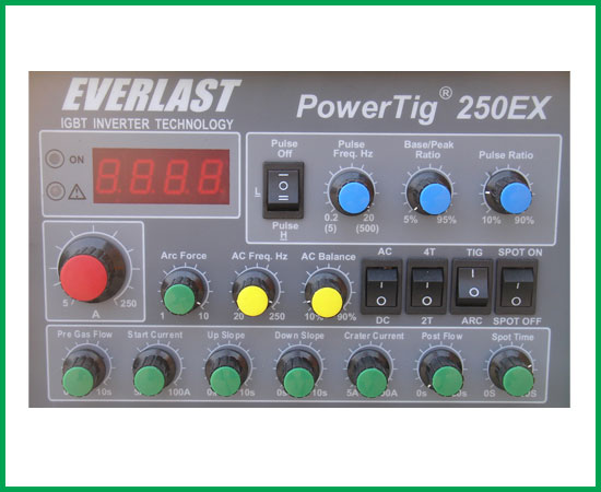

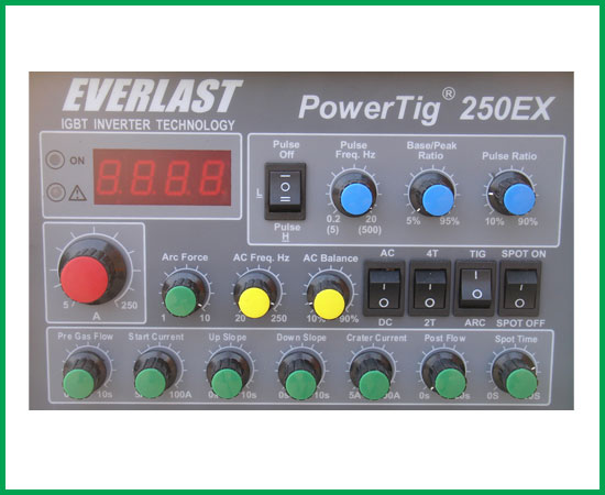

    If your ground connection is good, and it can't even make an arc in stick welding mode, then it could be an internal problem like a damaged diode or IGBT. Is there a "fault" LED or light on the machine's panel that is lit up?
    [Edit: triangle with explanation mark light in it, in upper left corner of front face below the "ON" LED:]

    No, I don't get any "fault" LED lights or anything. Everything appears normal, minus the fact that the arc does not form.

    The triangular light with the exclamation mark does NOT come on.
