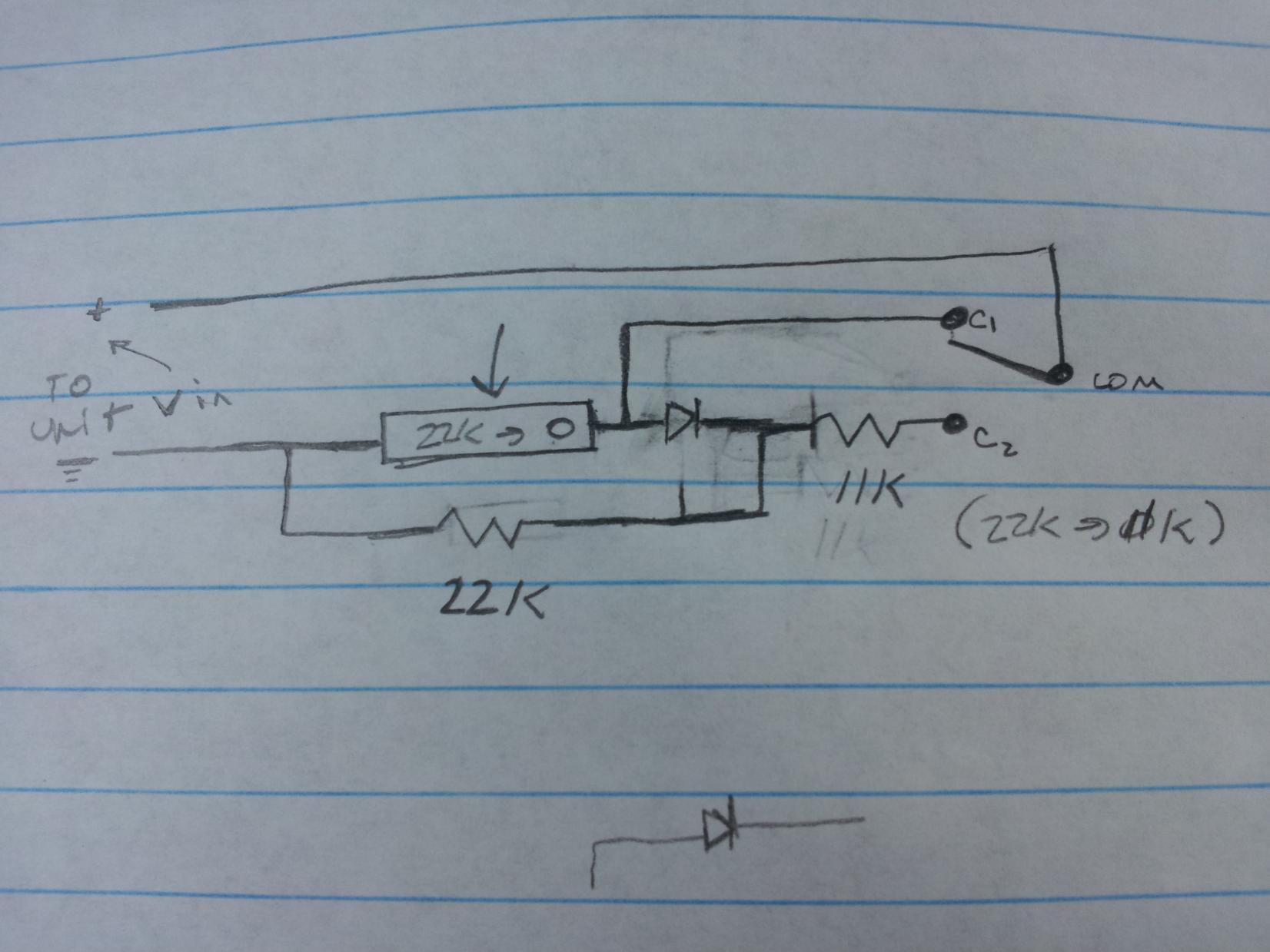

    I know that some blue and reds use anywhere from 5 to 15k ohms so you could say 22k is a little more standard.
    Mechanically I think I could place a second 22k pot which runs on a reduced gearing or pulley ratio so full pedal ends up being 11k or half power. I know I cant normally reduce the max res of a pot with series or para resistors AND keep it linear. Have to use an op amp or transconductance converter or some work around. If only 0 was 0 amps lol.
    Does the unit measure current or a voltage signal coming from the pedal?
    While sitting in the car for class I came up with this. Im going to have to test and run some calcs to see if its going to mess with the linearity of the pedal signal. If it doesnt or not badly then we're all good. If it does...well back to the drawing board.
    Essentially what Im going to try is to cut the sweep of the pot to only hit 11k to 0k during a full sweep, then zero shift it so it runs 22 to 11k. The diode on there is to keep the "secondary" circuit from flowing because both are connected at all times. The diode allows the switch to have control over circuit selection otherwise the parallel res would always leak in. This was how I figured to do this whole getup with just a single switch on the outside of the pedal. If anyone has ideas Id love to confer. Picking up a micro soon and I love to tinker.

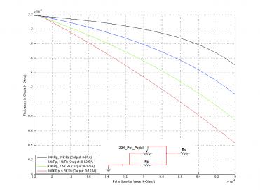

    I was thinking about this and decided to model a few different resistance values when the pedal goes from 22K Ohms to 0K Ohms. You'll also have to be careful with the use of that diode considering you'll have to overcome the forward voltage associated with it (usually 0.3V to 0.7V) and that will definitely affect the voltage drop across the resistive circuit. See the plot below for how different resistance values would affect the range of the output....
    Commodore, your circuit would work pretty well, if you just forgot about the diode, and replaced that single switch with a DPST switch. Depending on the the current through that circuit (and the diode) and the diode's parameters, you can get a very non-linear behavior, not to mention to the voltage drop. Also, your design will cause some non-linearity of the pedal because of the paralleling nature of the resistors.
    This is intriguing me, though. My mind is too tired right now, though. I'll think on it some more in the morning.

    Well, I'm a non-traditional student. I'm a software developer by profession and decided to finally go back and finish up my bachelors. I'm working through what would by my third year, slowly but surely.
    Quote Originally Posted by unixgeek View Post
    Ahh, cool. Well, stick with it! It'll be tough. I have sleepless nights to prove it!
    Anyway, I have a solution for you guys. All it takes is a tiny bit of re-wiring and another pot, which can be bought easily. This mod has a non-linear current control behavior, just like the original pedal. I suspect they did this or something very similar in the original design (aka, the prototype).
    Here's the circuit.
    I used a 100k pot here. The upper value of the adjustment pot sets your lower current limit. However, the higher the adjustment pot value, the more of an exponentially increasing current you'll get as you turn up the adjustment. So, it's a tradeoff between minimum current, and current adjustment granularity/resolution.
    Basically, the design requirement was setting the minimum resistance the pedal would ever generate, while having the maximum resistance always be 22k, such that pedal resolution was not lost. That circuit produces the following:
    The red plot is the maximum resistance generated by the pedal at rest over the entire adjustment pot range, notice it's always 22k. The blue plot is the minimum resistance generated by the pedal over the entire adjustment pot range. Notice it's non-linear like I said, with an exponentially increasing response. Again, you could fiddle with this if you wanted. With the 100k pot, you can get down to about 7% of full current. Not bad. In the lower adjustment ranges, this will also cause the pedal behavior to be slightly non-linear too. All about tradeoffs. It shouldn't be a problem, though. You can see it in this 3d plot
    One axis is the foot pedal position, the other axis is adjustment position. The Z axis is resistance. You can see the minimum resistance being limited, and the more it is, the less linear the foot pedal resistance becomes. It's not bad though.
    Anyway, enjoy your adjustment capabilities!
