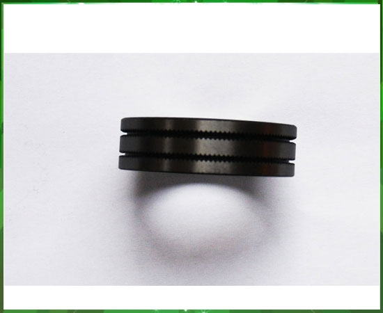

My machine came with extra .030-035/040 (.8/1.0) nurled roller for flux core/dual shield Attachment 7116. The same size V rollers for steel came installed.

So the standard equipment is one .8/1.0 V and one .8/1.0 knurled? No 1.0/1.2 at all?Quote:

The addition of the knurled roller is new one for me, but that does mean someone in the factory is listening to our requests to include them.
A VERY important comment here guys to STOP the rumor mill.
The .8 and .1 groove ISN'T .030 and .035!!!!
There is 25.4 mm in one inch. You take .8 and divide by 25.4 and you end up with .031 or really it is a .030 for our purposes here in the US . Also the 1.0 mm ends up by the same token as .39 or .040 for our standards.
Here's the deal.
The small groove is good for .030 and .035
The large is good for .040 and .045.

Ahh, in my noobness I thought each groove was a specific size and not a range, much clearer now.
