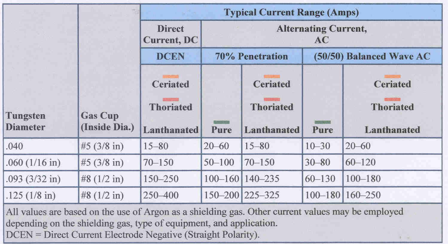

    ordered pt250ex to rework my bowfishing rig lots of .125 aluminum.. I am ok with a MIG, but TIG is new to me. Watched Jody videos and start off with 11 gauage aluminum looks like the way to go. Then I read over here that I should start out with mild steel. Which should I start with?
    Then I was going to order some filler rod and parts. Does the filler rod have to match the tungsten size?
    How do you pick the right size tungsten and filler rod?

    I select the tungsten dia. For the amount of amps I'm using. Anymore I just use Ceriated, (orange) for all my Tig welding, (with inverter).
    I select the filler size for the size of weld I want to make. Tungsten size has a lot to do with how big the weld will be also.
Name:	Tungsten heat range 2.jpg

    I would definitely start with steel and stay on it until you are real comfortable with tig welding, then go to al..
    To start, get three 6" square pieces (coupons) of 1/4" mild steel and run beads on them until they look good. Let one cool, weld the next and so on. Scribe lines on the coupons 1/2" inch apart and try to follow the lines with your weldbeads. When all the lines are filled up go back and put nice straight beads in between.
