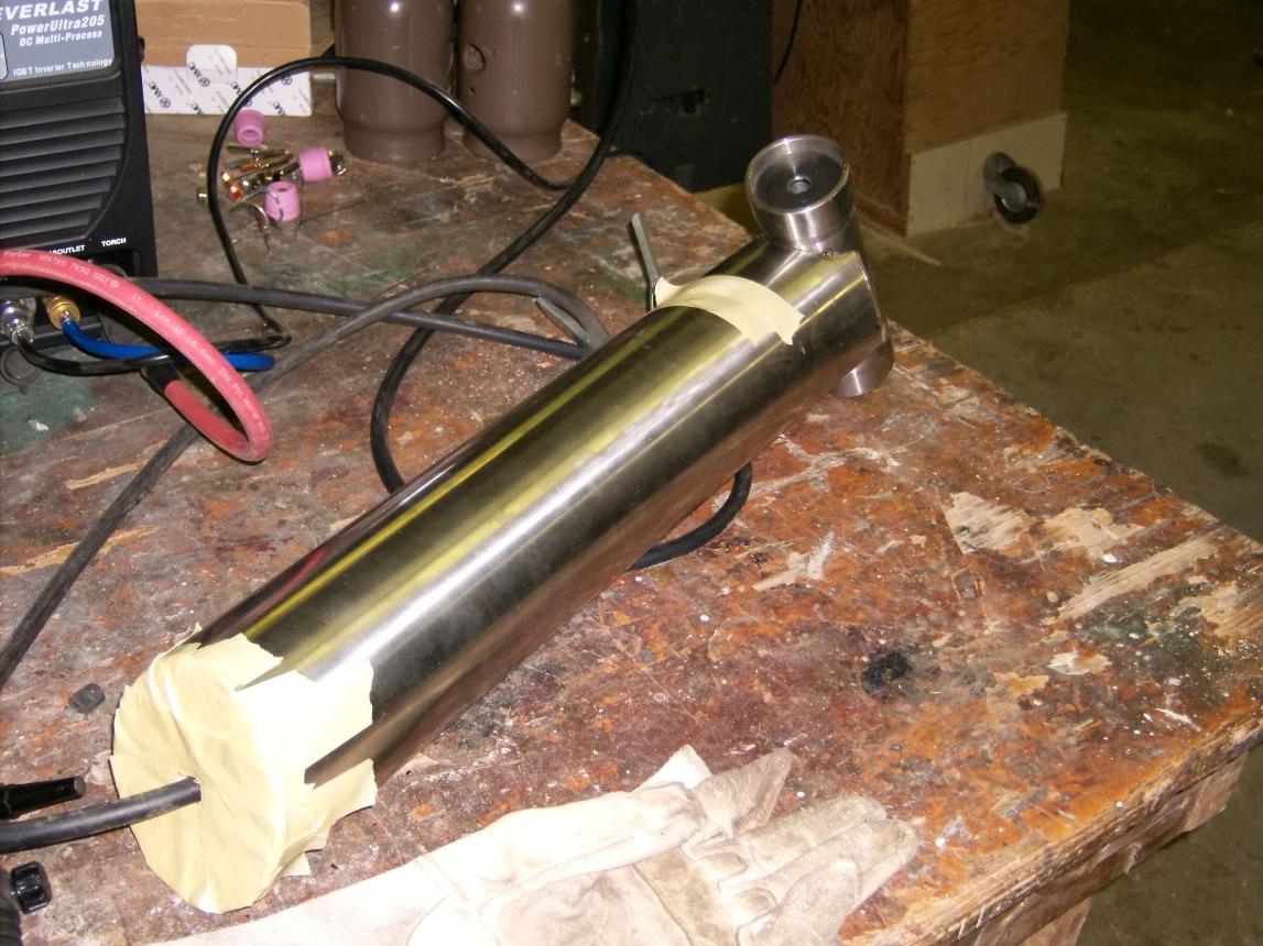

    Fritz Egli is a Swiss frame builder. In the late 1960s he took the most powerful motorcycle engine available at that time, the 1000cc Vincent V twin from the 1946-1955 and put it into a frame of his own design. He made about 70 of these Egli-Vincents before moving on to build custom frames for all of the major Japanese brands as well as race car frames.
    Today the Egli-Vincents are a collector bike and a number of bike builders have built replicas.
    I'm doing likewise, although my frame strays a bit from the original Egli.
    I'm using SS 316 tubing, all .065 wall except the steering head and swing arm pivot tube.
    Starting point was to machine up a steering tube to fit the bearings and stem for the front end I'm using (2003 GSXR 750) and cut appropriate shapes into the top spine (4" o.d. tube about 18" long) which is also the oil tank.
    All welds and some cuts are done with an Everlast 205 multifunction.

    Here is the spine all welded up (tig) The purge worked well, back side of weld is silver.

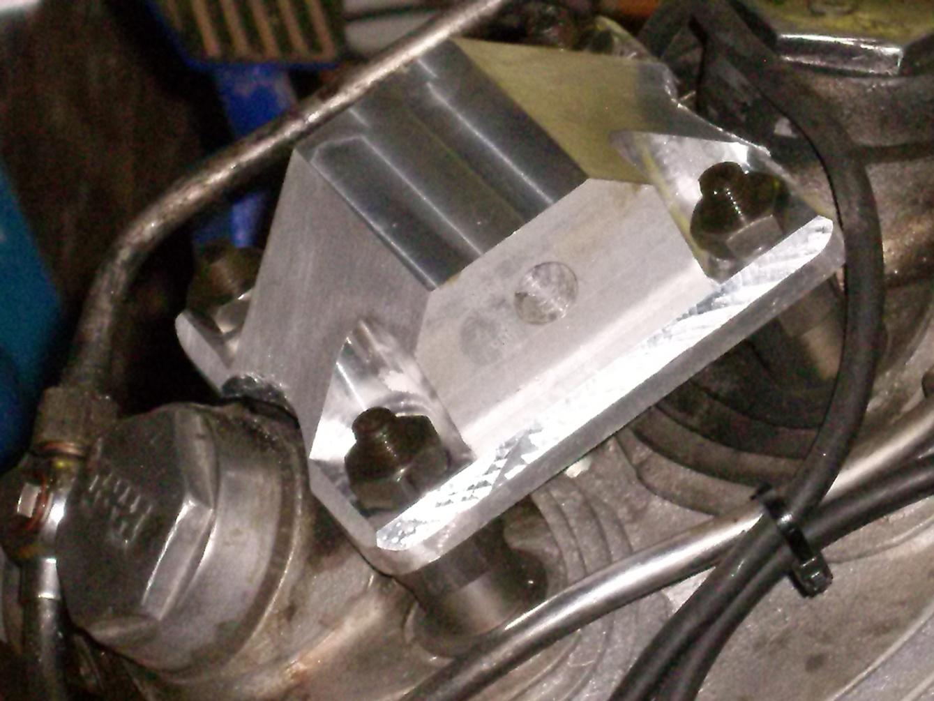

    I had to make some special head brackets from billet aluminum. The Vincent was the first bike to use the engine as a stressed member of the frame. The engine just hangs from the top spine by the head brackets, there is no lower frame or cradle. Egli followed the original Vincent quite closely with his design but lightened things up some.
    The originals were in cast iron, so these aluminum brackets will shave about 4 pounds off and shift the engine 1.25" to the right so that the chain should line up when using a much wider than stock rear wheel.

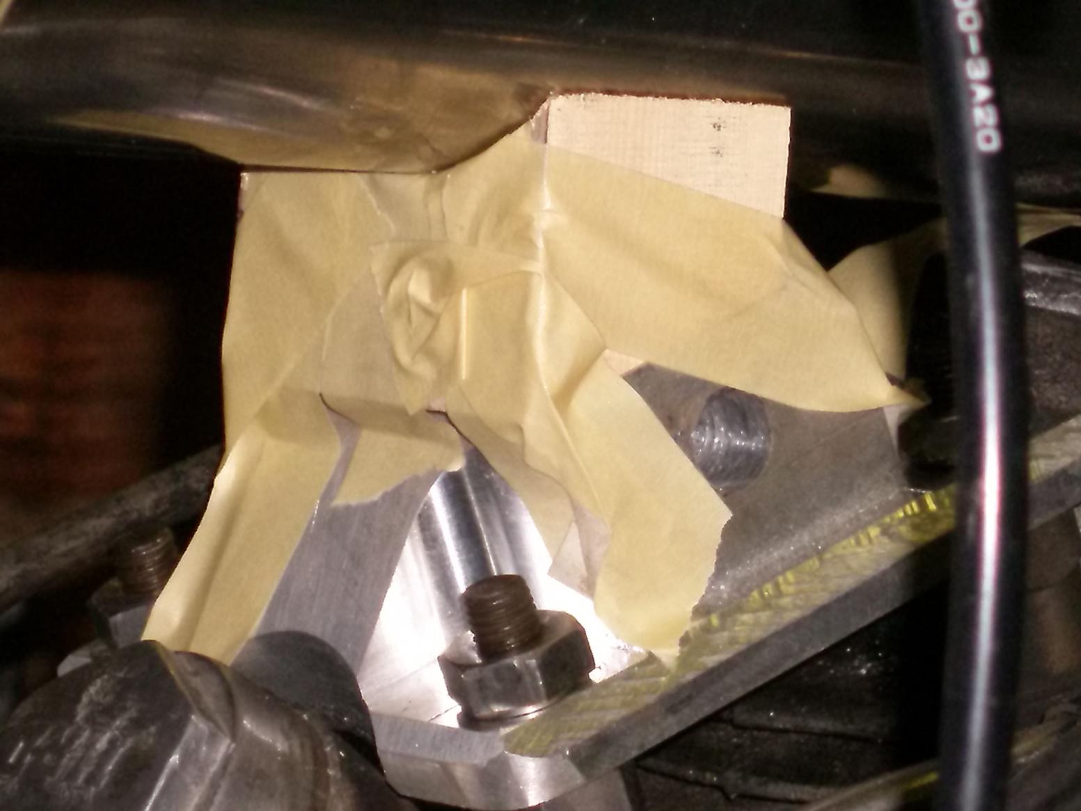

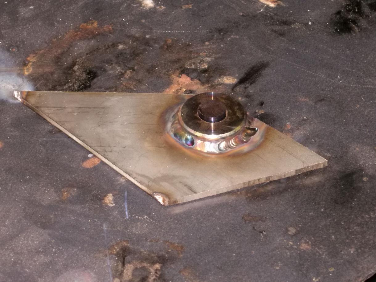

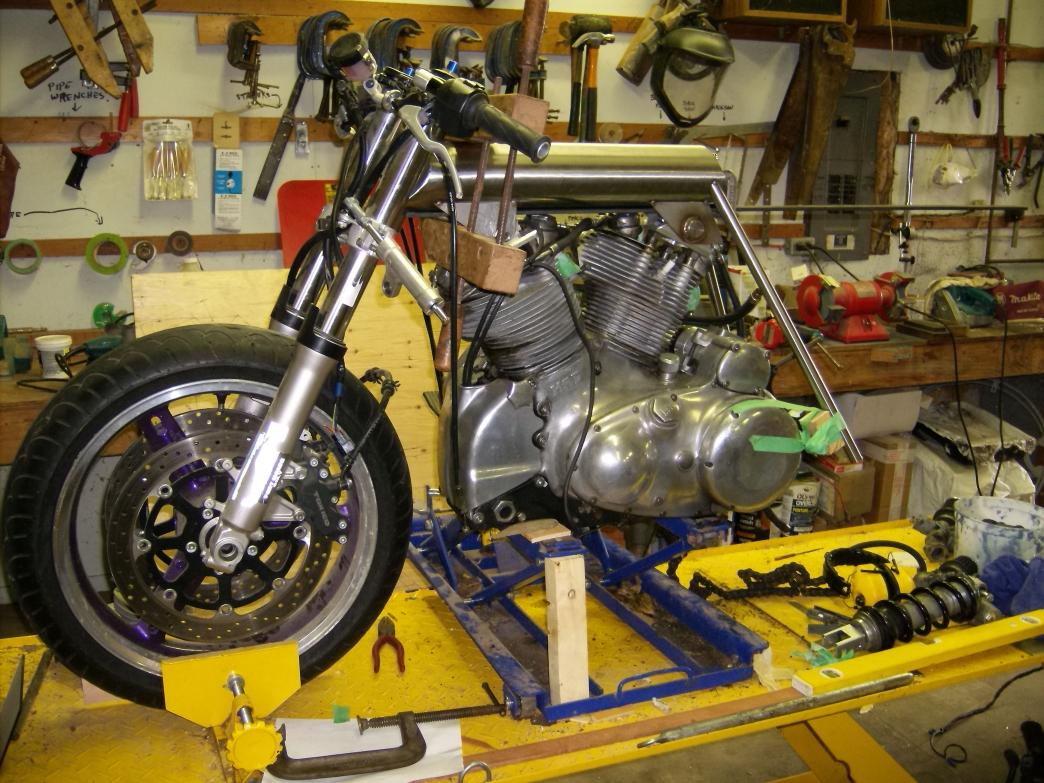

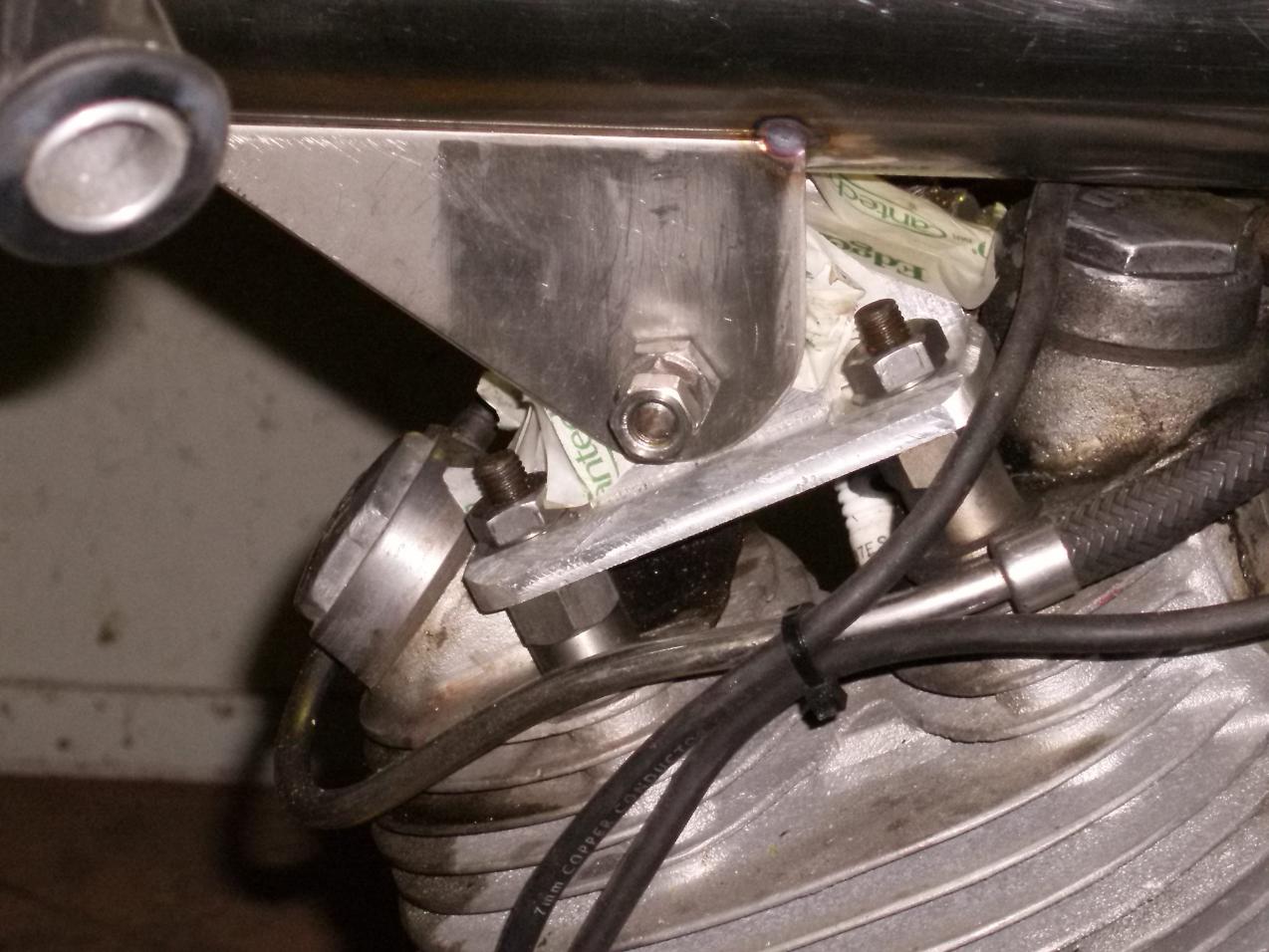

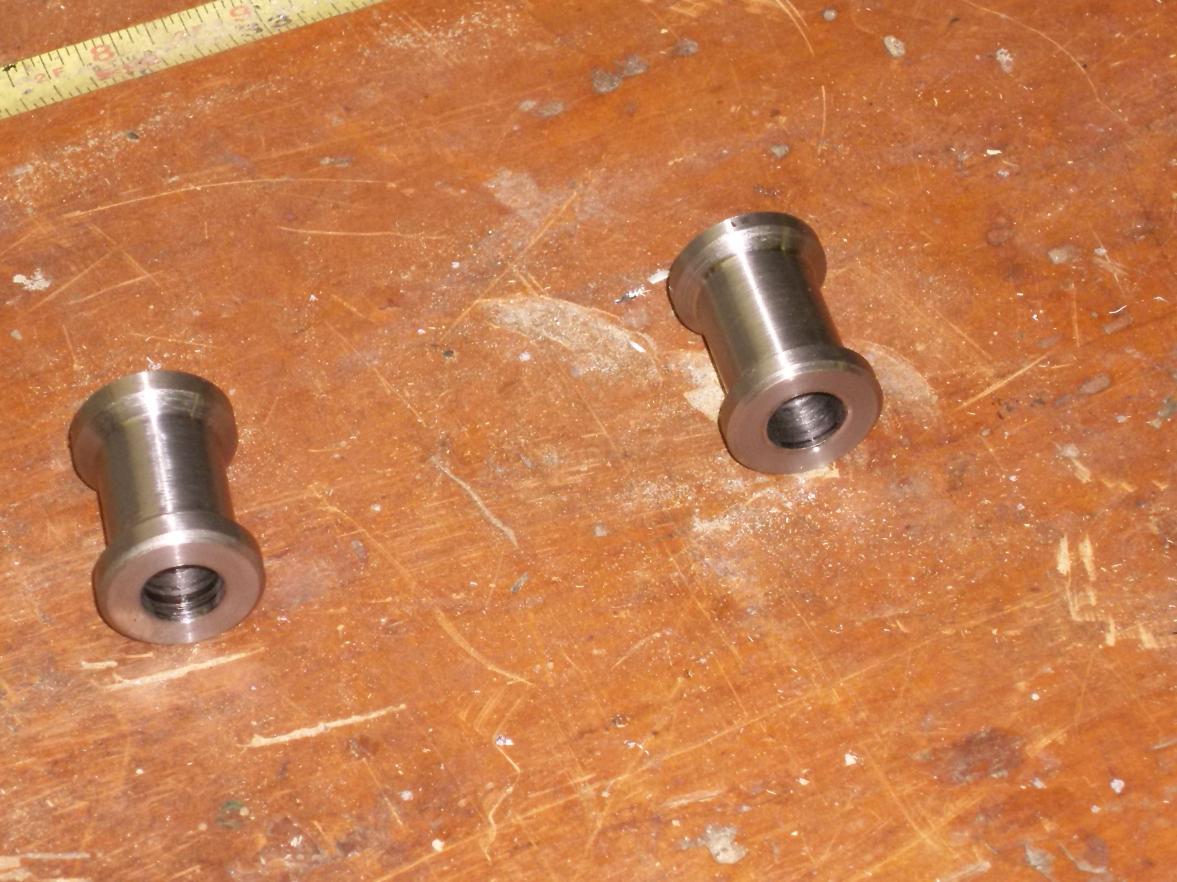

    I got a bit further with the bike this week and also had an interesting repair job come in.
    The first picture shows the item I'm repairing. It's part of a large bakery machine and is made of cast iron, so I'll stick weld it with nirod. It'll need preheat and post heat to be a successful repair.
    The second photo shows a couple of SS "thread spools" I made on the lathe. Thesec will get welded into half circle notches that will get cut into the lower rear frame tubes. The spools will take the rear lower engine mount bolt (next set of photos will probably show that area)
    The third picture shows the front engine mount tang made and tacked in place.

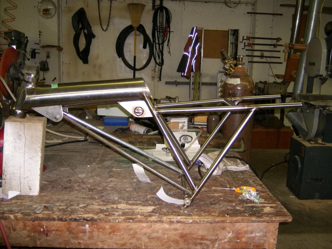

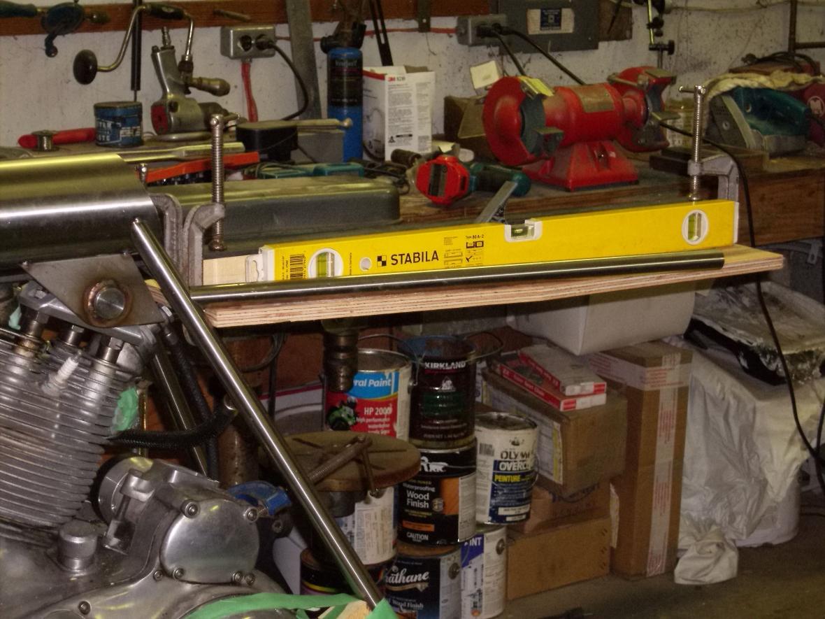

    progress report:
    pic 1 is the rear top engine mount tang. There will be one of these welded to each side of the top spine or oil tank. A bolt goes through these and the head bracket to make the rear top engine to frame connection. The hole in the tang gets slotted because the Vincent engine expands when it gets hot. For this reason the through bolt gets fully tightened then backed off 1/4 turn (lock nutted). I thickened it up in the area of the bolt hole because that is the way an original Vincent looks in this area, even though most Egli builds didn't bother with that detail.
    pic 2 shows the start of fitting the 7/8" od x .065 wall tubing that forms the rear part of the frame.
    pic 3 shows a bit of wooden jigging that will hold the seat rails in place.
    pic 4 shows the fit of the coped out tubing. I did the cope cuts on the milling machine by measuring the angle with a carpenters bevel square, setting that angle on the mill, then making the cut using a 7/8" dia. hole saw and lots of coolant.
    Glen

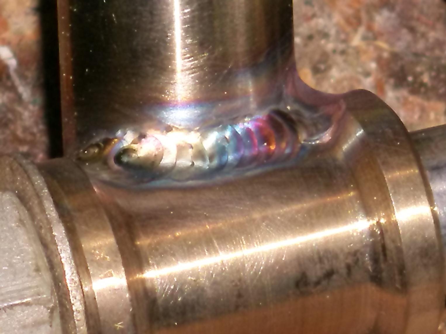

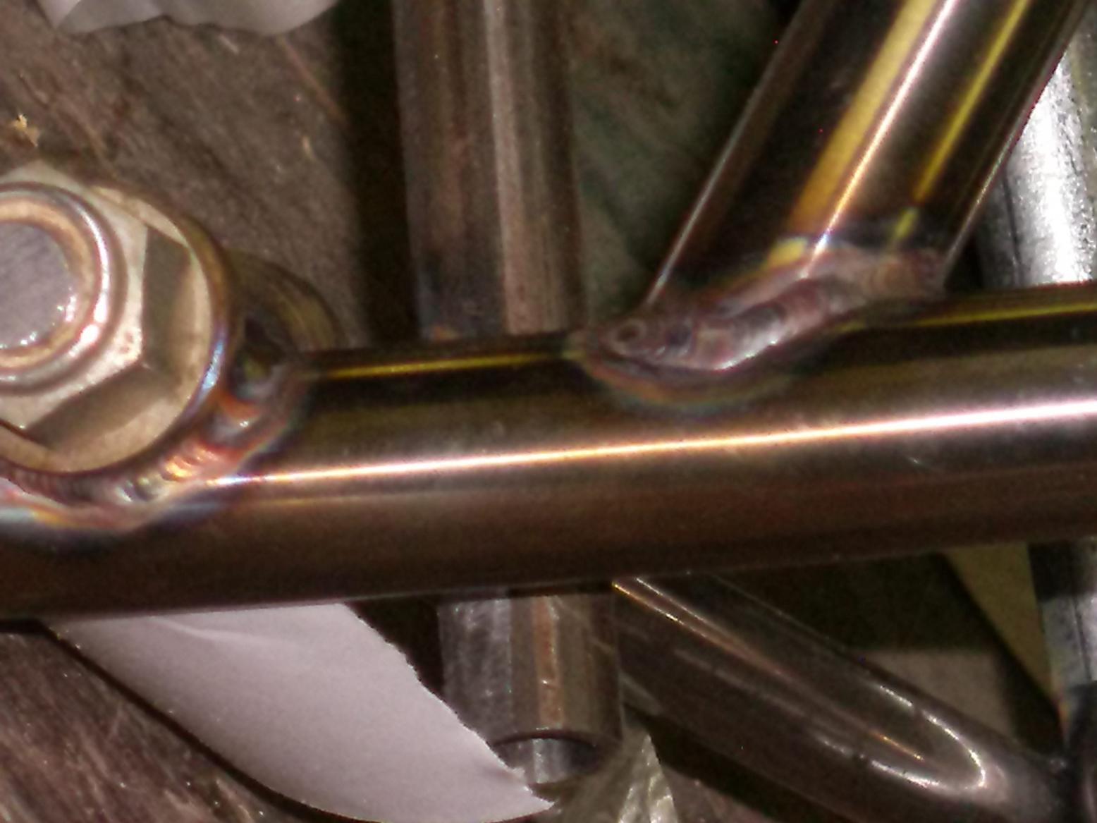

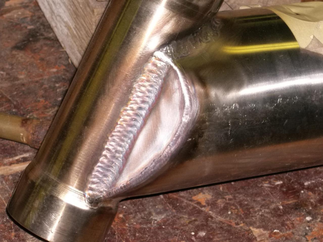

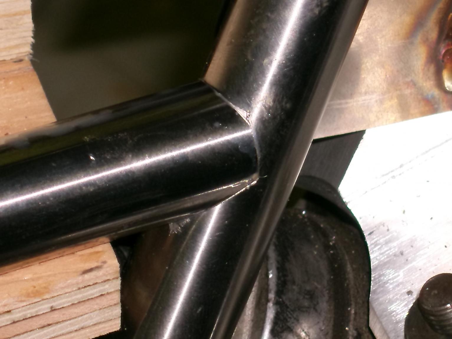

    I finished fitting the small dia. thin wall tubing and then removed the frame from the engine for final welding. There is a temporary brace fitted where the engine sits. This should keep dimensions correct.
    The small tubing is 7/8" OD .060 wall. I found it challenging to weld the saddle joints neatly. Good thing the fits were OK or it would have gone badly, I'm sure!
    Glen

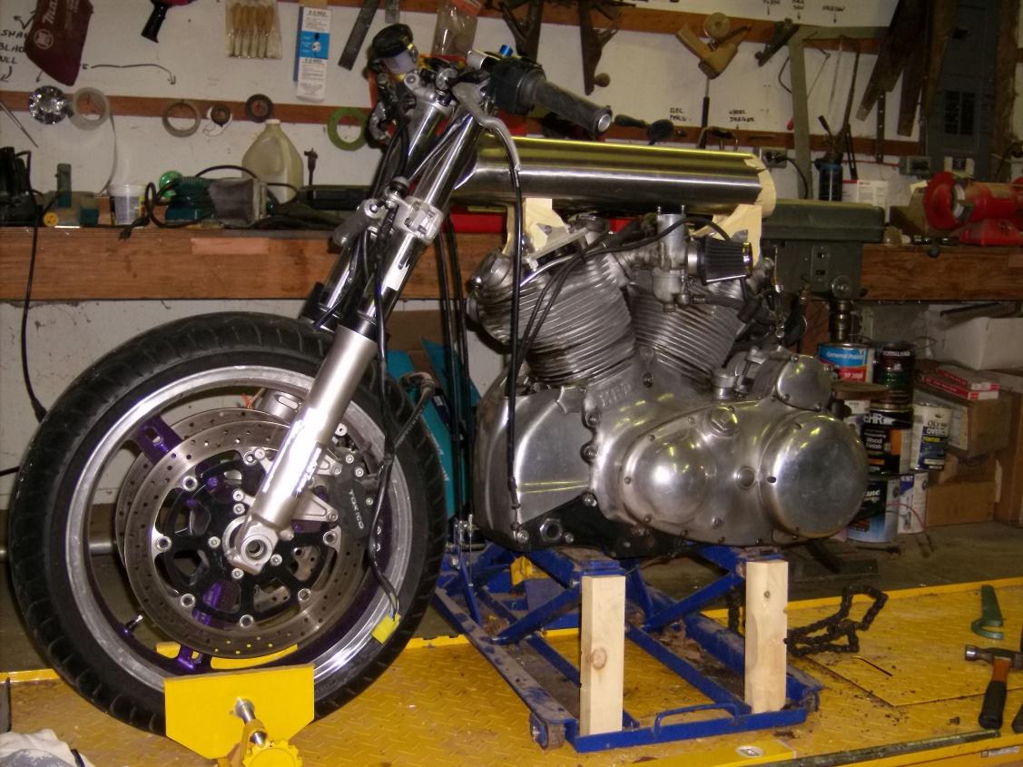

    I finished the welds on the forward portion of the frame and reinstalled it on the engine.
    I think of it that way because the Vincent engine is actually a stressed member of the frame, it's crankcase does the job most double cradle frame lower portions do.
    Now it's time to figure out the rear frame member and suspension geometry. I threw together a wooden disc , axle and temporary swing arm made of some rusty old tubing.
    I know what I want the wheelbase to be, so that means the swing arm length is a fixed number. The location of the shock pivot points at top and bottom are completely variable so I'm in for several hours of trial and error.
    I'm searching for the right combo that gives 5.5" of rear wheel travel in a progressive manner, that is, I want the wheel to lose mechanical advantage over the shock as the suspension is compressed.
