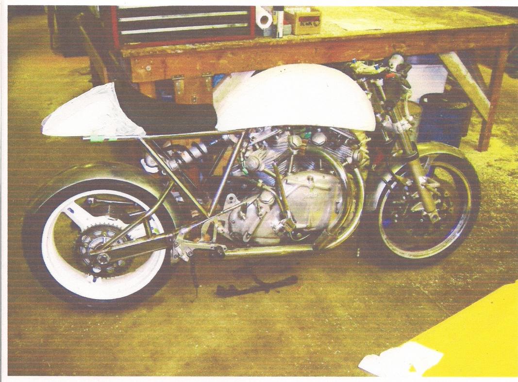

  3. #63
    I printed off a photo then sketched in the shape of the rear cowl in whiteout. After that the print got scanned and save so I guess the quality diminished some with each step/
    You get the idea tho!

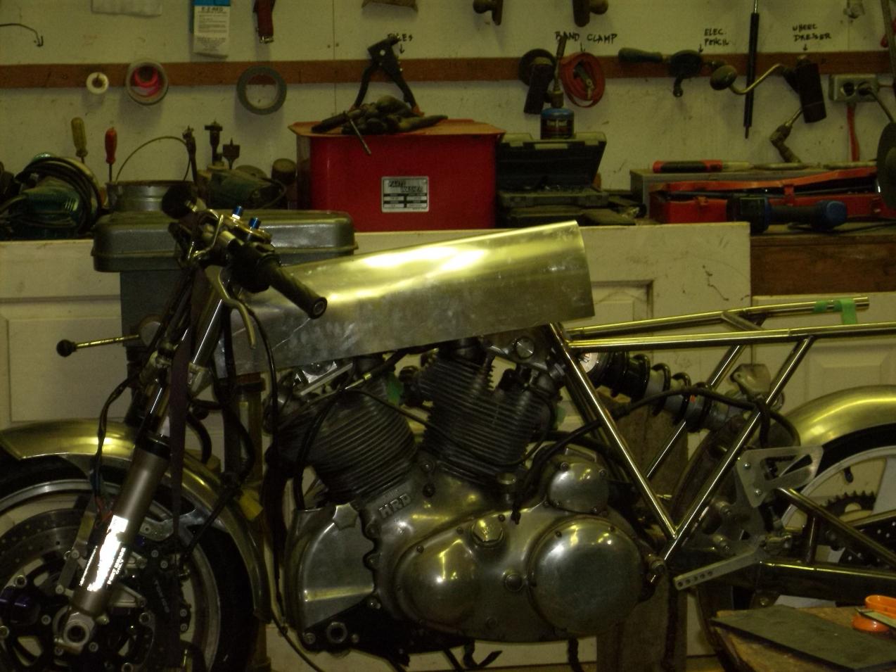

  7. #67

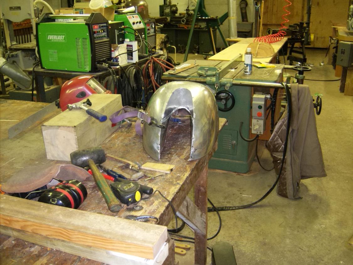

    So I started back in on this project about mid winter. First off I made up a pattern or a "buck" for the rear cowl and seat pan.
    I wanted the tank/seat and cowl lines to flow together like one smooth piece rather than tank/stop seat/stop/ cowl as it sometimes is if using store bought parts, or on lots of production bikes.

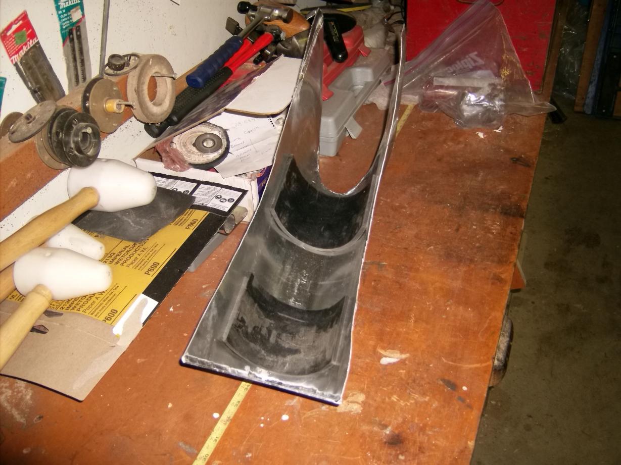

  8. #68
    After some hammering and some planishing on the ewheel I had two of the three pieces needed for the cowl roughed out-

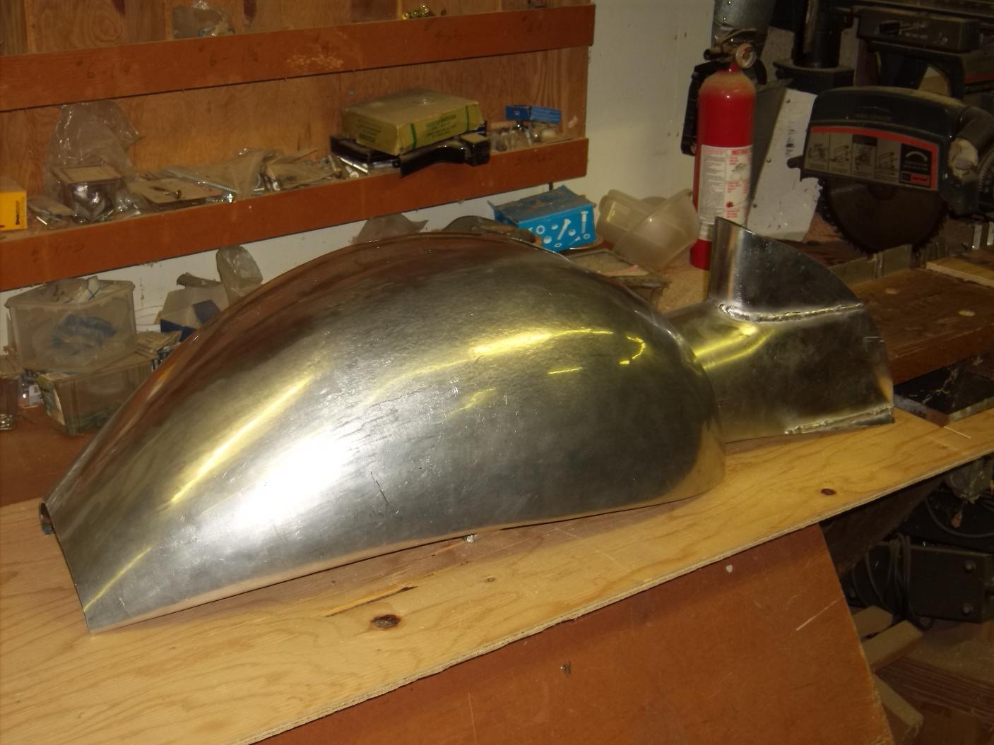

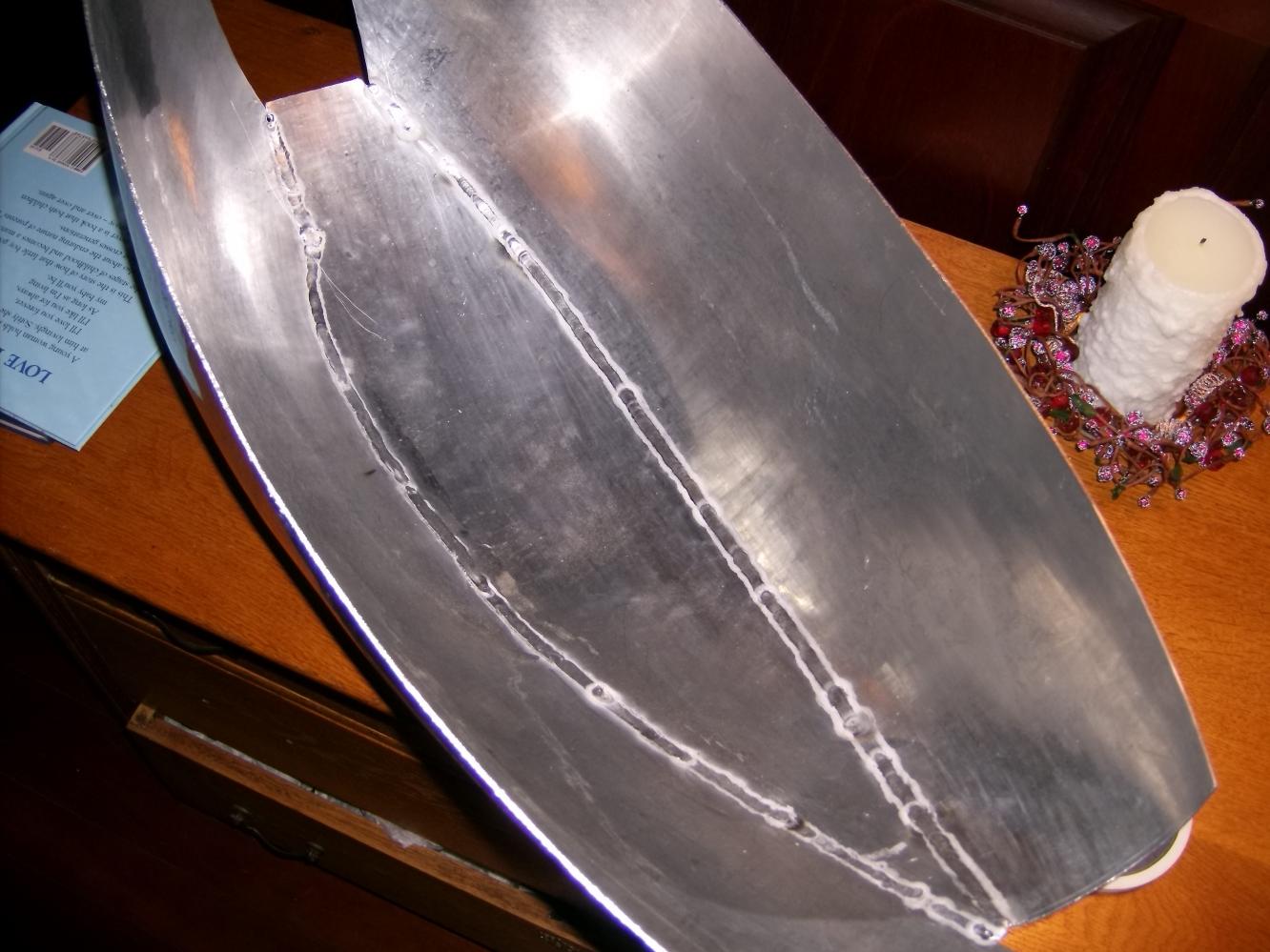

    all three pieces made and welded together. Material is just .050 thick 5052 aluminum, was a real challenge for me to weld. But I have a great machine (PP256) for that so it turned out fine.

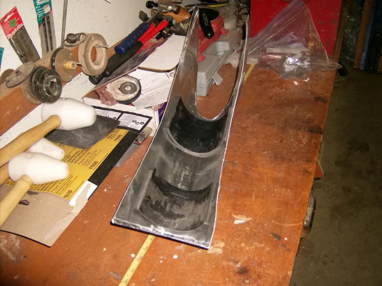

  10. #70
    Finished product after smoothing the welds, more planishing in the ewheel and about half way thru the polishing process.
    I ran over the welds on the inside but only for fusion, no filler rod used. This way once I had mostly smoothed down the top side of the welds I could put the piece back into the ewheel and run right across the welded areas.

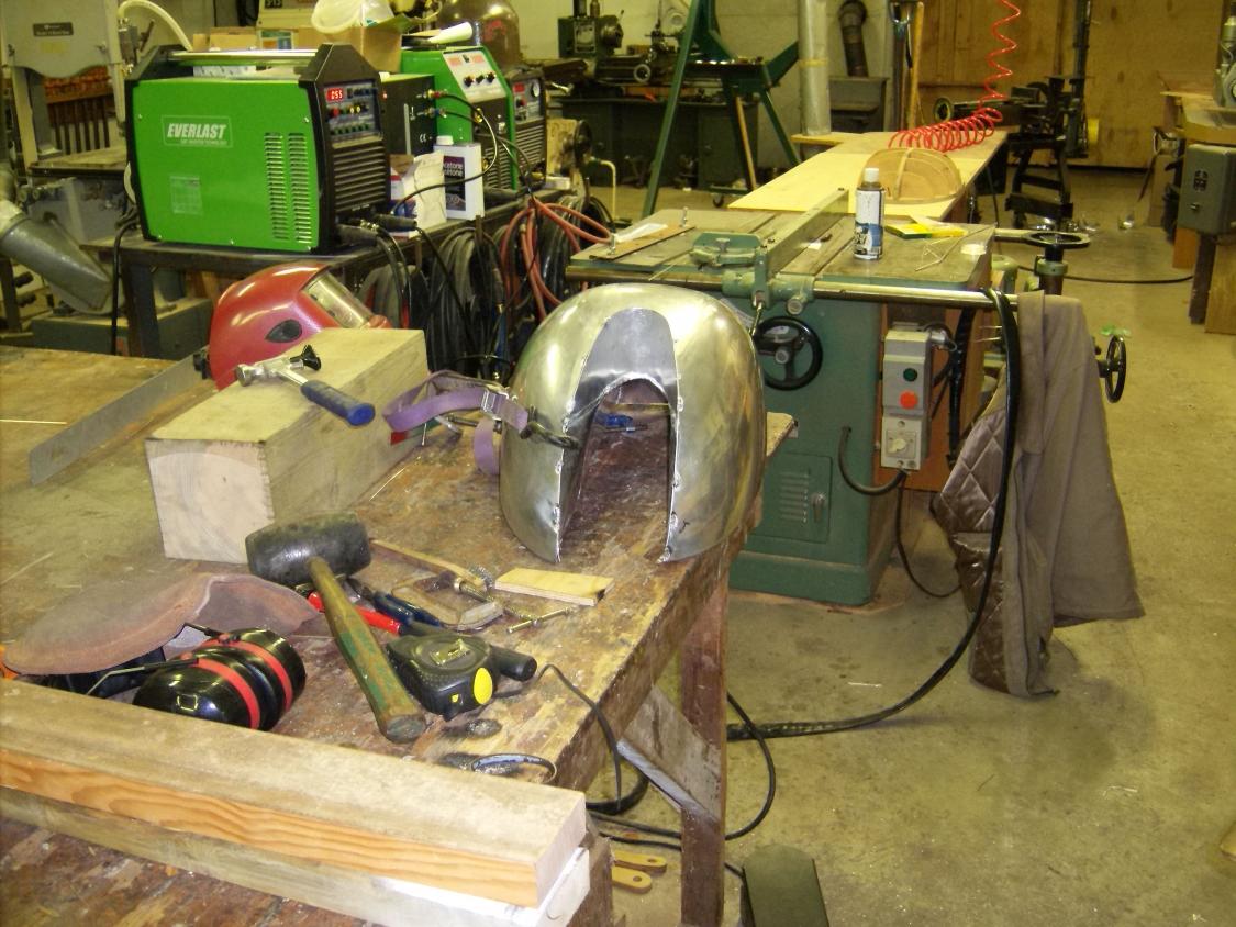

  11. #71
ID:	6695Click image for larger version.
ID:	6696Click image for larger version.

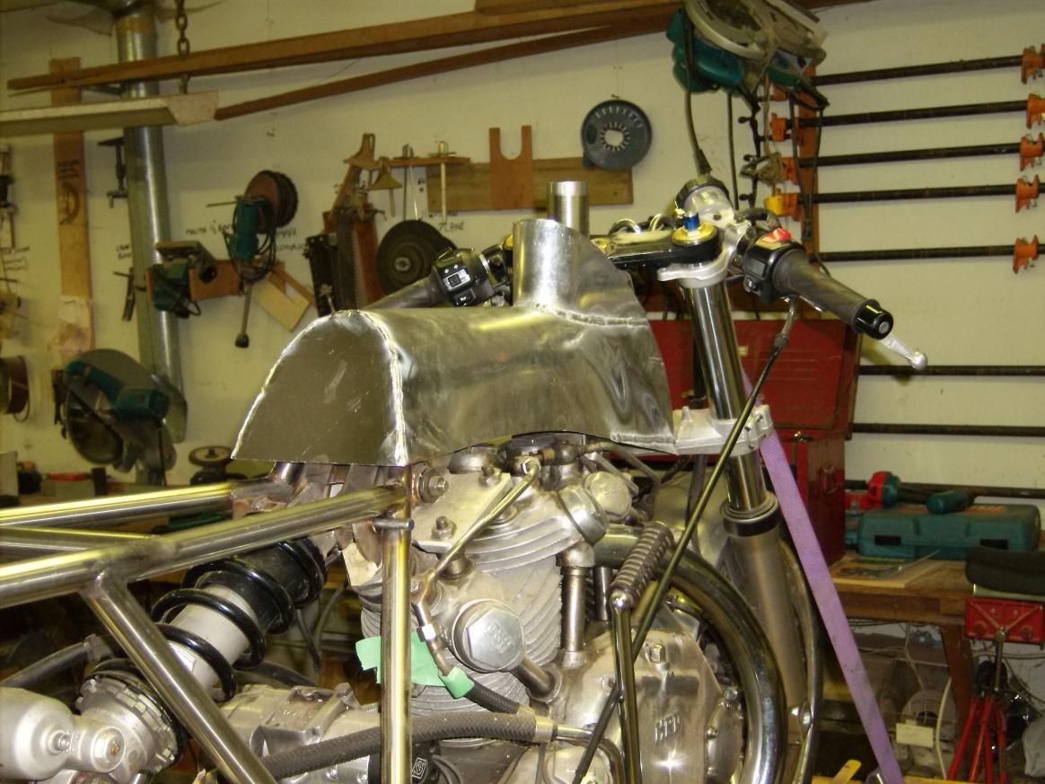

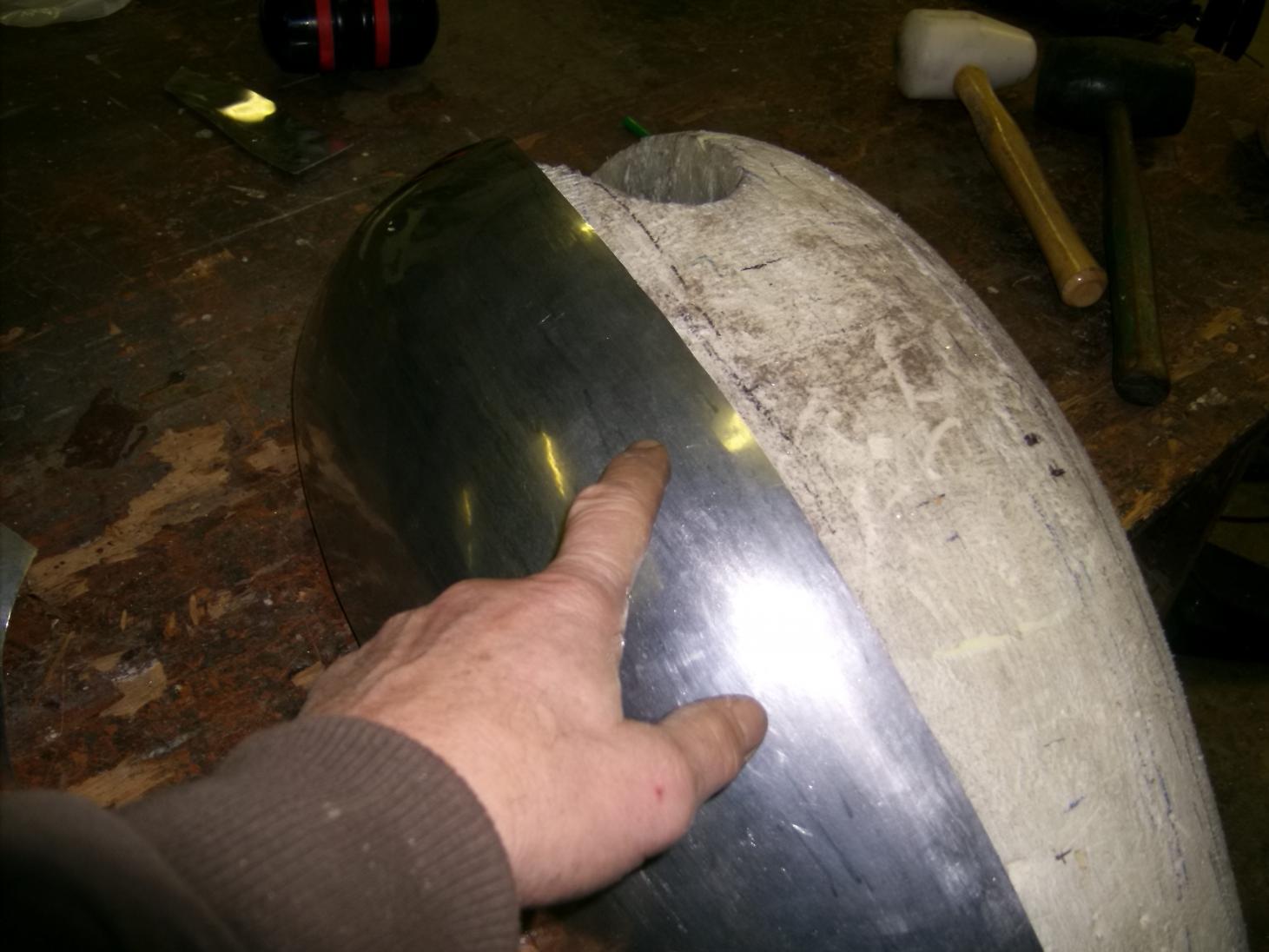

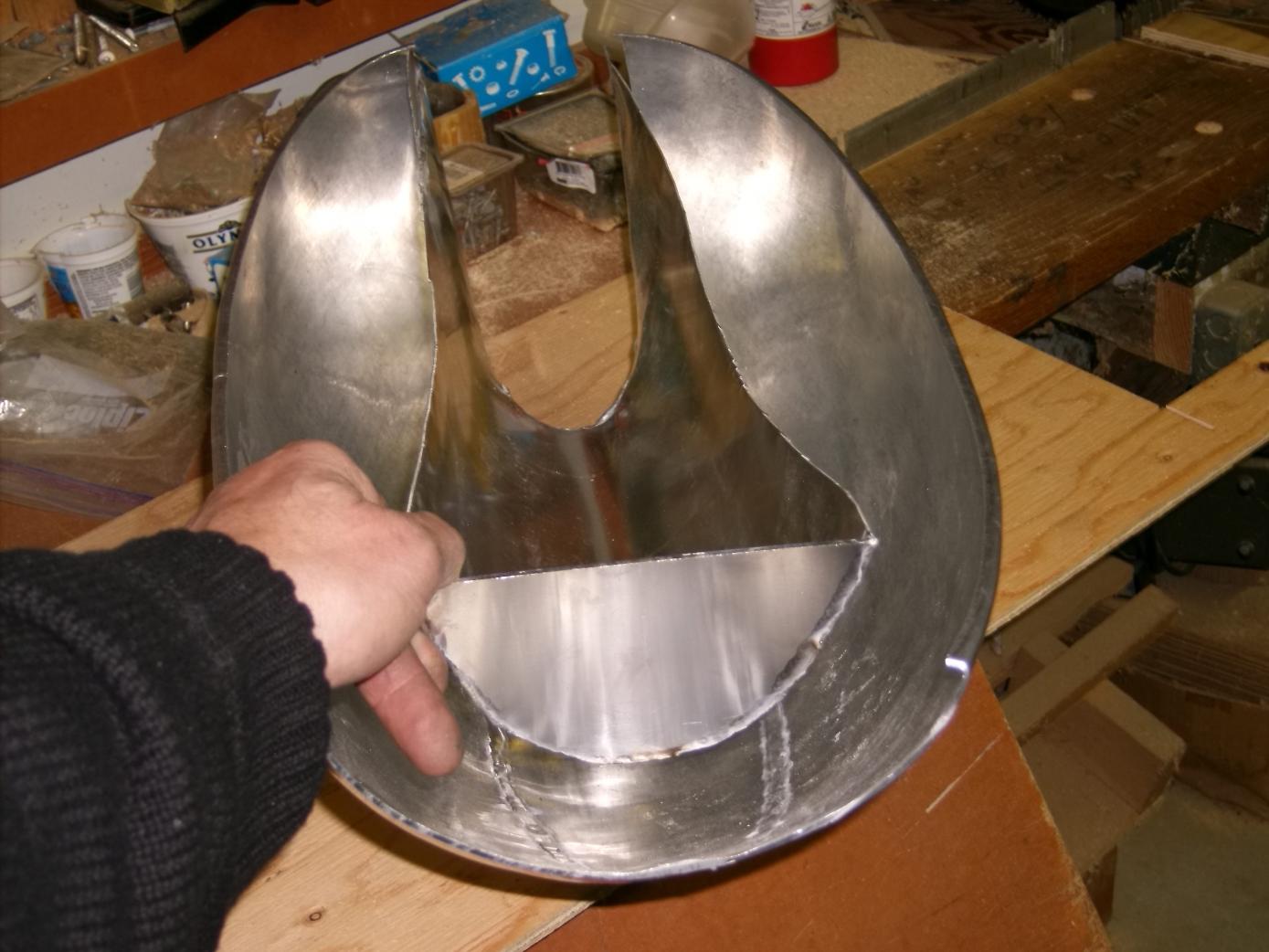

ID:	6697Next up was the gas tank. I made this from .063 3000 series Aluminum.
