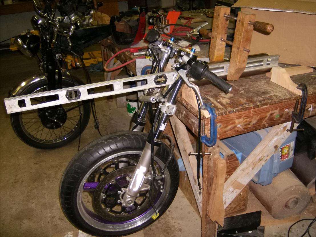

    The spine or upper frame member fits onto the GSXR front end like it was made for it!
    I guess it was made for it.
