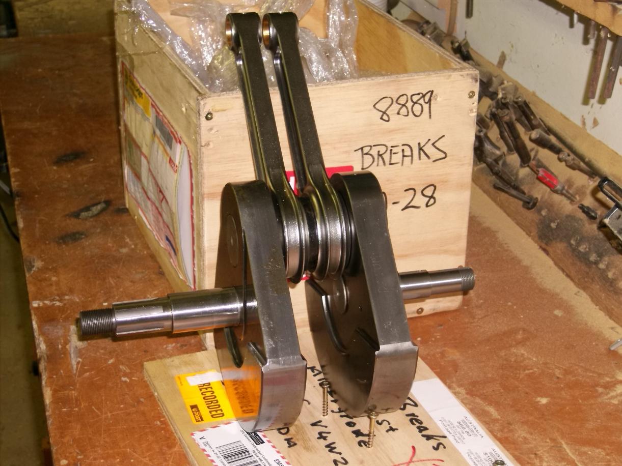

    Just to update this thread, there has been a little progress on the bike. I completed the left side rear set (listed as a project)
    Also, I received the special order Stroker race crank for my 1360CC engine that will eventually go in the bike. This was made for me by Terry Prince from Australia. If you have seen the movie "world's Fastest Indian" and know who the main character, Bert Munro is, then you will understand when I say Terry is a modern day Bert Munro.
    Terry runs a Vincent rather than an Indian. This is a bike he bought at age 18 and has used extensively for touring. A couple of years ago he decided to modify it for land speed record runs. He set one in sidecar class last summer at Bonneville.
    The crank he made me is the same as the one in his Bonneville bike. It's a real thing of beauty, oversized mainshafts, oversized crankpin and Bobweight flywheels.
    I might keep it out where I can admire it for awhile. It will be some time before the funds are available to purchase crankcases to house it in anyway!
