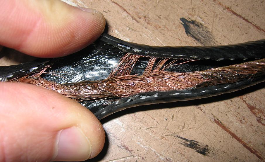

    Slip the handle off the torch head, and you will see connectors under the handle where the cables connect with the torch head. Just get a replacement torch head that matches the connectors on your cables, and the torch head should be a direct swap.
    Be careful not to exceed the current carrying capability of your leads, or you can melt the insulation. (Which is really bad news; see pic for a one-piece aircooled hose that got melted from exceeding the cable's current&duty cycle.)
    Weldcraft shows the same part numbers for the gas, water, and power hoses of the WP-24W as they show for the WP-20, so you should be able to swap a WP-20 torch head onto those WP-24 cables.
