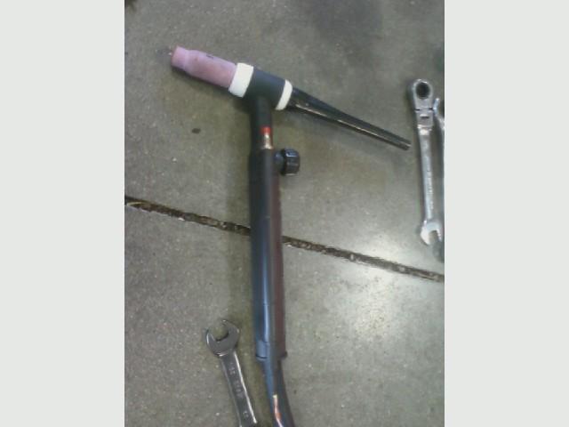

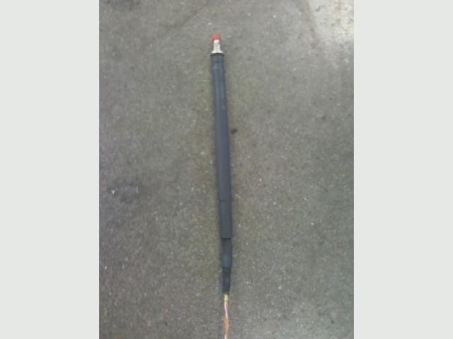

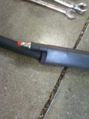

    Hey guys. A while back I picked up a 17-v air cooled torch from HF on clearance for $1.47. Sweet torch, very maneuverable. It has a gas valve on it but no switch. My foot pedal is on the fritz so I improvised a switch out of stuff around the shop and it's actually one project I feel good enough about to share with you guys. The switch itself came in some packaging for under car neon style lighting that I installed for a customer. the switch is a momentary on/off that is part of the packaging so you can see the neons light in the store before you buy. It is intended to be disposed of with the packaging. The housing for it is a bic pen. Just a plain jane cheap plastic pen. the wires are two strands of the wire that is in a cat 5 ethernet cable. It is solid wire. The female pin receptacles were a little more tricky. I found some that fit our machines in a connector for an old school ford heated oxygen sensor. A little solder, a bit of heat shrink and viola! I have tested the switch in 2t and 4t mode and it works like a charm. as you can see from the pics it is attached to the handle only so it can be rotated to any position that is comfortable for me. The wires add practically no weight and no rigidity to the torch cable, I cannot tell it is there. check out the pics... It probably wouldnt be ideal for someone who has been using the typical thumbswitch for 20 years, but I found that its really comfortable. when I was testing it I rotated the handle so it was positioned right under my middle finger and felt really natural. just about the same as using the index to operate the "thumbswitch". best of all, It was made with stuff I had on hand. swahili for FREE!!!!. let me know what you guys think. when I go back on monday I need to figure out a way to stabilize the female pin receptacles tha tplug into the machine. Sort of make a connector. Any ideas?

    That is a good idea. The fact is, that any spring loaded momentary switch should work.
    looks very resourceful, works for you. I think it would take some getting used to. Any reason why you went this way instead of a paddle button, heck even a door bell button? I'd think this would be tough with gloves on? Just asking, not bashing.
    I really enjoy the torch switch on the monster factory torch provided with the 225LX. I am often told I'm limiting my controlability by not using the foot pedal though. I've considered the smaller CK torch and others but I'm unwilling to give up the integrated switch. I like your idea, it seems very innovative and compact. Personally It looks better than some of the factory switch add on offerings. I see a bit of an issue with hand position for my personal use though. It is pretty darn kewl for an off the cuff design! You get an A+!

    Nope. The only reason I went with this setup instead of another type of switch is because I needed to weld something right away and the foot pedal wasn't an option. My gears turned for about five seconds before I decided I was going to make a switch and out of the Items I had on hand this seemed like the better choice. I had a few different momentary switches but all of them seemed bulky once I housed the body of the switch in something and then mounted it on the torch. I didnt want to do anything invasive to the handle of the torch in case I didnt like it or had to change it for any reason. But it has worked well so far. I have been using it all week. If I am welding upright, I rotate the handle so the switch is in front under my index finger. For flats I turn it around to about the three oclock position so it sits under my middle finger. Necessity was the mother.

    I like the switch, it seems that being in a different plane than most contact switches on torches that it would come in handy on some weld setups. It seems that it's more like squeezing a trigger than the usual button press on the side of the "pencil."
    Nice work.
