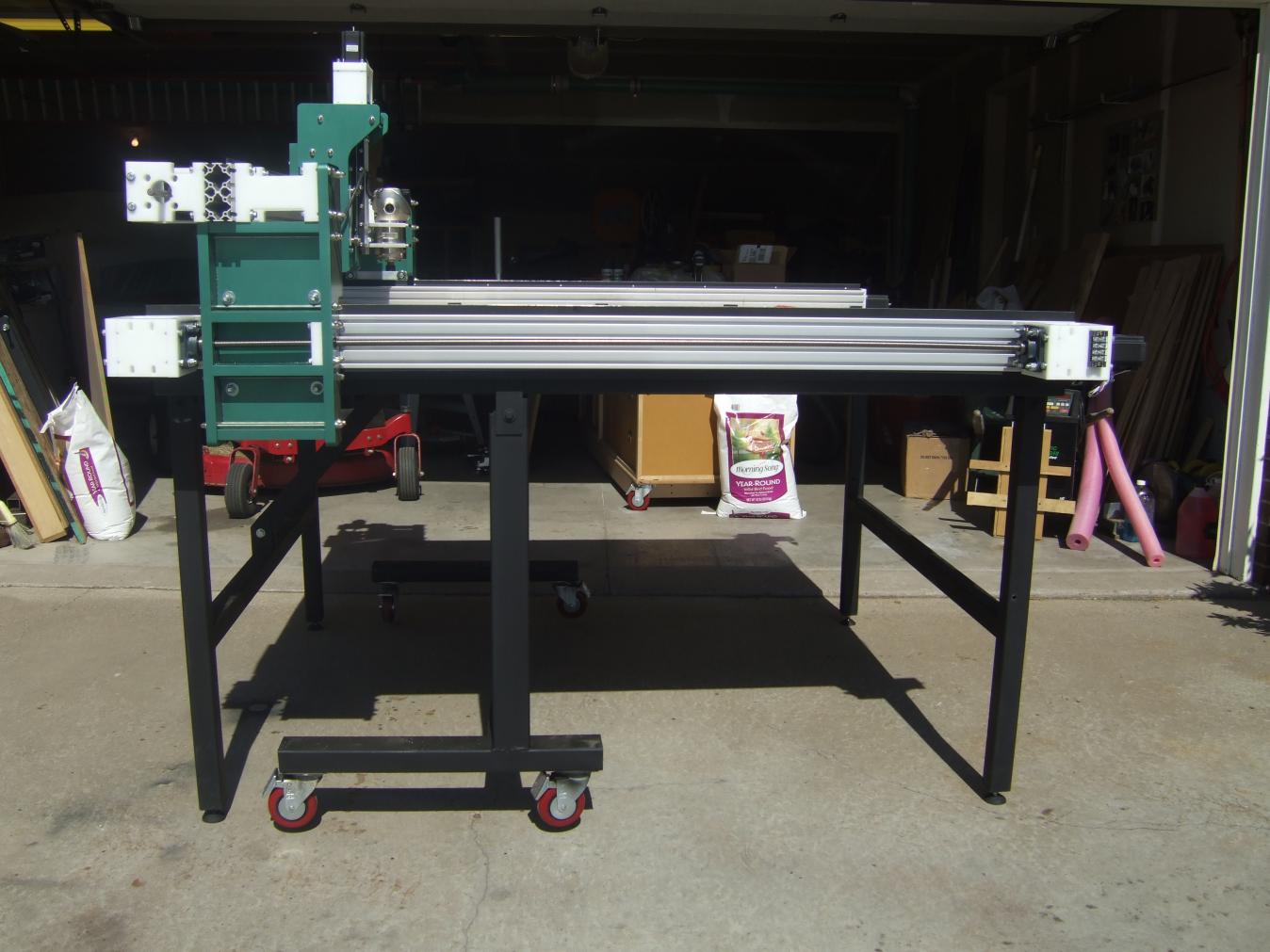

    Well I had posted a thread about making a CNC plasma cutter before the forum went cablooie so I thought I would re-start a dedicated thread for Plasma CNC.
    So I have a metal table CNC router that I built a few years back and has a cutting dimension of approx 25" x 49" tops and that is pushing the limit switches doing that big of a cut, And I use 3 pieces of .750 MDF for a spoilboard that is just laying in the framework so I am going to be getting a plasma cutter when the next shipment comes in and going with the Power Plasma 50 because it does not have the HF start so I can hopefully eliminate any type of HF interference with my servo controllers.
    Has anyone else experimented with building a CNC plasma?
    I am concidering building a dedicated Plasma so I dont have to re-set the machines from metal to wood between processes.
    SO I am open to any and all info that is out there if people are working with them.
    So far My set-up is 3 gecko 320 servo controllers and a 72 volt DC non regulated power supply,, and I am running it with a smoothstepper USB control .
    Software is BobCad with Mach3 control software.

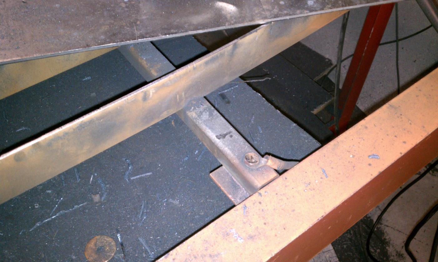

    I think I have pictures of the frame when I built it somewhere and it was back when I was using a Hobart Handler , now have the 250EX. That is another reason to re-build a frame as well.. Get to TIG the new one..Click image for larger version.

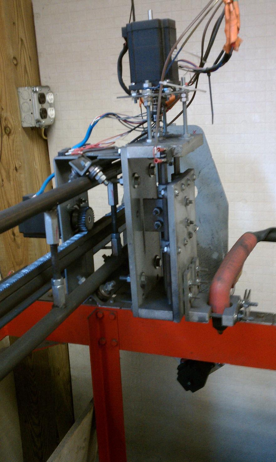

    About a year ago I finished my CNC plasma table with the Everlast PP50 non high-freq and it runs like a charm… normally. Every once in a blue moon after the cut, the post flow will fail to shut off and therefore it will not strike an arc on the next cut. I'll flip the post flow switch a couple times and it will shut off and I will have to back the machine up a couple steps. I typically run at 65psi with a desiccant air dryer. I can only run it off a 30amp breaker, so I can only get about 40amps out of the machine. I usually don't cut anything over 1/4", but have cut 3/8" from time to time and haven’t had much of a problem with bevel or piercing.
    The largest issue that I have is with mounting the torch. There's really no straight section on the S45 torch, so getting is perpendicular to the plate is an issue. If the torch isn’t perpendictular to the plate, you will be able to tell from the bevel it creates. I'm debating on buying an additional torch, ripping out the insides and making a machine type torch that I could easily mount perpendicular.
    The duty cycle of the machine seams good. I had a nest of parts on a 4'x4' sheet of 14 Ga. that ran about 35 minutes and didn’t have any problem with overheating. After each cut, I use about 1 second of post flow on plate less then 1/8”, and 4 seconds on plate up to ¼”. It keeps the torch rather cool. I haven’t yet had a large nest of 1/4" thick parts. I'm eager to see how she will run then.
    In the year so far that I've been using it, it hasn’t locked up my PC yet. I'm pretty well grounded though. Each axis has it's own grounding wire and each wire to my motors & limit switches are shielded, and the shielded braid of the wire is directly to the grounding rod about 10' away.
    Interface into the CNC was simple. Just unscrew the torch trigger wires from the front panel, and attach the ones from your on/off relay from your CNC control board.
    If I need to make scribe marks on what I'm cutting for assembly marks, I disconnect the ground clamp, turn the machine down to 20 amps, pierce & cut height at .35 and run it at 250ipm. It makes a slight dimple when the plasma first fires, but after that it leaves a nice line of heat to assemble by. It only makes a dimple because even though I have my pierce delay set to "0", the machine still delays a bit so it makes that little dimple.
    My machine is a home designed with 52"x84" cutting area.
    Any questions, feel free free to ask. I’ll try to get a couple pictures up in a couple days.

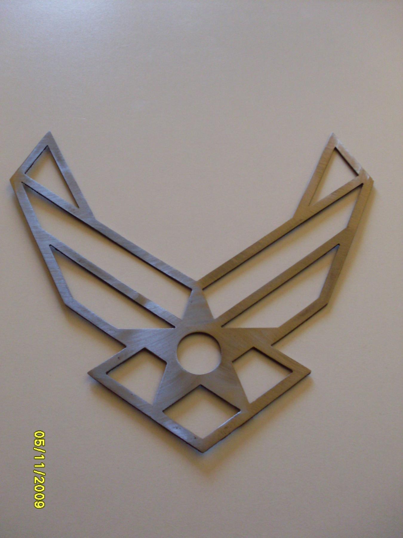

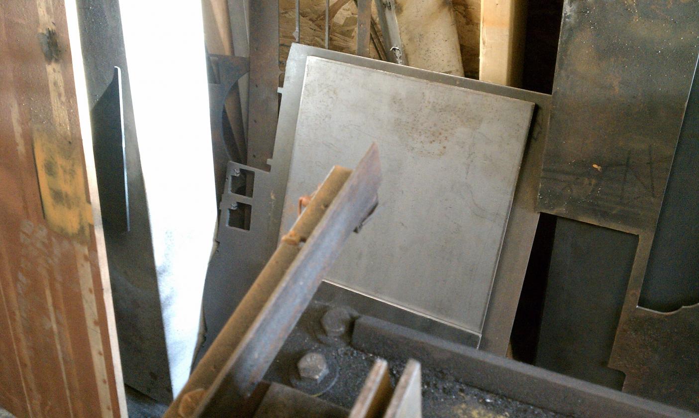

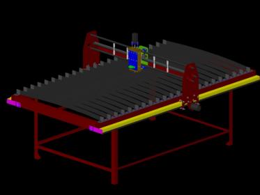

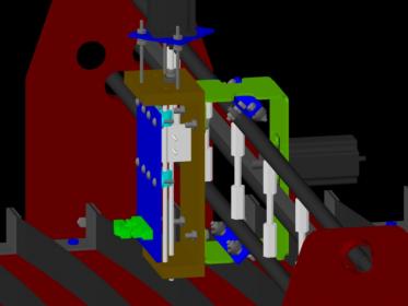

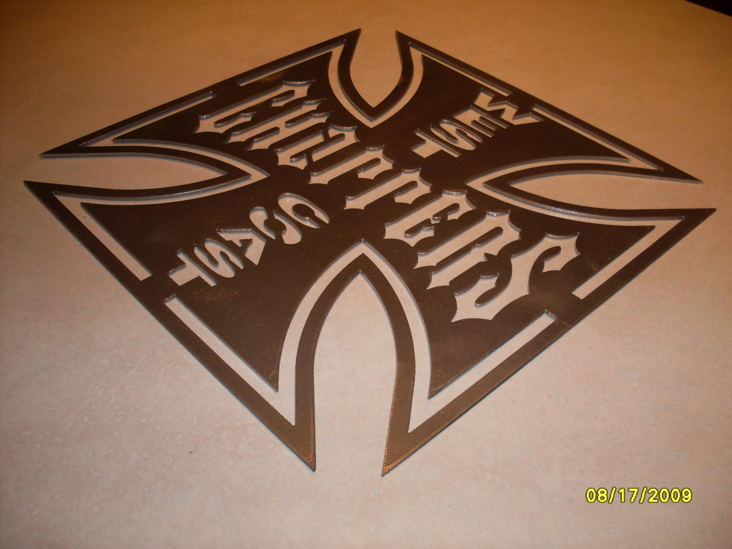

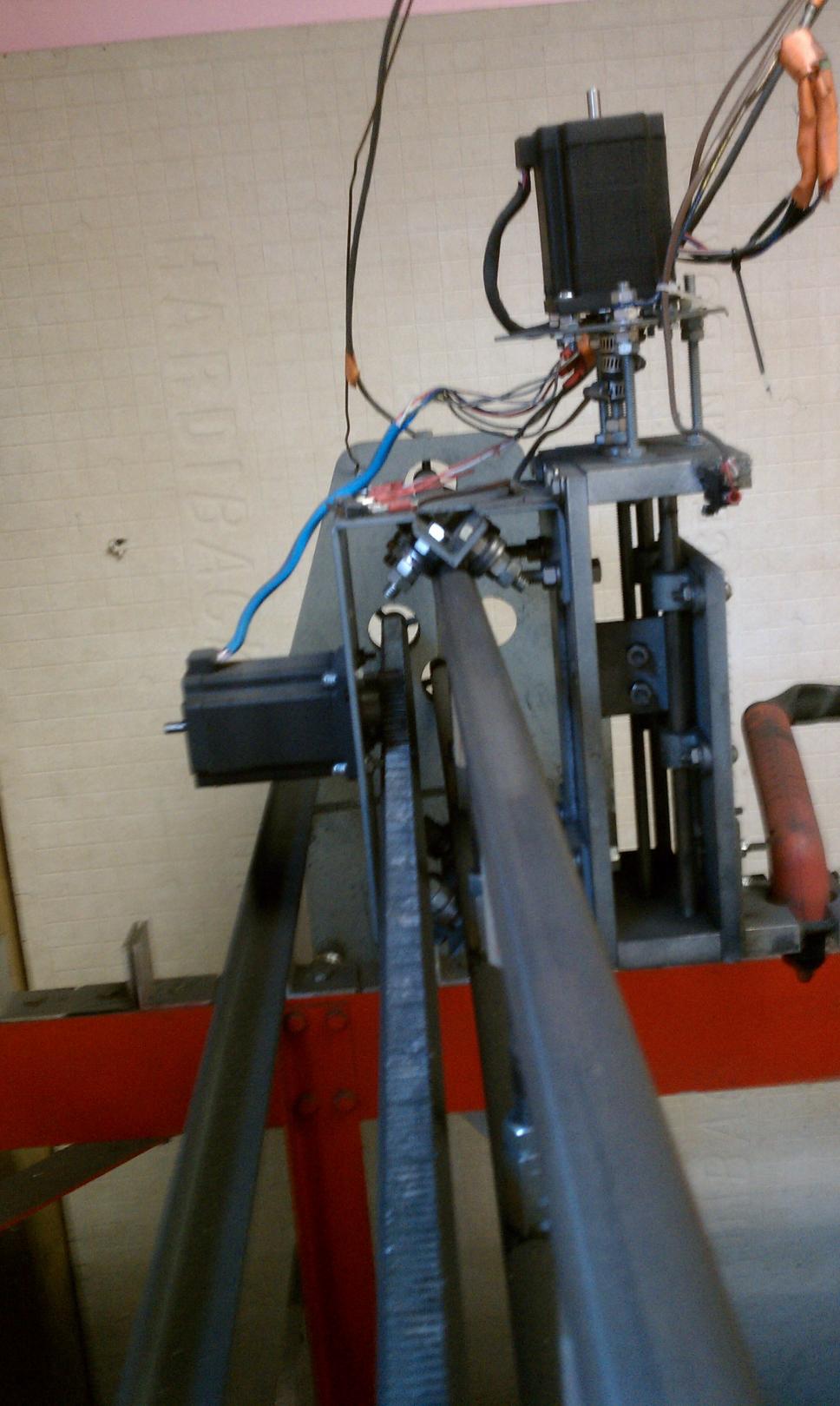

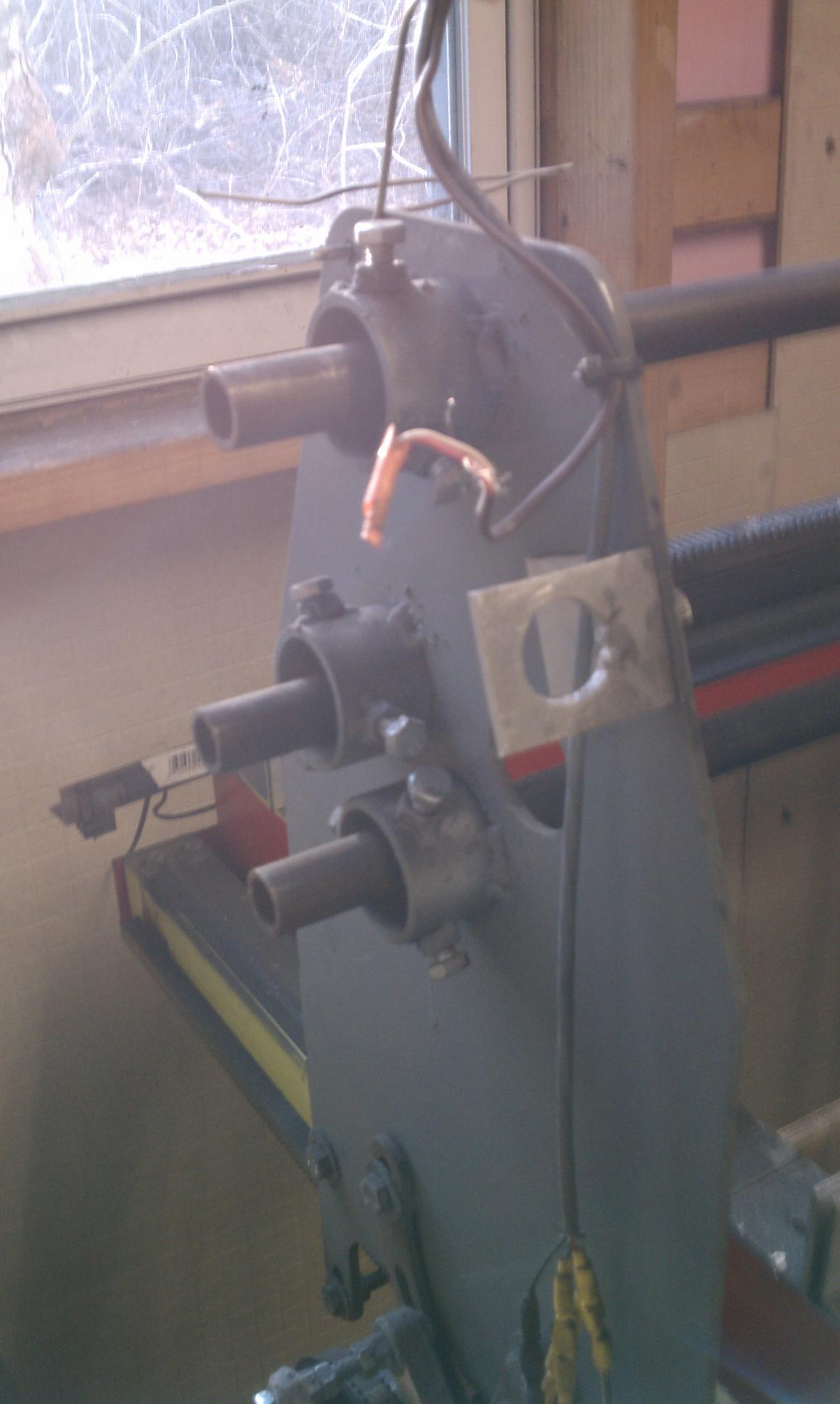

    Here are a few renderings and a thing or 2 that I have cut out. I'll upload some of photos of my machine in the next day or 2.
    I'm not using a THC, although I would love to buy one. I usually pierce at 0.15" and cut at 0.08". I get some slag on the underside of the cut and im still trying to hone in the ipm/amps for different thicknesses. I use the 0.35" cut and pierce height only when I'm trying to make heat marks to aid in assembly.
    I purchased a few breakout boards from CNC4PC also. I fried 3 or 4 in the first couple month. For some reason I have to turn my electronics on in a certain order.
    1. Start up PC and Mach3.
    2. Plug in breakout board power.
    3. Turn on toggle switch for breakout board.
    4. Turn on toggle switch for Relay.
    5. Plug in Stepper motor/drivers power.
    I've been doing it that way for months without any causalities.
    I didn't have any high tech tools to build this table, so it my be lacking in some places just so i could get it finished. Now that I can cut out precision parts, I plan on some redesigning to make it preform better.

    Sorry it has taken so long to reply. I had some kind of stomach super bug that had my laid up for a couple days. Here are some pics. It's still a work in progress, but it runs. I know I know... It needs cleaned up a little. I just want to hibernate with this cold weather. Let me know if you have any questions. I'll write more tomorrow.

    I also have been thinking about converting my CNC Router system I built into a CNC Plasma table.
    I was even thinking about a Dual function table.
    Here is a picture of my CNC Router in the final stages of build a few years ago.
    It is a folding table system to save room in my shop.
ID:	7511Click image for larger version.
