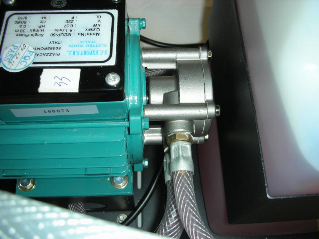

    Here are some pics of the guts of the power cool.
    In my opinion a very impressive machine.
    Italian made pump from a well known maker of espresso machine components. 9 liters a minute output, direct drive pump and fan on same shaft, simple uncluttered design with a 2 gal coolant cap and a cross flow radiator.
    Moves allot of air and water and looks like it’s made to hold up to the long haul.

    Very nice. I'm working on my own DIY cooler right now, but I have a feeling in the end I'll be sorry I didn't pony up for the W300.

    Kewl. Excellent review Ray! Yeah, I'm alright with the whirring of a fan or the like I just stuggle with the tinny sounding racket my Dads old Miller cooler makes. It is a thousand years old and the bearings are bad in the pump and/or motor...
    Ray, the only thing I see from your photos I might change or upgrade is possibly an inline particulate filter to help keep from wiping out the pump. Your thoughts?

    Not a bad idea, but I would be carful what you use, it would have to have a high flow capacity, something like a fuel filter would not be enough. An inline screen filter of some type would be good.
    But truly the only way something is getting in there would be from maybe dragging the torch leads on the floor. And even then I don’t think it will harm much, I’ve had a couple of guys put those stick on fish aquarium thermometers on the site part of the tank to monitor the temp.
