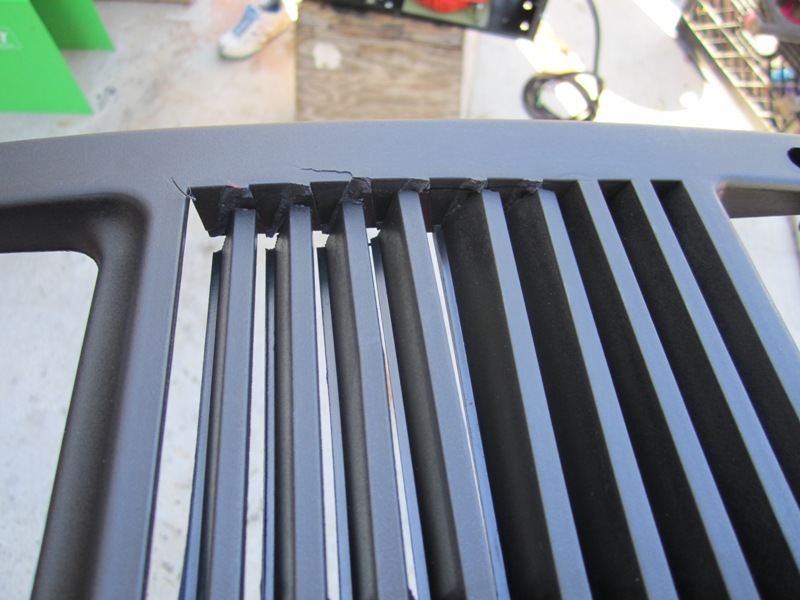

Name:	broken rear panel on replacement.JPG
ID:	732   Click image for larger version.
