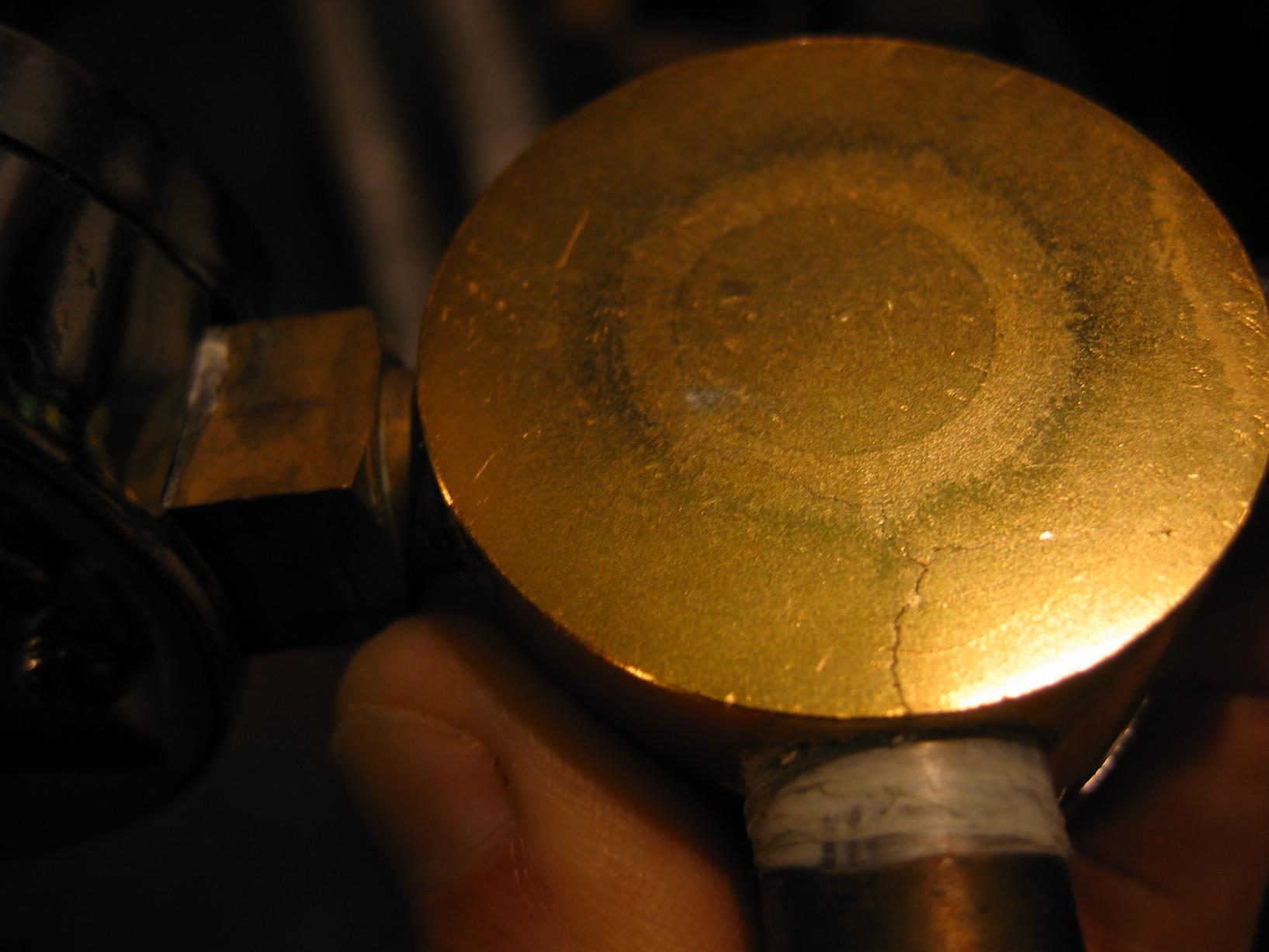

    Wow. I was wrong about the problem. The fitting wasn't the leak at all. The argon was just blowing across it a lot.
    The regulator body had a hairline crack running between the gauge and cylinder ports. It was nearly invisible, but under pressure it would spread apart enough to let gas out. Thankfully it didn't explode.
    My guess is that it was probably cracked before I got it and only spread enough to leak later.
    Anyway, problem solved, I've ordered a new regulator.

    I just discovered a similar leak on my regulator. A hairline crack from the tank inlet port to the gauge.

    I have the same issue on mine, I finally got around getting the argon regular setup on my tank. I snugged up the connections, but making sure not to over tighten them, but when I slowly opened up the valve I heard it leaking quite a bit. I thought it might be the threads leaking but when I looked down on the body of the regulator I saw a hairline crack. At first I thought it was just the chrome finish but when I opened up the valve again I noticed the crack was opening up and I felt gas flowing out of it. I quickly closed the valve, worried it might explode on me. I pretty d@mn glad that I did a check before opening up that thing all the way.
    I hope Everlast can help me out here, the regulator has never been used before, this is its first time on the tank. The regulator has always been kept indoors where its warm, so I don't think its temperature shock. What I can guess is that it was damaged in delivery because the box the regulator came in was pretty smashed up. I guess I should have looked more carefully but the unit itself seemed pretty stout, I didn't think that the heavy metal body would crack so easily. Initially when I got it I just made sure the plastic flow meter and pressure gauge wasn't damaged. I've included some pictures, sorry if they are hard to see, I ran out of batteries for my camera so I used my cell phone to take them.
    image of crack from inlet to pressure gauge:
    image of crack from pressure gauge and almost to flow meter:
    You don't want to use or attach that regulator anymore, the potential for injury is too great. There is a lot of pressure in there and if it blows apart you could get really hurt. trash that thing and get a new one.
    Here is the crack on one of my everlast regulators, starting at the inlet nipple, extending towards the middle of the body's back side.
    It took me a while before I noticed it and I only found it by accident. I was applying leak test fluid around the CGA-580 to argon tank connection, to try and find out where my expensive argon has was going. I got some leak test fluid actually by accident on the back of my regulator. "What the heck are these bubbles?"
    I should say on this regulator, that I did have a "professional" regulator rebuild shop install the CGA-580 nipple. That is because the everlast regulator originally came with an incompatible CGA fitting, which would not attach to a standard argon bottle, as found in the USA. The shop did say something about not being happy how it went. Maybe they caused this crack, I don't know. But the regulator body does seem to have a thin spot / weakness where the crack is that I have shown. Be careful...

    They are cheap junk plain and simple. You get what you pay for. Also using teflon tape is a no no as the threads are so lubricated with the tape that it never feels tight and one will tighten too much till it splits. Should always use teflon paste.
    geezer: you're right its not worth the risk to keep that regulator attached, with 2000psi surging through it can go bad really quick. I shut the gas and took that thing right off after I found out where the gas was leaking from.
    jakeru: looks like the shop might have installed the new nipple that was too big for the opening and caused it to expand and crack. Or another possibility was that they heated the nipple to try to remove it from the regulator which caused the metal to become brittle. But that is just my guess. If its cracked its best to replace.
    These days you have to take the good with the bad, there is a big difference between brass made when I was a kid and todays' brass. Todays brass is mostly recycled brass (they say up to 90 % of all brass) and the copper zinc content can vary creating a more brittle brass subject to cracking. As far as the regulator goes, they are a good buy at the price, just don't over tighten them in certain areas where the guages etc. go in the body and like anything else give it a periodic inspection. The days of using virgin brass to make things is over. Everything is recycled these days.
