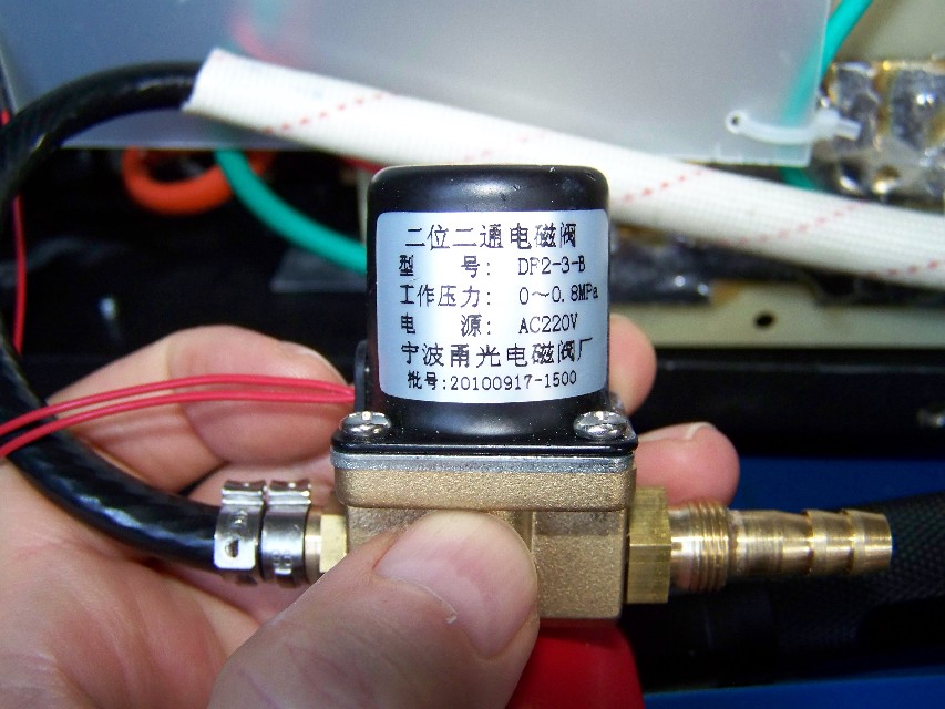

    Anyone know what type, size etc. thread the shielding gas barb is on the back of the 225LX machine is? I'd like to change the fitting over from the barb to pressure type threaded fitting for the shielding gas line.

    I have the PP256 and I would think that it has the same solenoid as your 225LX. The threads where the barb screws into the solenoid are in fact a "BSPP- British Standard Pipe Parallel" type thread. There is not a taper on these threads. The size is 1/8" BSPP G. You can mate a BSPT R (has a taper) male, to a BSPP G female thread, but not the other way around.
    I'm sure that some other owners of the multi process units have noticed that the 1/4" fittings that go to the air filter/regulator, have an o-ring on them, that is because that is a straight or parallel thread and if you try to put a 1/4" npt fitting in,it just don't "feel" right because it's not, the regulator has BSPP female treads in it.

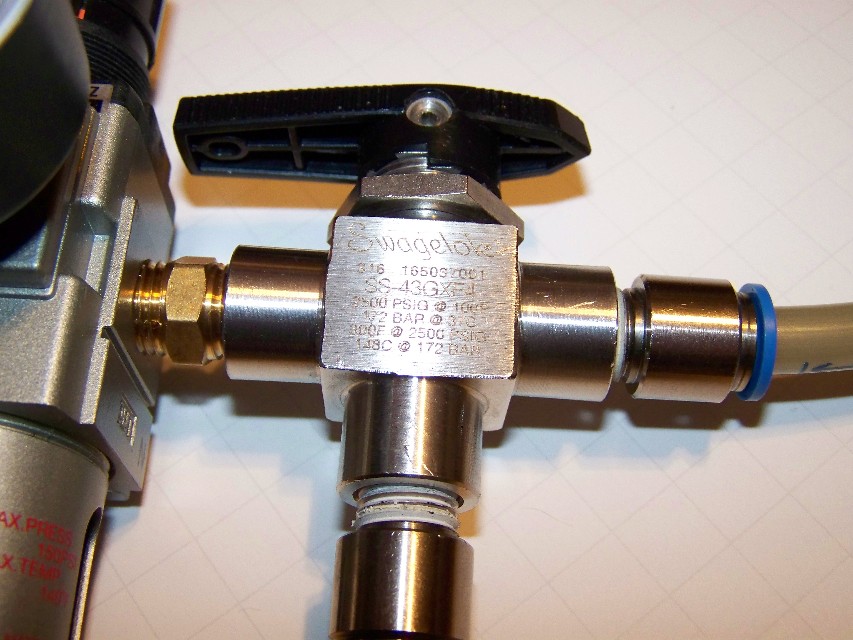

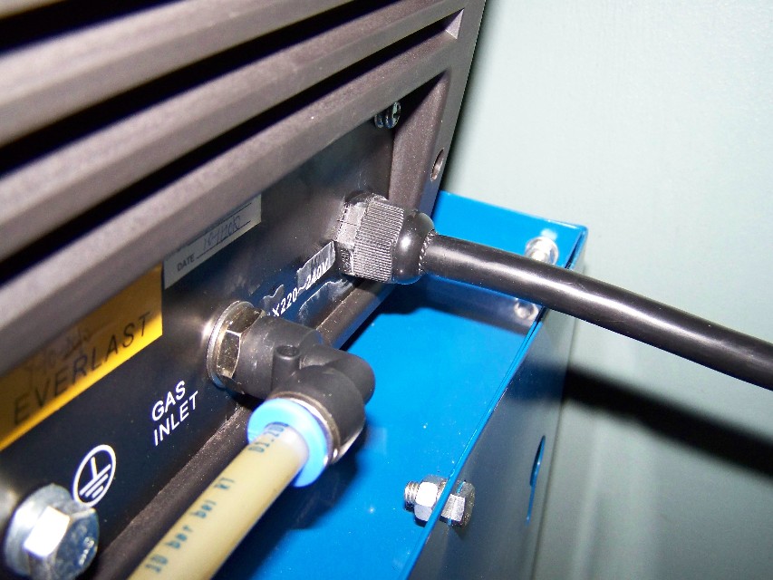

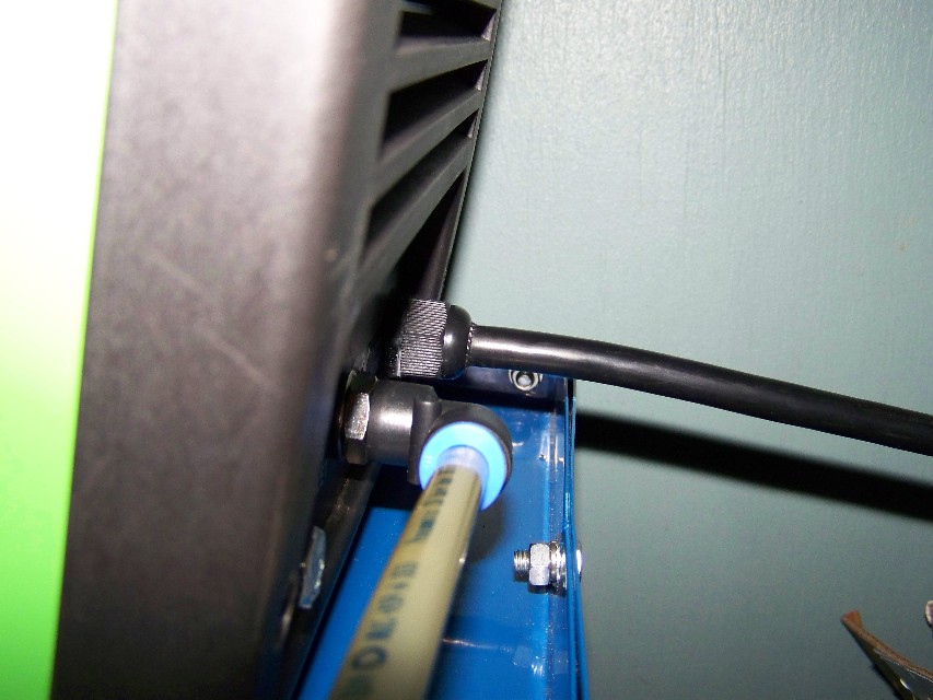

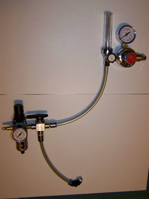

    Here is how I set mine up. <see pics>. I needed to have my line go 90 degrees from where it was originally because it would run right into my argon cylinder on the cart that I have, (harbor freight). Also, my unit has a plasma cutter and the filter/regulator hangs off the rear and you have to swap the hose over every time you changed over from welding to cutting and the hose passes right in front of the on/off switch. PITA!!

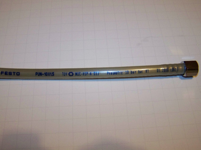

    So, all you need to do is something like I did. The hose that I'm using is polyurethane and rated at 145 psi and is VERY durable and is compatible with argon and helium. The fittings are rated the same, they are nickel plated brass and a very strong polyester thermoplastic.
    1, Hose is Festo PUN-10x1.5 (10mm O.D.) 145psi rating
    2, Fitting that goes into solenoid, 1/8 BSPT to 10mm O.D. tubing.
    Be sure to use a thread sealant,(like leak lock) and not teflon tape.
    The solenoid is rated at 0.8 MPa which is 116 psi, so everything installed is over rated. (especially my 3-way valve! 2500psi!!)
    The hose has a very tight fit over the barb on the argon regulator and seems impossible to remove once it's pushed on so I did not put a clamp on mine.
    Works like a charm with NO leaks!

    When I changed out the gas inlet fitting on my machine, I had a fan issue that I was taking care of as well as adjusting the HF points. Since I had the cover off to deal with the fan/point issue, I decided to do my modification to the fitting at that time. The solenoid is actually held in place by the original brass barb fitting and if you look at the pictures that I posted you can see that I have a stainless washer between the fitting and the case. I had to put that washer there to take up space so the solenoid would be tightly mounted.
    Be aware, that the wires going to the solenoid are kind of small and it wouldn't take much to yank them out and would be a drag to repair if that happens, (as well as void the warranty on it!!).
    Also, the original barb fitting has the straight threads on it, but there is not an o-ring installed. They have sealed the threads with a VERY high strength adhesive/sealer and is VERY difficult to remove from the solenoid.
    If you still decide to attempt your hose adapter, you need to be able to mount the solenoid in a vise to prevent damage to it or you while you pull the original fitting off! And don't forget to use a high quality thread sealer upon reassembly.
