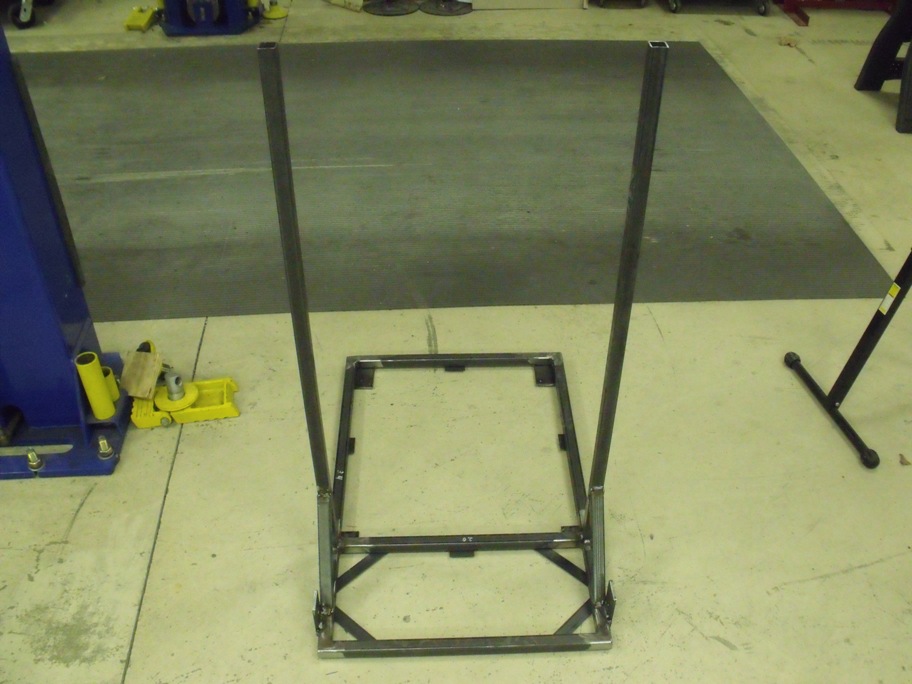

    This is the start of my welding cart, It will have three shelves. The bottom for storage, or maybe a drawer. the middle will hold my Mitec plasma cutter and a future W300 water cooler and the top will hold me 250ex tig and I-Mig 200, there is room for two bottles of any size I may need. I will be adding holders for my cables, peddle and filler rod.
    Pic # 1 is the basic frame layout
    Pic # 2, 3, 4, are different views of the frame and main upright shelf tabs and attachment plates for the wheels and casters.

    Nice project Ram48! What process are you using to weld it up?
    I need to make an adapter of some sorts for my Tig machine. I just bought the Tig runner system, it only has room for one bottle. Not that I use the helium bottle that much, but it would be nice to keep it with the Tig machine.
    Right now I am just using the Mig and I am at what I like to call my melt and pray stage of development.most welds are not pretty but hold and every once in a while I lay down a decent bead, and they are slowly becoming more common. I need a lot more helmet time. but once I get this project finished. I need to start playing with the Tig. I have not even fired it up yet.
    The Mig will come fast. Tig will be harder to pickup, but much more rewarding!
    Looking good, don't worry about pretty, just crank up the heat and learn to control it. It's all about helmet time, after awhile it becomes old hat, pretty comes later. You will find the 250Ex a great machine when you have the water cooler hooked to it. I can see you are well on your way to becoming a builder of neat things. Your last project looks real good.
