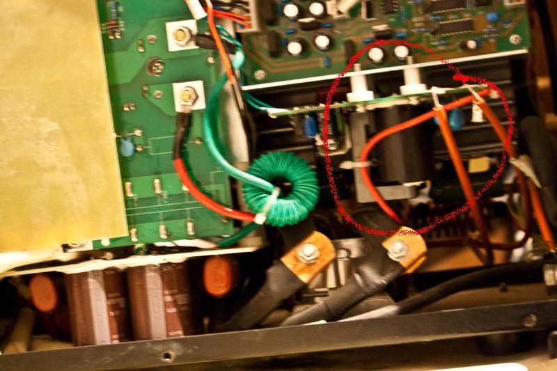

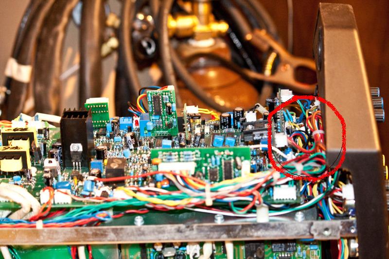

    So I got bored and decided to open up the welder and get some pictures. Maybe these will help someone in the future.

    On the AC freq knob, moving it from 10 o'clock to 2 o'clock should change the arc sound a lot.
    I can see in the pictures, a bend in the top rail. Looks like it was dropped and hopefully just popped the AC switch plug off like Wrenchtamer.
    Call into support and we will check it out. Leave the cover off and the machine off for 2 hours before calling.
    From my conversations with mike have given me the impression that that high frequency spout shouldnt be tie strapped to the flyback transformer like that. It's oe of the first things he told me too look for. It's the red wire on the passenger side of the machine next to the inverted transformer you see with the l shaped bracket. that wire is the spark output to the high frequency points. I would check to see if it is arcing out there. and the plug that was off on mine is not easy to find. it's on the top board near the fron kind of in the center. a three wire plug sits transverse to the body of the unit. its kind of hidden up near the front. i had the cover off myself and didnt catch it until I took it to mark.
    here I took your pics and circled the problem areas I noticed. Minus the big bend in the suspension rail. check with mike or ark about the flyback transformer thing first tho. It might not be a problem unless it is arcing out.

    So I went looking around the upper board of the welder and noticed that a connector did not look seated, so I made sure the connector was fully seated. Hopefully this was the issue with my AC not working correctly. I have some pics to show the area I am talking about.
    That's the one. It controls your AC switching (for a lack of better terminology). Without that plugged in, it will be stuck on DC positive. That was the loose plug on wrench tamer's unit as well. Not sure why we have seen it loose on two units like this close together. I know I haven't seen any, maybe Mike has, or Ray. Move the copper strip coming out the bottom over so it doesn't touch the wire of the transformer (black thing, red wire pic 4)
