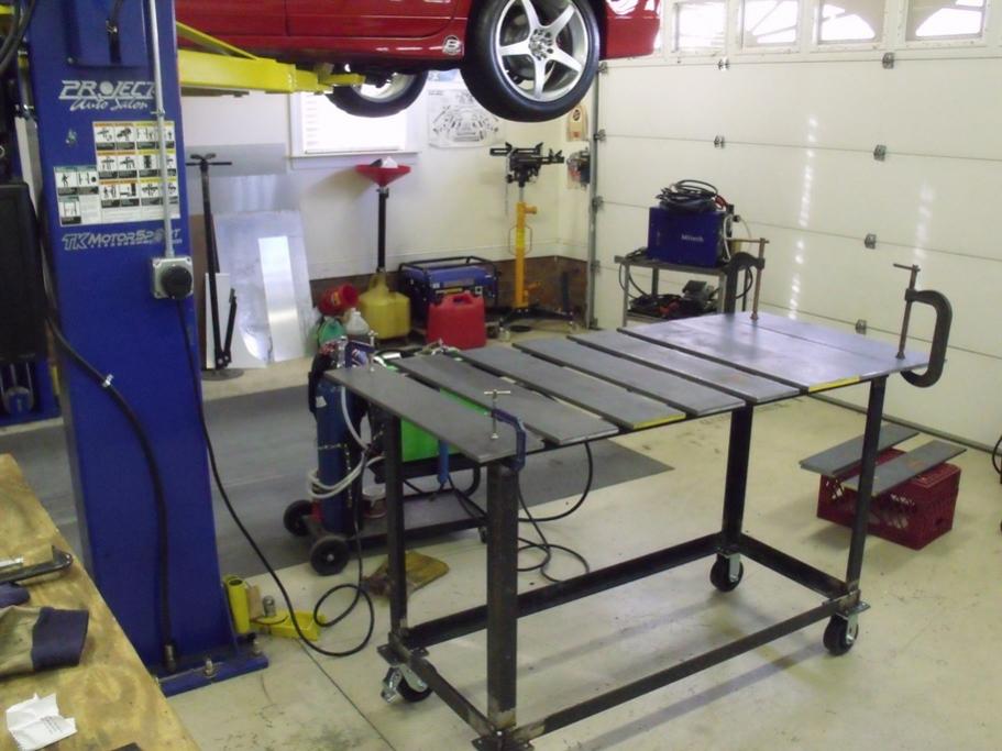

    This is my welding table project and the first time with the I-200
    Used 1.5 x 1.5 x .250 angle for the frame and a combination of 6x1/2 and 8x 1/2 on the top. I butted the 8 inch flats and left 1.5 in between the 6 inch slats.
    5 inch casters are from Caster city two fixed and two total lock swivel
    I am going to bolt the slats from the bottom so I can remove them for room or replacement if they warp too much
