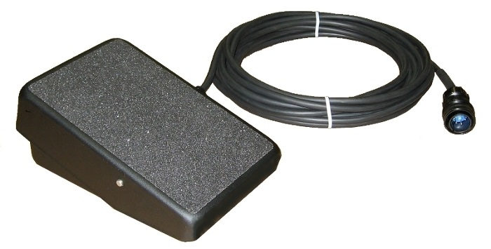

    Mark or Mike, any luck on pictures of the new low profile pedal yet?
  15. #35
    Quote Originally Posted by Velocity View Post
    Here ya go...
Name:	everlast lp pedal.jpg
  16. #36
    We've had the new low profile for some time now, at least since March.
    Zoama, the one above, is from SCC controls, not us.
  17. #37
    I took the picture from everlast's ebay ad for everlast welders... http://cgi.ebay.com/New-Foot-Control...item3369c0fb37
  18. #38
    Mark if that's not it, then can you post a picture of the new model? thanks.
  19. #39
    I'll have to find the post, but Duncan has posted it here on the site already. You can either search through them or I'll try to find the post a little later, when I get caught up.
  20. #40
    Is it not for sale ? The only low profile pedal that I find for sale by Everlast is the one I linked to at their ebay store. Why keep this new product secret ?
