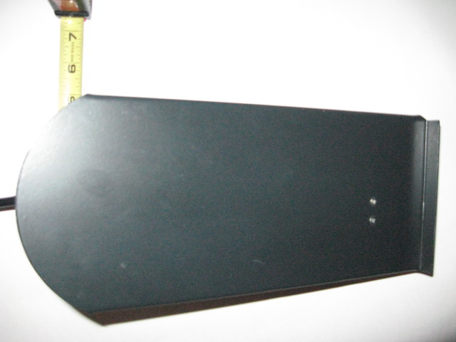

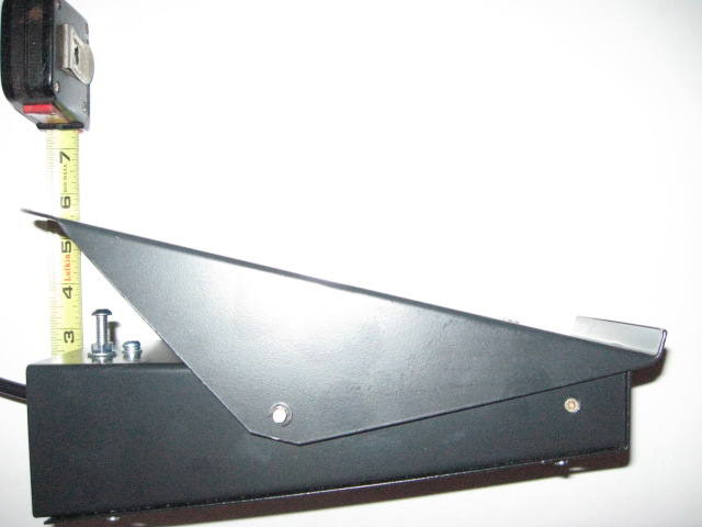

    Sorry for the confusion, The pics at Everlast only show the old tall pedal (http://www.everlastgenerators.com/pr...ot-Pedal_1.jpg) same pic in welder description. I guess the new ones are lower profile than the old pedals, just not a true low profile like the SSC. Here's a couple pics of the one that came with my PP256. Updating the pics at the Everlast store would end the confusion.

    Zoama,
    The new pedal supplied is low profile, true low profile. 5.5 inches is low. Just because something is designed differently doesn't make one true and the other not. The SSC is only 1.5 inches lower, with less resolution capability....So there are trade offs.
    We are working on updating everything, but there are several hundred pages, each one needing fine tuning, and only a couple of knowledgeable people to do it...One being me. And for whatever reason, I was informed to wait on updating the pictures until we were sure we were going to stick with the pedals.

    Thanks for clarifying that there is a new, low profile Everlast footpedal design for the IGBT machines, Zooma, and for sharing the pictures. That is the first time I have seen the new design.
