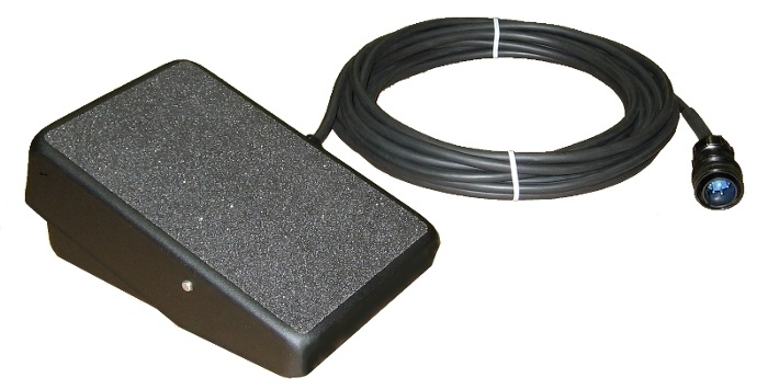

    The Everlast Foot Pedal just didn't work for me so I called SSC Controls and they made me a Lincoln Style pedal.. I got it today... One word describes it....
    SWEET!!!!!!..
    125.00 plus shipping. It was 138.26 to my door. They made it the day I called and shipped it the next.
    The model is Custom Build # L50,000-S-25FT. Just tell them to build you one just like they did for Steve Schefer. Their number is 440-205-1600.
    They didn't have a 7 pin connector to match to the 250EX so I had them leave it off. I cut the connector off the old foot pedal leaving about a 2' pigtail and spliced it together rather than futzing with the connector. The wiring is as follows:
    Everlast ------------------------> SSC
    Black --------------------------> Black --- Pin 1
    Blue ----------------------------> White -- Pin 2
    Gray ---------------------------> Blue --- Pin 3
    Brown --------------------------> Brown -- Pin 4
    Green/Yellow -------------------> Red ----- Pin 5
    Then SHORT pins 6 and 7 so the welder knows it is a foot pedal connected.
    I fired off on a piece of cold 1/8" Al with 115 amps and laid down a perfect weld with total control of the heat.
    I've been holding off on saying anything about buying the control. I didn't want to get everyone all excited over nothing if it was a flop.
    I highly recommend it... I'd like to see Everlast partner up with SSC and sell these things as an option. I don't know if the pricing fits with the Everalst product line so including it as a standard might not work too well.
    I don't know though, it certainly makes the welder do a 180 when it comes to finite control.
    Now excuse me while I go play with some practice welds..

    Those look nice, I only pedal like 10% of the time but I will keep this in mind. the EX is a great powerunit, I just like smoother accessories, same as you.
    Hey Steve,
    Thanks for sharing your info. Sure others will be in the market for their pedal and your mod.
    Looks like you will need to lengthen the torch and clamp now, if you have not done it already.

    I went to their website to see the pedal. It is a low profiles. I don't really use a pedal with the stuff I work on, but I might use one if I had a cool low profile.
    Steve just posted the details on how to wire the custom one they made for him. I talked to him a few weeks ago, so I knew he was working on it. He has done it and is sharing all the pinouts if you like their pedal. Seems he does a lot.
    One things I did not mention. Steve, you might want to put the Everlast pin numbers rather than the wire color. Over the years, the colors have moved around. Thanks again.

    I'll put the pinouts up this evening. I just translated them using a multi-meter but if you've never done that before it can be a little confusing so pin-outs will be here tonight.
    Update --- I just posted the pin outs in the original post. This is as they are on my 250EX. I can't tell you that this is going to be the same on your machine but you could send your footpedal to SSC and have them reverse engineer it for you.
    Also, their website is www.ssccontrols.com. I dealt with Jim and Brent Moll. Nice guys putting out a quality product.

    Those pedals look very small.
    How much travel do they have?
    I'm getting more comfortable with the pivot in the Everlast pedal but it is a little unnatural feeling.

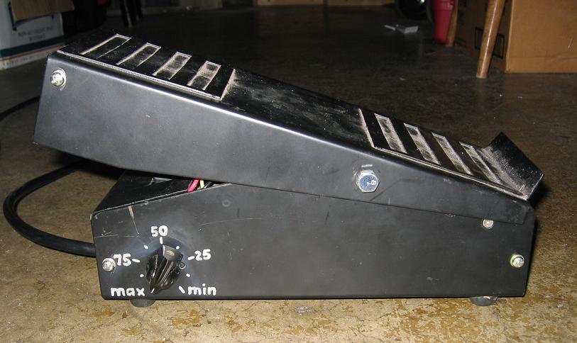

    I like my ~3 year old, metal everlast footpedal. I just got it "tweaked" so I can get 1 amp on contactor switch engagement now, and 197 amps at pedal full down. (You can test this by viewing the digital readout by the way, without actually lighting an arc, by switching the machine into Stick welding/MMA mode.)
    Only thing I wish my footpedal had was, about a 7' or so longer cord. Does anyone have a reasonably priced source for an appropriate, flexible 5 conductor wiring for making a footpedal extension? Or does anyone know what gauge conductors would be necessary?

    Bill, the travel seems seems adequate. I always add 10 amps to the max of whatever the book/calculator says and that pretty much covers the working range I like to be in.
    Call Mike or Mark for info on the new Everlast pedals.
    Pinouts will need to be confirmed by Mike or Mark also.
    You'd want to get an O.K. from Everlast to do this but I see no reason why you couldn't just get a more standard female Amphenol connector with at least 7 pins and replace the one that's on the machine now. Changing connectors is more like plumbing than it is electronics.
    Torches are just two wires on pins 1 & 2 and no jumper on 6&7. A couple of finish nails and aligator clips will get you by. I don't recommend that as a permanent application. O.K. I don't plan to change mine but I did solder the wires to the nails.
