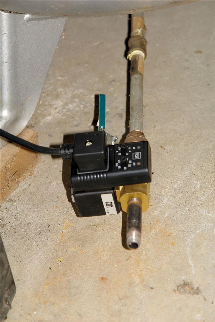

    Fired up the PP 70 for the first time today and no water accumulated in the compressor's trap or the cutter's trap - not a drop. The 80 gallon compressor tank and gas-shut off drain valve on the tank's bottom probably help. The valve is opened only occasionally and, at most, a cup of water comes out. No rust.
    CA is pretty dry compared to elsewhere in the country. That is until we get the cold "tule fog" that lasts weeks on end. That has me a bit concerned.

    The HF 3 foot long desiccant dryer is in place now but a smaller second in-line one, also from HF, was too restrictive and the air pressure to the torch drops by 30 pounds with it in place. Maybe the 3M one would be less restrictive.
    The large HF dryer is near the compressor but it is attached with a 50 ft. coiled nylon hose. It probably doesn't matter what the physical distance is from the compressor but rather how long the line is to enable cooling.
    Also, a timed tank drain was installed to keep the water out of the main tank.
    That is about all I can do to dry things out right now. It seems to work and no water is showing up in the traps.
