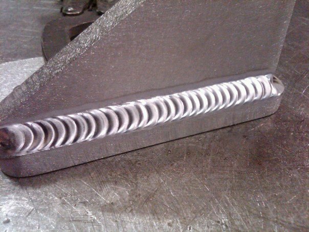

    All,
    I am looking to purchase a Powertig 250EX or better yet an EXT when they become available.
    I however haven't seen much for aluminum welding photos by Powertig owners. If you have some nice work please post it up! I am hoping there is some good stuff out there that will help sway me into purchasing a new Everlast Powertig.
    I will start by posting a few photos of some work that I have done with a Miller Dynasty 300. Hoping to see some comparable work with Everlast units!
    Best regards,
    Tony R

    Nice work Tony. Can you give some details?
    Thanks.
    Dynasty 350
    250 hz-300 hz ac freq depending on material thickness and joint design
    material is 5052 varying thickness
    filler is 5356
    EN to EP Amperage Ratio Approx 1.5:1
    balance @ 70% EN
    wave shape - advanced squarewave

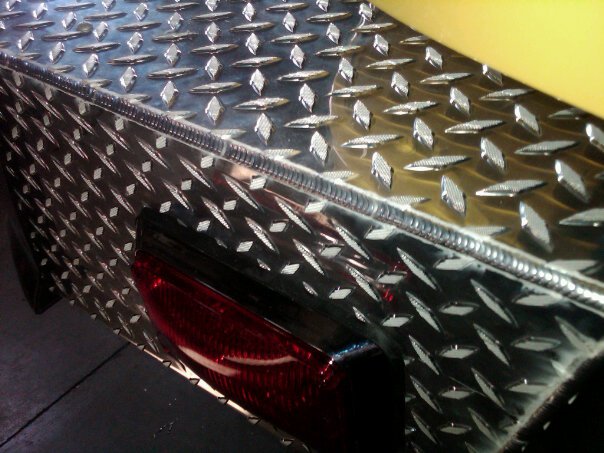

    Not my best aluminum welds I've done in a while (or best pics for that matter--cell phone) but these were done with the Everlast PM205, ~8 or 9 on the pedal, 1/8" filler. I've been stuck wrenching more than I have been welding at my new job where as the last one was full on welding/manufacturing.
    Attachment 1399Attachment 1400
    Quote Originally Posted by 91TSiGuy View Post
    Those look petty good to me, nice job!
