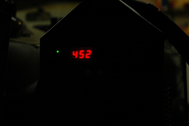

    So I got back from my thanksgiving visit in Northern Cali, and my new foot pedal was waiting for me. After unpacking the kids and truck I went into the garage to plug in the new foot pedal and make sure my little over amp issue has been resolved. Unfortunately, I either have a second bad foot pedal, the issue is inside the machine, or I have a special, one off factory over clocked 250EX. Does anyone have any bright ideas?

    I had an almost identical problem that developed with my LX225. Mine turned out to be a bad 4053 multiplexer chip on the pedal sub board as well as a couple blown protection diodes immediately above it (semi-shorted). Evidently, some HF got into the potentiometer wiper line and blew the multiplexer and protection diodes. The HF points spark gap was very wide which I'm sure was the cause.
    The welder worked fine in 2t and 4t because it was only the input to the multiplexer that went bad. It could still select the main amp control as an input, but the pedal input was fried. Originally it wouldn't put out any amps, but after fixing the multiplexer it worked just like yours. I was so excited because this corrected the display, but when I went to weld some 16 gauge stainless with the foot petal, it went "BWAAMP" and that was the end of that piece of scrap! So perhaps it's just a protection diode on your one.
    On the LX225 the multiplexer is on a little vertical daughter board on the starboard side of the top board. Of course yours is different I'm sure.
    Return was an option for me too. I just didn't want to do it since it was working in 2t/4t.

    Adam,
    Paul is correct on your problem. We can send out parts if you know how to solder? Otherwise you'll need to contact sales.
    The layout as Paul described is the same for the EX as well as the LX.

    I spoke with Mark this morning, and it sounds like my issue, like Pauls, is unusual and rare. Mike, I left you a message this morning and I believe Mark sent you an email regarding my issue. I look forward to hearing from you and seeing what diagnosis the troubleshooting brings to light.

    After speaking with Mark, Ray and Alex, I'm going to try the CMOS replacement chips. Ray will be airmailing from AK, so hopefully in week I can desolder the bad chips and install the new ones. I'll post an update, and maybe a new thread on how to do the chip swap if anyone is interested.

    Be careful desoldering. The thru holes & traces pulled up pretty easily on my board. I'll have to find the pics I took.
