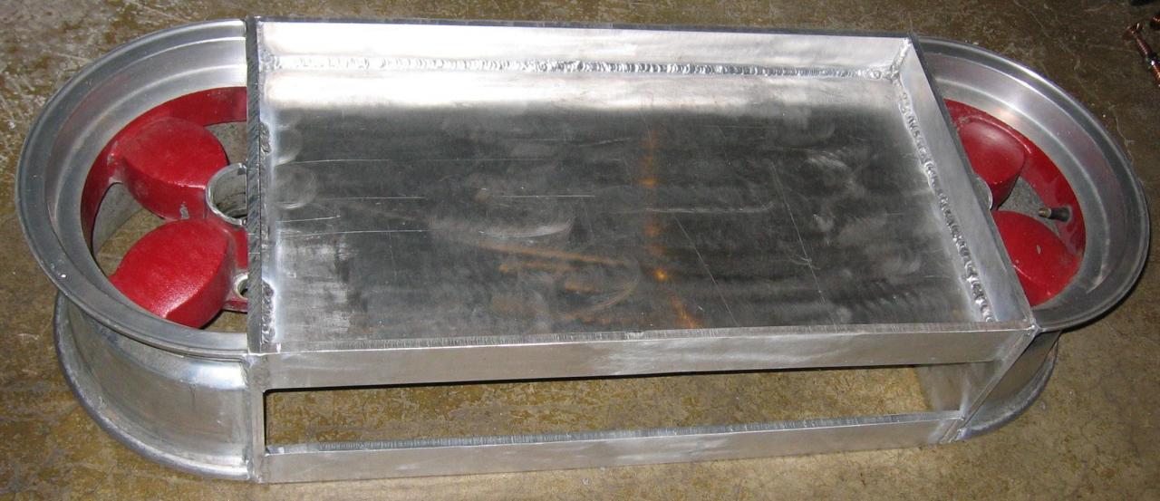

    I wanted to post a picture of one of the decent welding beads I managed, connecting a sawed in half aluminum road wheel to a 3/8" aluminum plate, which I managed with the ~150 amp rated WP-17. I had to do this about 2"-2.5" at a time, then set the torch down and keep the post-flow running for a minute or two to cool it. Before the next bead, I'd then pre-heat the work with a good 10-15 second blast from a high-BTU propane "weed burner", which made it easier to get the next 2-2.5" weld bead started. Rinse and repeat.
    I got the job done, although some of the welds weren't the best before I figured out the contaminated gas from overheating argon/power cable thing. :eek: The project is just a sign however, and luckily the customer was going for the "industrial look" and was completely happy with my welds, so its all good. Just took me a while (A LONG WHILE!) to get this done with the WP-17 holding me back.
    I am liking your suggestion of a water cooled torch upgrade. I think that's great that I could use a water cooled torch without water, at lower current levels for convenience, just like an aircooled torch. Sometimes I really appreciate keeping my setup portable so good to know I wouldn't need to lug around a cooler or need city tap water wherever I took it. I like to sometimes just throw my argon bottle, welding machine, and the couple necessary cables (torch/ground), into the back of my car, plus my little welding toolbox (with little clamps, some filler rod, safety gear, etc) into the back seat of my car, and be ready to weld wherever there is a 240V 30A clothes dryer outlet. I look forward to connecting with Everlast sales about a torch upgrade after they return from fabtech.
    My customer says he has some additional 3/8" aluminum pieces planned (in addition to a few ~1" or so cubes!) he still is going to want me to weld onto this custom sign I am helping him make. :o

    Here is an overall picture of the sign. I am not proud of some of the welds on this however, before I developed the torch overheating prevention techniques, necessary to keep clean shielding gas.
    Tack welding without any pre-heating worked just fine. Just hold the torch still for however long it takes (7, 10 seconds?) for both parts to melt, and bridge the gap with some filler. 1/8" 5356 made for for nice and strong tacks on whatever material this was (I have a feeling the bar and plates were 6061.)

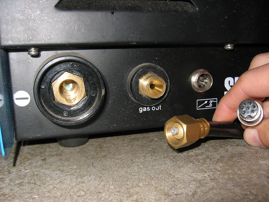

    OK folks, I have ordered up locally a CK trimline 210, which is supposed to be one of the less cumbersome torches in the "aircooled 200 amp" category. I'm hoping its about as maneuverable (or more so) than my current WP-17 torch, which has aside from the overheating issue, been working just fine for me. The simplicity and portability of the aircooled setup had appeal. I also sprung for the flex neck and superflex hose options, so hopefully it might even be easier to use, despite having more current carrying capacity.
    However, this CK torch is going to come with a 5/8"-18 male threaded argon fitting, so I'm still going to need a female 5/8"-18 to female M16x1.5mm adapter to get the new torch connected to my Everlast machine. Neither my local welding supplier, nor CK had ANY metric fittings or adapters.
    I'm hoping the folks at everlast, or perhaps someone else reading this can help me locate a suitable adapter.
    PS - here is an adapter I found on ebay that is similar to what I'm looking for; I just need it to be M16x1.5mm female to 5/8x18 female
    http://cgi.ebay.com/Hose-Coupler-Ada...#ht_680wt_1139
    Any ideas?

    Thanks for the helpful suggestion, Steve. However if I changed the "gas out" fitting on my machine to 5/8"-18, then my plasma cutter (which also uses the M16x15mm "gas out" connector) would not longer hook up. :o
    Ahh, that makes sense.
