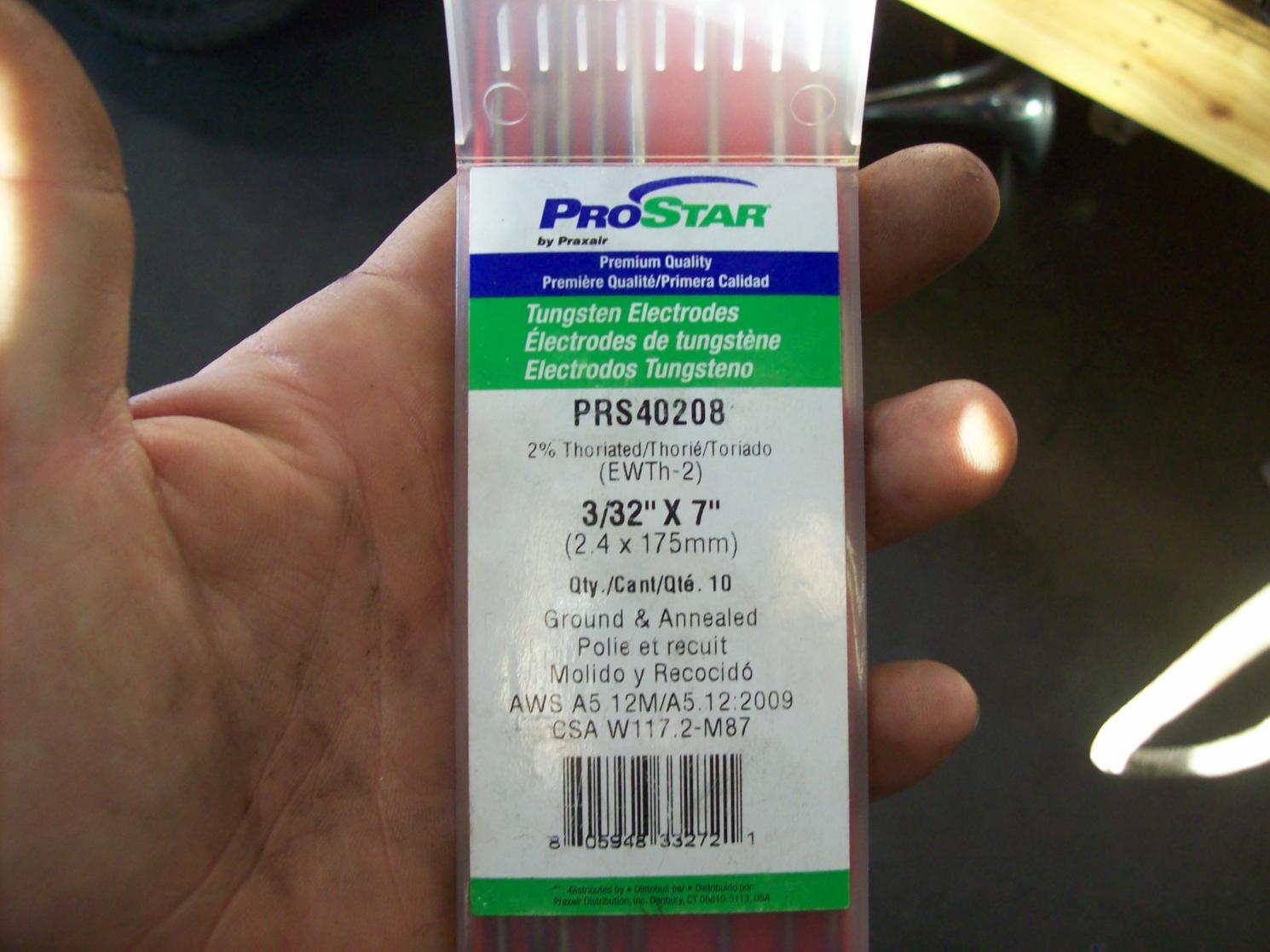

    Quote Originally Posted by Wrenchtamer View Post
    yeah that's straight argon. for 3/32 I only have 2% thoriated. I can go to 1/8 I have some 2% ceriated. I will try it and take some pics. 90 amps is going to burn it real fast tho.
    I dropped it to 70amps (in the above post), in case it is the unit, why waste electrodes. And ceriated is fine as well.
    I edited the post and you posted within a minute or two of my first post before the edit.

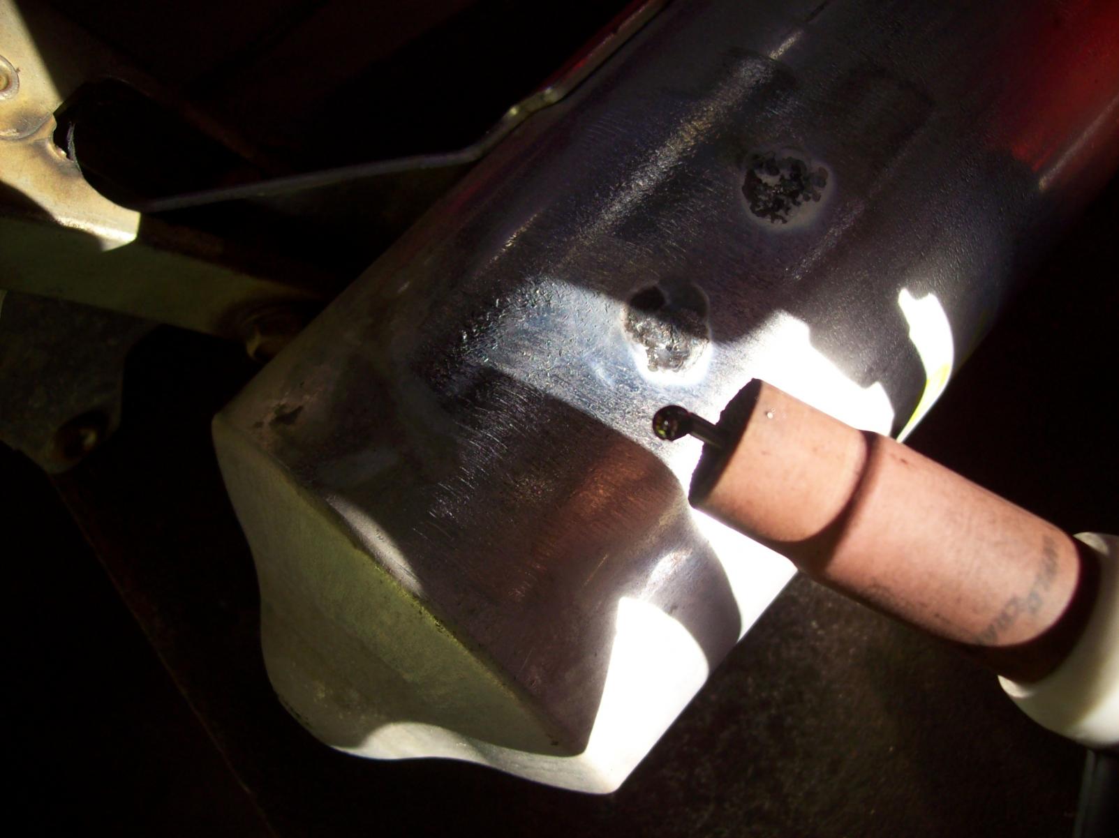

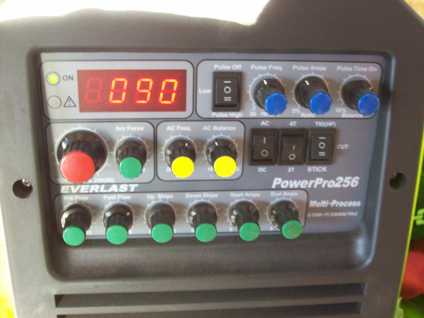

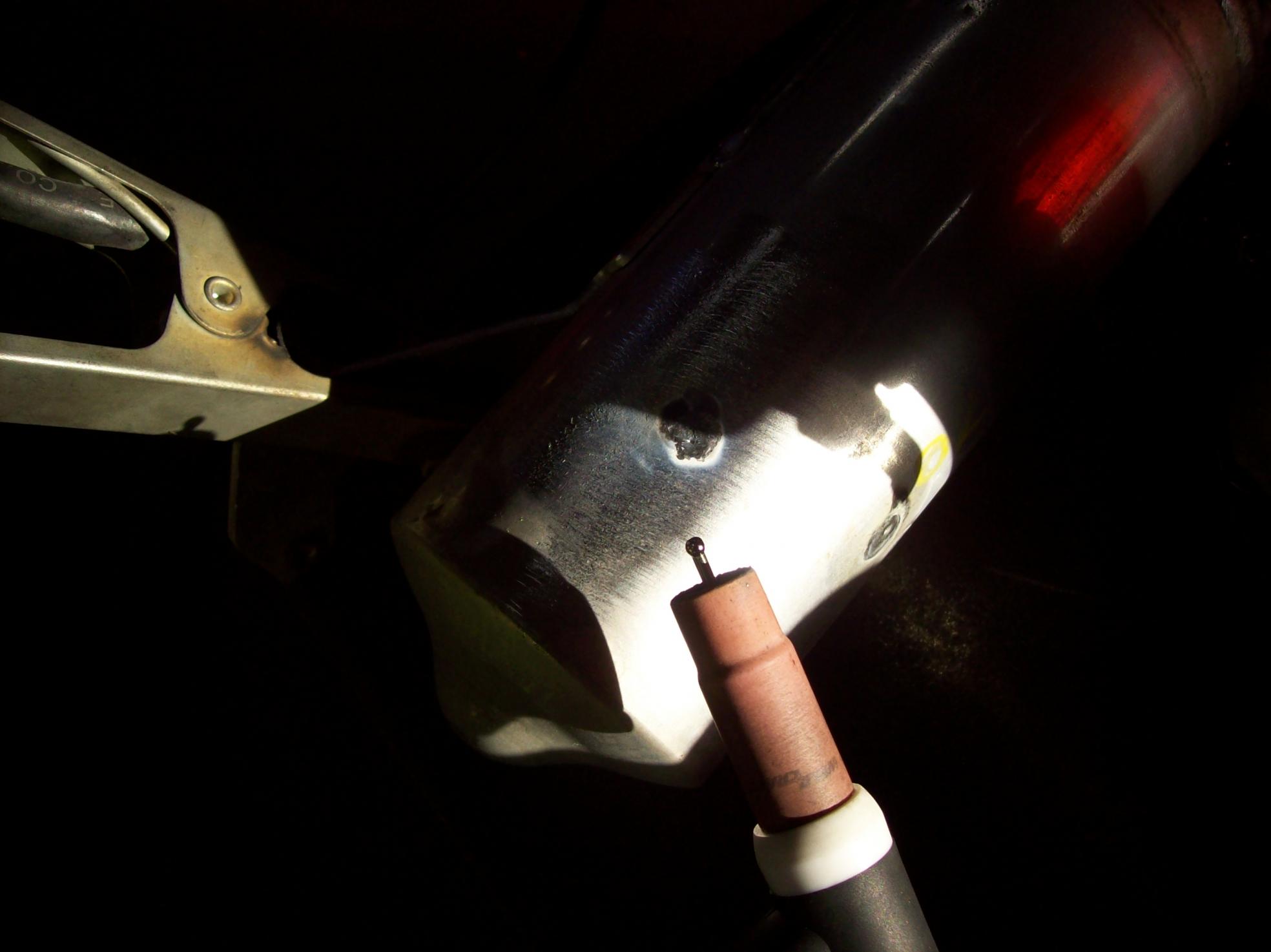

    here they are. the first torch shot was 90 amps, balance as requested, just a hair over one second run time, the second shot was about three seconds and the tungsten threatened to drop into the work. I used a brand new one. not the same as yesterday. crap sorry I had already run the experiment at 90 amps. I can do so again at 70 if need be.

    That was with the trigger, not the pedal? Also, from the AC Freq to 10 o'clock for me too.
    Can you email me your phone number (support@everlastwelders.com). By phone later today would be a lot faster to figure out what is going on. The weld looks better, but it is way too hot.

    yeah sorry you cant tell in the photo but the torch is hooked up correctly. I assume you mean adjust the balance all the way positive? I will if you want but in my previous post the two colums from (left nad right) are 10% and 90% respectively, results visible. When I stepped up to the 5/32 tungsten I could weld at low amps without melting the tungsten but I could never go above 50. when I did, though, I can't tell a difference in the width of the CE but I can tell a difference in the way the filler lays down. 10% gie a narrow, tall bead and 90% a much flatter, wider bead. my lack of skill at running filler would have only added a new dimension of complexity to this problem so I wasnt going to mention it but i have a pic I can post if you would like. The bead looks reasonable although you have to remember it was a monstrous electrode at very low amperage. I have had some experience at tig welding but not aluminum so I didnt know you weren't supposed to have to do that at first. when I first got the machine I had a guy who works at the savannah nuclear site come check it out because he was interested in purchasing one. He was convinced that something was wrong there but I attributed it to the fact that he was used to a miller with continuous high frequency. Plus, some guys ee anything but blue and scoff right away so I felt I couldn fully trust his judgement. I had tried to address it in forums but I probably wasnt persistent enough because I dont have too mch time back then. I'm still happy with the machine, all other functions perform perfectly. I feel good Im sure we will get this sorted out. I'm just glad were finally on the right track.

    Wrenchtamer - Gets pics and info. I agree that the results seem odd, if your machine were working properly and giving you the AC balance shown on the knob (speaking about the results you got on your first pictures, with the left column, at 10% balance). I do recall when I was overheating my torch/cable, I had contaminated tungsten and work, including blue/purple tipped tungstens after really hot welds. The sides of the tungsten, extending back up towards the collet would also become "textured" from the contaminated gas. Should never have colored tungsten if you have enough post flow, and hold your torch still during cool down. (Keeping the tungsten shielded until it stops glowing completely should be about OK.)

    I wonder if your machine isn't getting the full 90% EN balance advertised. If some 250EX units had a problem with it, maybe some PP256 could also.

    Well my machine is fixed. There was a three wire plug on top of the main board that was backed slightly out of it's socket, presumably during shipping. I dont know it's specific function, but the result of it being off was that it was reverting to dc positive when the ac switch depressed. It is performing beautifully now and doing everything it is purported to. But that is not really the subject of this post. What I want to make known is how impressed I am with mark and mike and how everlast handled this situation. mark treated me like a long time friend, not like an annoyance which has been myexperience with most tech support companies. He had my machine repaired within the first half hour of my arrival. I was there for six hours. So the astute observer will notice that I was there for five and a half hours doing something besides fixing my welder. He spent five hours more than what was necessary to satisfy the requirements of his job. Helping my perfect my technique, giving me a guided tour of the (badass) everlast 2011 line. opening machines. Demonstrating the obvious improvements in quality over the already strong units. Explaining stuff. Answering questions about tig welding and anything else I wanted to know. As stated, he treated melike a friend and, I venture to say I have made a friend. So, in my mind, there will never be any question of whether or to what extent everlast cares about it's customers post purchase. We had a candid conversation about everlast, it's competition, and the state of the welding industry in general Mark is a kind, endearing man who believes in his work, the company he works for, and the products they sell. Out of this consumer he has made a customer for life.
