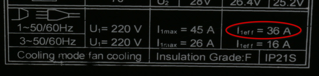

    This unit also runs on three phase, reducing amp draw a considerable amount.
    Max inrush is 45, but actual running is 36 amps at the low end of 220V.

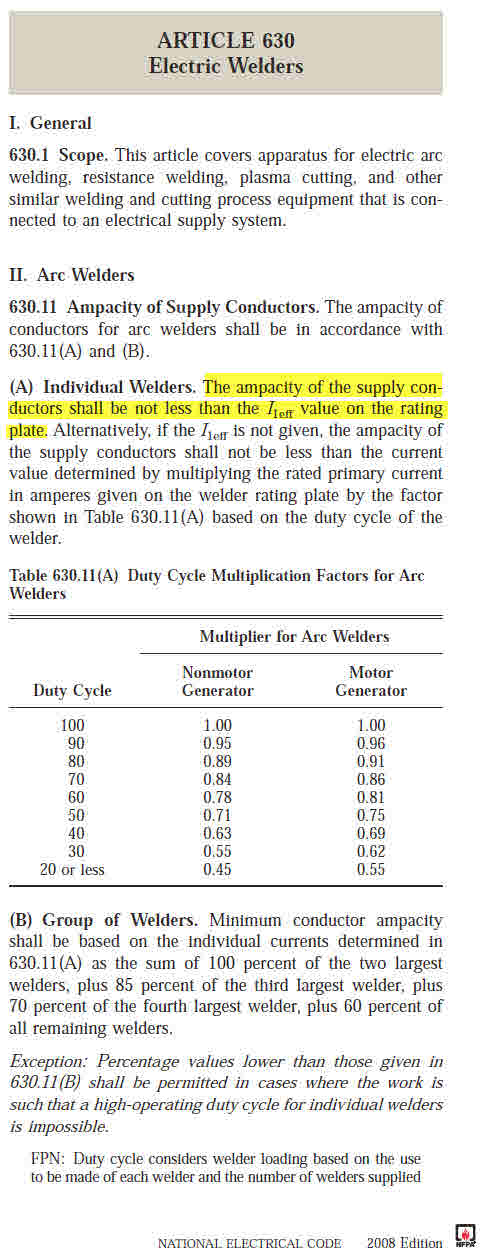

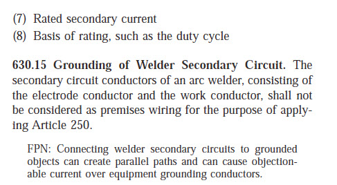

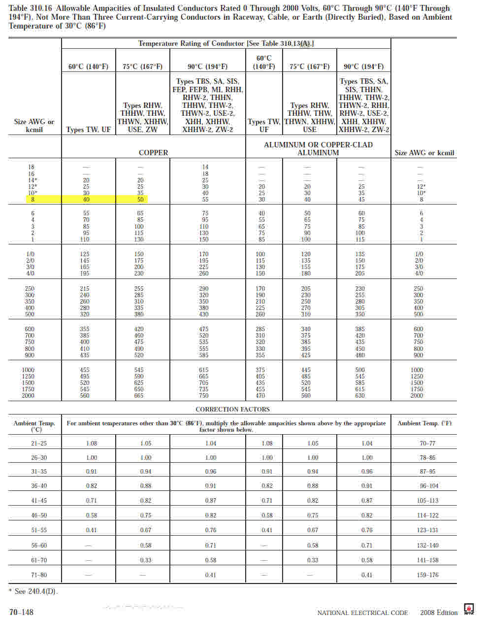

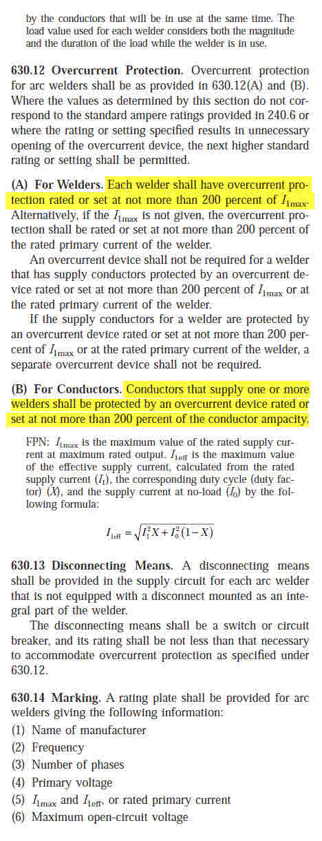

    To size the breaker and wire size for a 250EX you need to refer to the NEC Article 630 Section II. The key numbers are I1eff and I1max, both of which are marked on a label at the back of the 250EX. The I1eff is 36A and the I1max is 45A.
    You need to go into the details of the NEC to determine the actual wire and breaker that you need, but for the 250EX, a #8 wire gauge with a 50A breaker will work very well and will meet code.
