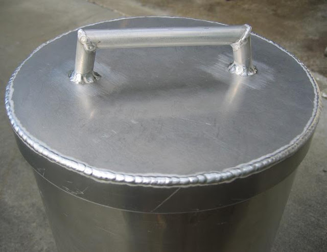

    Hi all - I built from customer's plans a storage container, which is thankfully now completed and delivered.
    Specs:
    10" diameter x 27" tall cylindrical container, with an easily removable, gasketed lid
    welded handle constructed from miter-cut tubing (6061, .065" thick, 5/8" OD)
    5052 aluminum main barrel (.065" thick) and end plates (.080" thick)
    TIG welded with a rock-solid reliable, 3 year old Everlast Super200P and 3/64" 5356 filler rod
    The completed barrel is so strong, with it laid down sideways on the floor, I could stand on the open end without it deforming at all. (The lid would still make a perfect fit afterwards.) That said, the thick, strong barrel was a *real PITA* to form into a cylinder!

    Looks nice Jakeru. I saw it on weldingweb this AM.
    What are they going to store in it? It should be safe in there. How much 5356 did you use on it? I really like the mitered handle look.
    Thanks, Mike. The customers apparently live in a skyscraper apartment building, with two dogs. Big time dog mess issues apparently... going all over their floors and carpets, etc. So, their plan is that they are going to train their dogs to piddle on some specific matts, and then when they are soiled, store them in this container. They were talking about keeping the container filled with water (to "mellow" the soiled matts I guess?) I don't know if they are going to do that or not, because it would make them really heavy (fully filled = 80 lbs water!) and I'm not sure how they'd empty it. They were really adamant from the beginning that the container hold water without leaking, and that the lid and gasket be air tight. I didn't get the whole "high rise condo lifestyle" story about until they picked it up. (Originally, it was just a container for storing "water". ) Anyhow, I hope it works for them.
    I don't know how much 5356 I used, I just kept pulling coils off the spool until all the weld beads were done. I welded the large round weld around the lid in just 3 or 4 welds! It was a perfect joint setup for doing that, so I made sure to have a plenty long length of filler wire ready in my left hand ready to go for those lid beads.

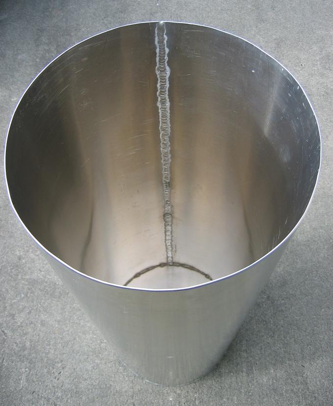

    I welded the inside of the long barrel seam also. That was a bit tricky, reaching deep into the barrel with both hands. That was when my filler rod feeding hand's glove kept wanting to work its way off!
    That can get a little warm. Did you use the short cap or swap our torch out for a smaller one?

    Hey Mike -
    I left my WP-17 torch (the original... everlast supplied) on there with the full length back cap, for the inside cylinder weld. Reached in from one side into the middle with both arms, welded towards the outside. Then flipped the cylinder around, did the same through the other opening (before I welded on the end.) With a small amount of "push" angle on the torch, the back cap was not interfering with anything, but the end of the handle was limiting the range of motion, so I had to hold it "just so". Here it seems like a "flex neck" type torch would have been handy to move the handle into a better position. Or better yet, a CK "Flex-Loc" (I have been kind of salivating over one of those...)
    I usually leave the long back cap on the torch if I don't need to remove it due to an obstruction, because I like having extra parts of the torch I can grab which don't get all that hot. Kind of like an "alternative handle" I also prefer full length tungstens over really short ones. (easier for me to handle, grind, store, find, etc.) But if the welding situation calls for it, I will put on th short back cap and cut up a tungsten without a second thought.
