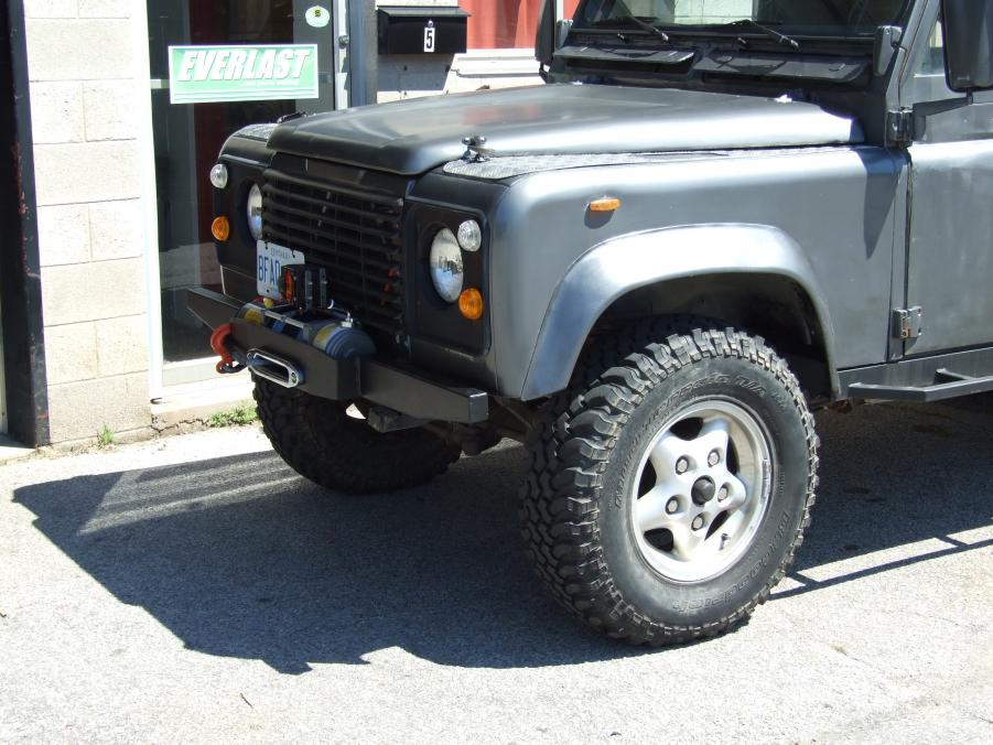

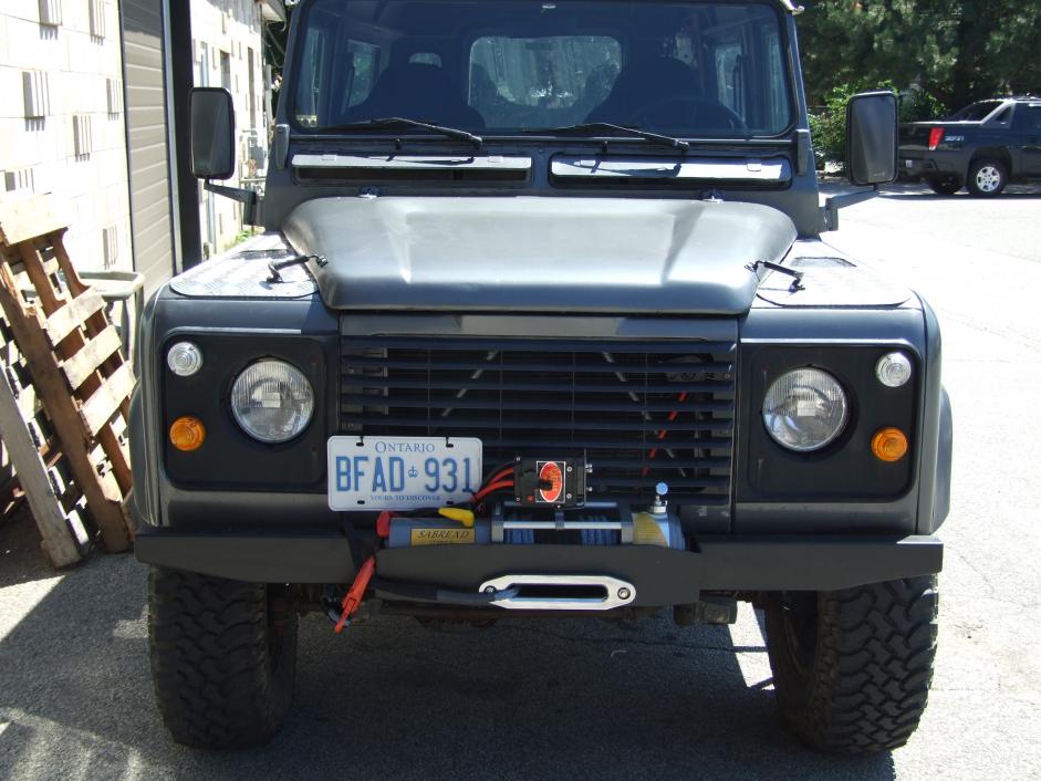

    I Finally got around to fabbing up a new Winch Bumper for the old 110.
    Hopefully i will be able to get some Skid plates made up over the next week or two.

    Nice mount, but shouldn't a bumper be a lil further out to protect the body ?
    My next project is a rear bumper for my Ram, as the factory one was only for show, and a step to get into the bed(a poor one at that).
    I'll probably make it with a extra receiver mount so when I make the front bumper with provisions for a winch I can swap it from front to back.
    You want to keep the Winch as close and as high as possible. The further out the bumper is the less aproach angle you have.

    Nice clean Fab work Duncan! Looks OEM if you will. Don't know much about winching, but it looks fantastic.
    Thanks Trackmaster i generally try to keep things simple for myself and with this Bumper i wanted the strength in the Winch Box to the frames. I may still put a couple of angled Gussets to the wings of the Bumper from the Box section this will keeep the look the same and just add some more strength to the overall bumper.

    nice clean winch bumper alot of people make them huge and hideous

    That is a nice installation, tucked in but still has good access to the spool and cable lays. I like the look and functionality of a close in mount like this, but sometimes it can get too close in.
    I had an 8,000 lb Braden PTO winch on a 68 Chevy half ton. The previous owner had mounted it back in behind the bumper such that the spool was barely visible. All was fine until I got the cable crossed up on the spool (under pressure) What a job trying to pry the cable back out from between the lays while on my back in the mud under the truck!
    After that experience I realized how important it is to have good access to the winch spool from above, and also to have good clearance around the spool so that the cable does not jam on surrounding members should it spool up extra in one area.

    Looks like you took some points from the WARN Rockcrawler for fab on the ends. Nice JOB!
