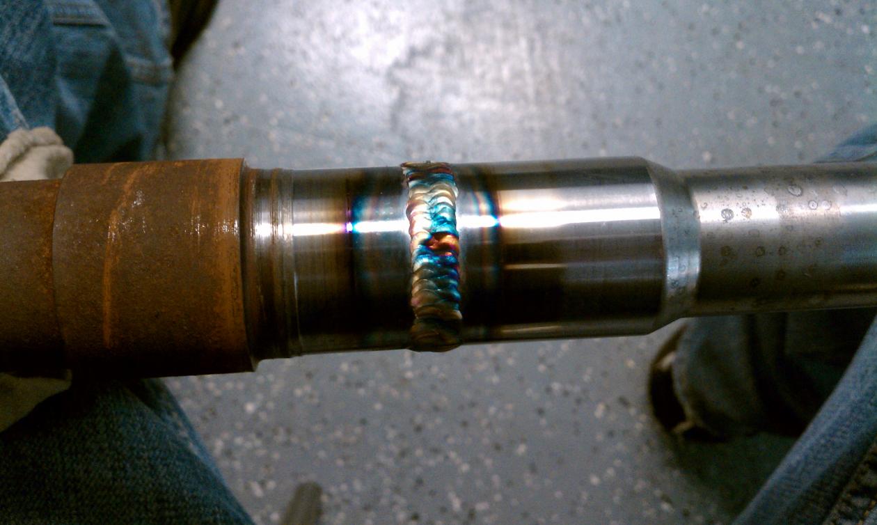

    Hey there, just a pic or so of an internal drive shaft of a large suv's transfer case. It was a two piece shaft with splined interlock. Somehow the splines on one portion stripped probably after a chunk broke off off the shaft. I designed a fixture for welding the 2 halves together, as you can imagine any run out on the straightness of the shaft as a whole, in excess of a couple of thousandth's would be disasterous at RPM. The shafts were hardened steel, with a fairly nice natural bevel. Cleaned with solvent, rinsed, wire brushed and then cleaned with MEK. Root pass, and fill pass done with 308 stainless rod, to be most compatible for the hardened steel. Slow cooled at approximately 300-400 degree's per hour. Tacked in four places, and sequence welded. Finished piece had less than .002 run-out after welding.
    Phew! ...... was a little concerned about that one but got lucky!

    Nice repair job there.Good looking weave there.Do you need to lathe those down do the grease seals will not get damaged ?
    Not sure how that one goes on but Also sucks that you might have to cut off the nice welds..

    Hey thanx Gary, ..... good question! I had that exact consultation with the tech working on that drive train. It's a little hard to see in the photo but i tried hard to keep the build up height to a minimum, but also concerned with retaining as much strength as possible. I advised him to go ahead a grind it down if necessary, but the oil seal ended up sliding quite nicely right over the weld! The root pass was hot, going for some real penetration and spread across the foot of the bevel. The weave was done with out the benifit of a mechanized device so i had to just work manualy around the circumference, welding 1/4-th at a time, opposite each other to try and control any warpage and minimize any undue additional heat input. No cup walking so just tried to keep the weave fairly uniform. Thanx, Lou
