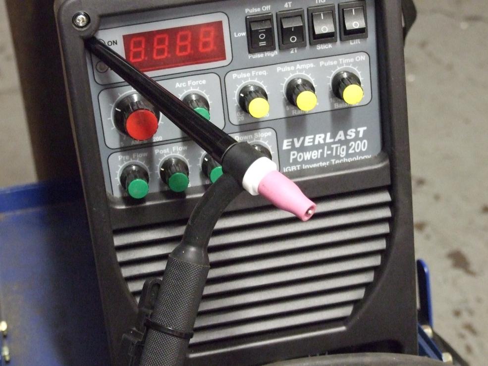

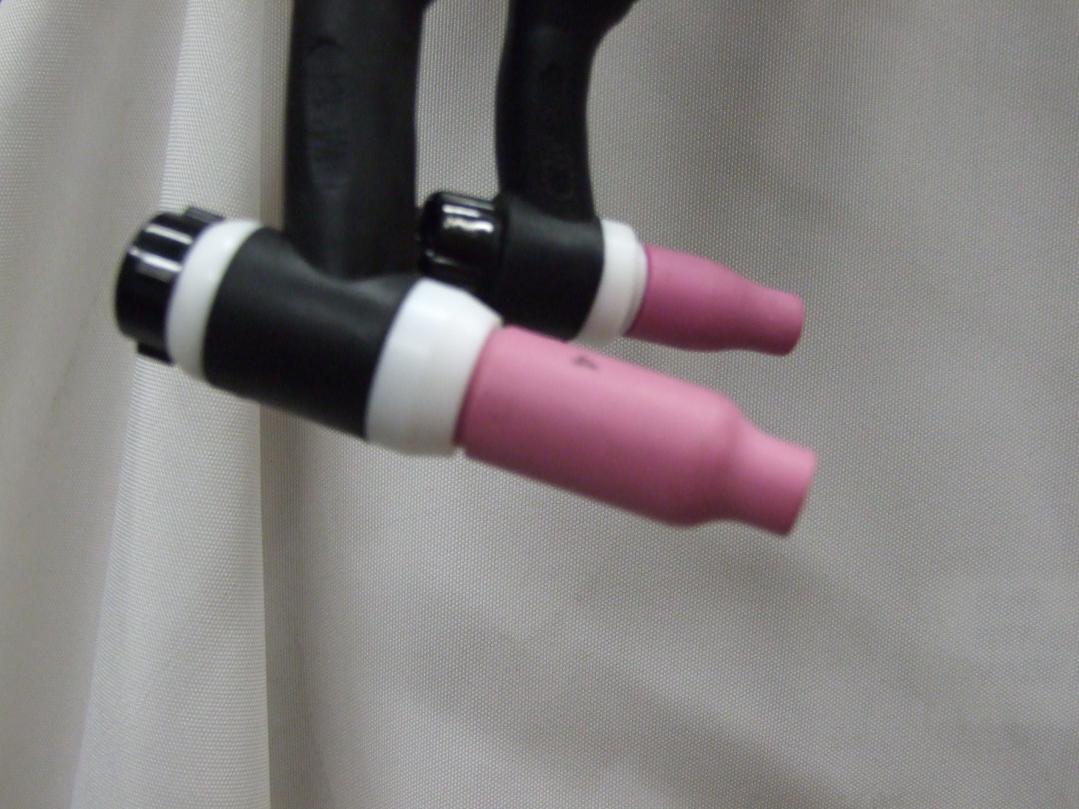

    Started playing around with the sample torches today. I like the small WP9 air cooled Torch . The WP20 is a similar size but has water cooling for a heavier amp load/ Duty Cycle.
    Both torches are Flex necks which perhaps may not appeal to a lot of people but i like the versatility.
    I included switches on all samples and have them run inside the sheathing .
    I am not sure if it may not be better to have the contact wires run outside for ease of removal for people that will mostly use these torches in conjunction with a Foot Control.
    Cheers

    Specking of torch size being a total noob to TIG are all the 17,18,26 size TIG torches the same size. I do know they use the same size consumables.
    I have a 18 water cooled torch, is the 17 smaller? The 17 is air cooled, I would think it would be larger maybe? Are the 9 and 20 series torches larger than the 17, 18 and 26?
    The WP20 is smaller than the WP18 as are the Consumables for the Torch.

    The WP 17 torch is slightly smaller, depending upon the manufacturer.
    That is a lot smaller. Thanks.

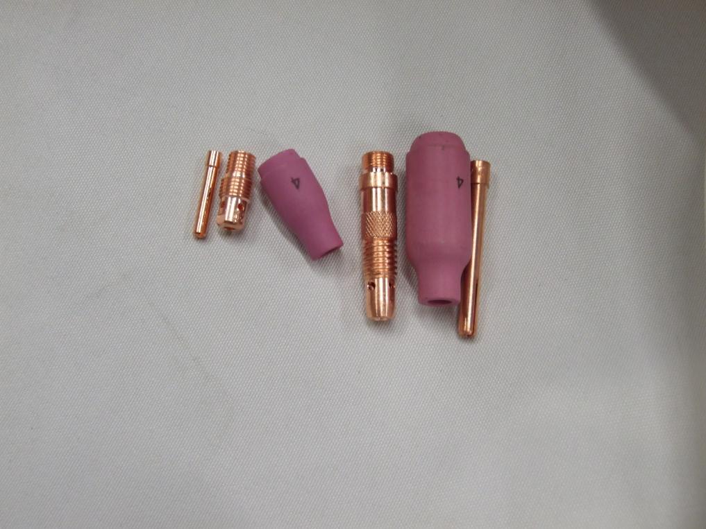

    People could add the short cap like Duncan has there and use it on tight jobs, still use the larger torch with a different sized electrode. Looks nice and small.
    I've seen a few people use a smaller cap, a gas lense, or the cup for one with either scotch brite or some stainless screen, then a really long stick out.

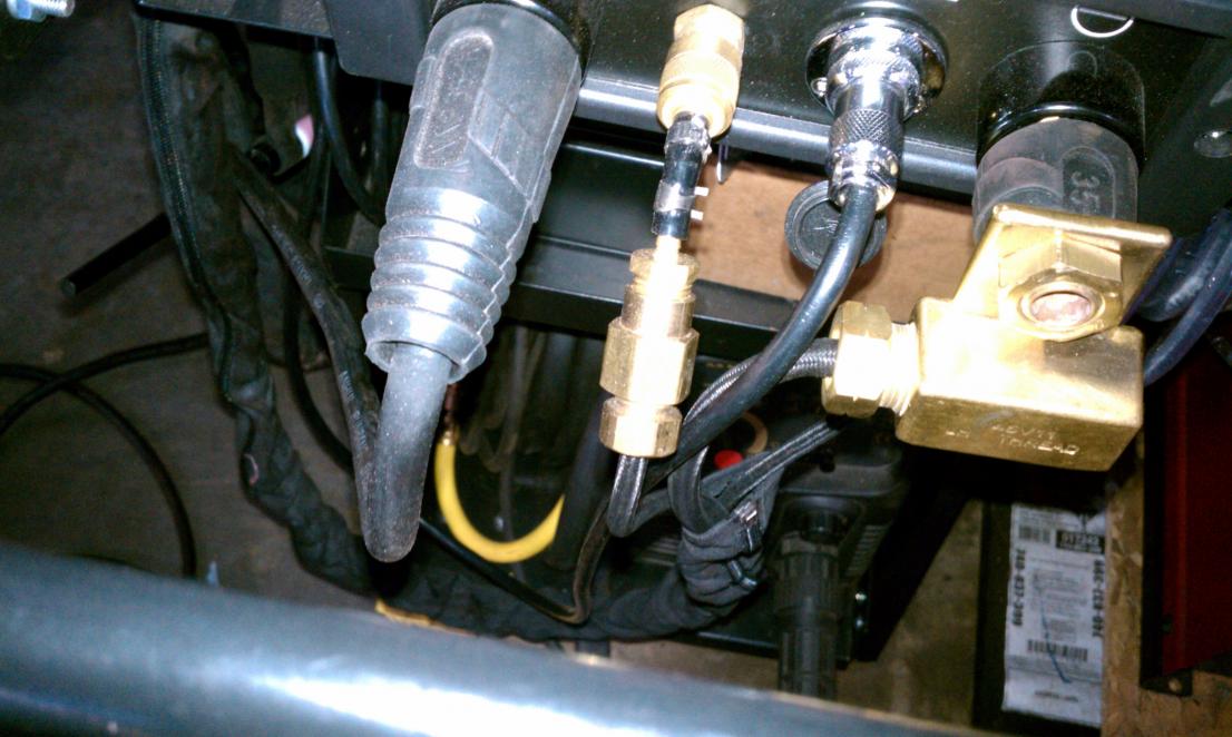

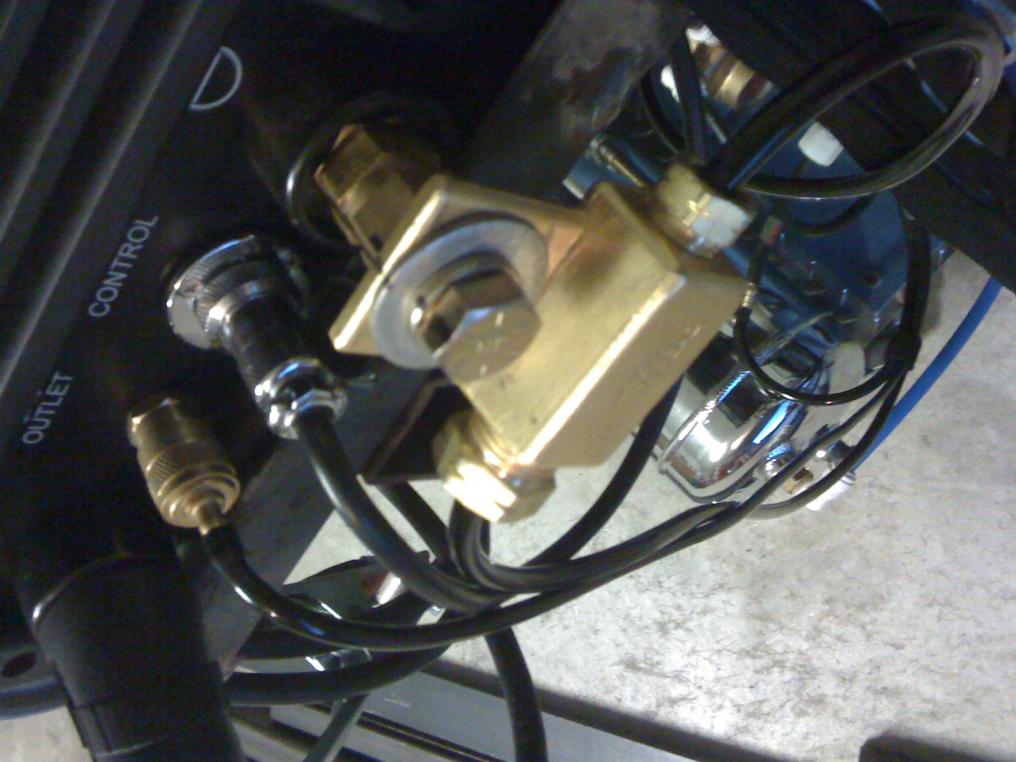

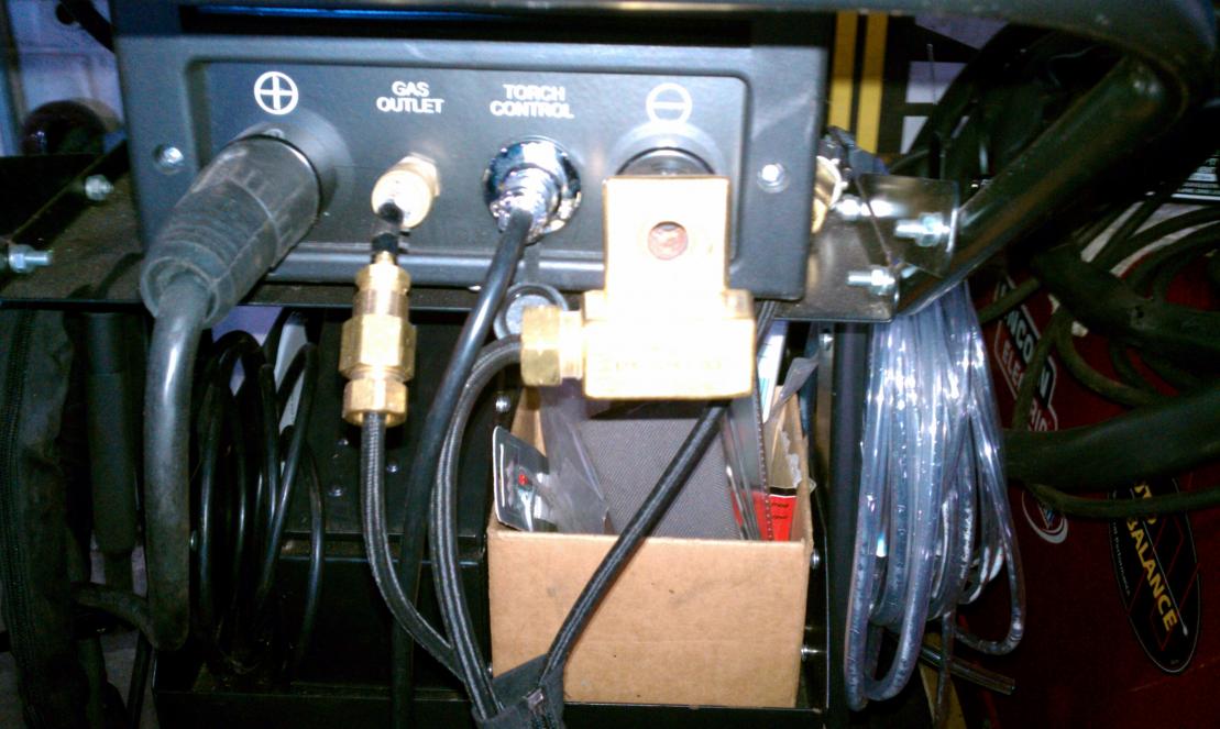

  13. Default 20 series hook-up
    Sorry 2 Rods, got a little tied up, but here are a few pics of one way to hook up an "after market" 20 series water cooled to a Everlast Tig.
    The adapter block is usually sold with the torch. Be aware that it uses left hand threads so that can present a problem with running out to the hardware store, home depot etc. As they will not have the variety of fittings you may need in LH threads. You can do just about anything in regard to stepping up, down, barbs, couplings etc. But for the left hand stuff, you will have to be a little creative and cut off one or more ends off of your new torch, and use the LH threaded fitting in a moddified way. I know this sounds like a pain in the @ss, but it's really pretty easy as you just kind of piece it together.
    Now the the Everlast Tigs use a standard dinse type twist lock connection for the leads. You can do one of two things to do it how i have. #1, sacrafice the torch lead block that came with your welder, ( which is what i did, because i had to get a replacement torch due to shop damage, so i had a spair dinse connector), ..... or #2, go to your local welding supply and buy on the cheap, a Lenco LDA dinse adapter for about $12.95. It has the twist lock required and a short brass body. You will then silver braze or tig if you wish, the block supplied with your new torch to the LDA twist lock. It is purely an electrical connection for all purposes, and mechanical only to the extent that it will hold the block in a fixed position, and i recomend you silver braze it with a 65% silver rod and use flux. To the block you will then be able to connect your 20 series torch's power cable lead, that is also the water RETURN line (the water flows over and around the braided copper wire
    inside the cable as it returns from cooling the torch head). The block you just connected to simply has a passage way thru it from left to right to a smaller female LH thread that continues the water return either to a drain, if your using a hose for your water supply, or to your tig cooler's in line. You will be cutting off the water-to-torch LH coupling and barb, ...... use those to go into the dinse block for your water return.
    Ifyou are using a hose (city water), then get at the the hardware store of your choice a hose connector fitting and reverse engineer it back to a 3/16 barb that you will insert into the water-to-torch line. If your using a dedicated cooler, just do the same thing but adapt it to the coolers output fitting, ... still with me? Good, .... sounds like more than it is, you'll see.
    Got it so far? No problem! Now the gas line to the torch. The 20 series torches come with the gas line in standard RH thread 3/8in fip male end, so just get a 3/8 female to 3/16 barb and use about a inch and a half sacraficial piece of hosing and conect it right to the quick connect barb that came with the everlast welder. Thats it! Really a lot simpler than it sounds in text! Included a few pics to give ya a visual. There are other ways to skin the same cat tho too!

    Lou : I looked at you pics of the stock dinse you modified for the torch .Is this complete ?looks like your missing a water line. I followed your idea but I gota flow tru block is that what your is .(pics don't show that )

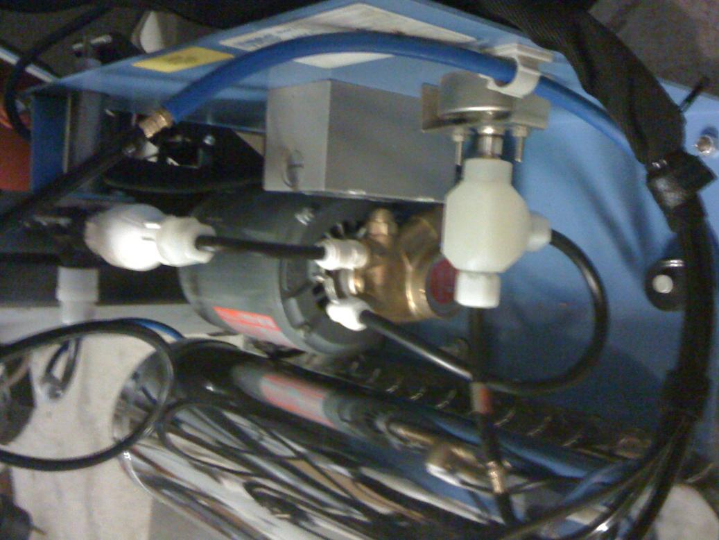

    Default wp 20 dinse
    Lou: Here is what I did.

    Your absolutely right Doug, .... apologies, .. I took the pics without the other side hooked up. Sorry bout that, I kept forgetting to take some pics and post so I kinda rushed off half cocked to get something on the site. Looks like ya did a nice clean Job tho!! Same flow thru block. Did you fab your cooler or is that a commercial unit? Looks like an OEM type pump? - Lou
