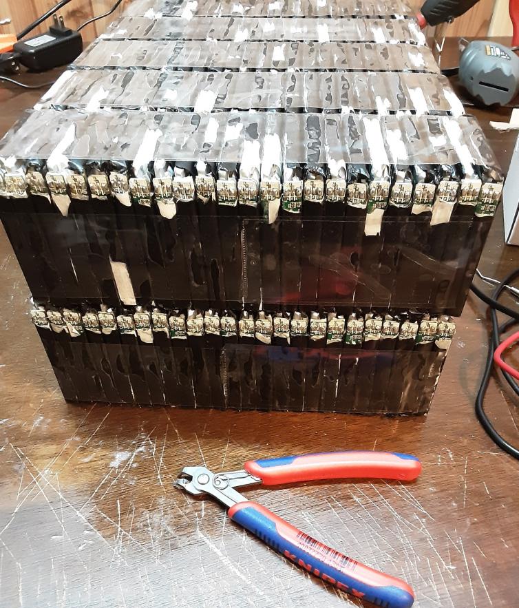

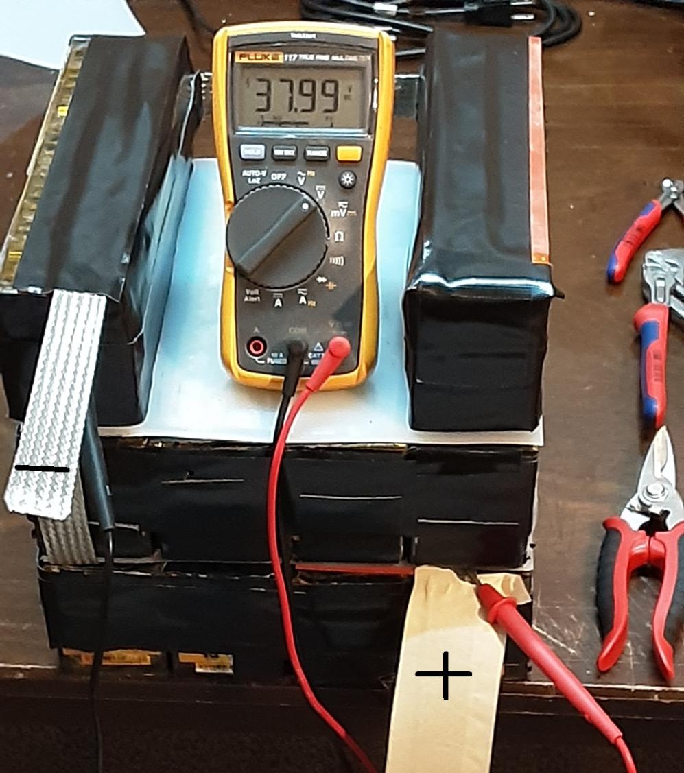

    I've built lots of lithium battery packs but I tend to use Li-Po cells from medical equipment for their higher energy density and solder connections.

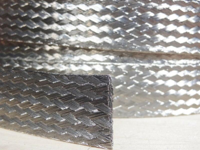

    Here's a 110ah 36v nominal pack I built to power my trolling motor 42v - 30v. It measures 9"x9"x9" without it's aluminum case. Each of the 250 cells have a 4amp bms and are rated 4.4ah from 3-4v. The strap I use as a buss bar is rated for 105a.
