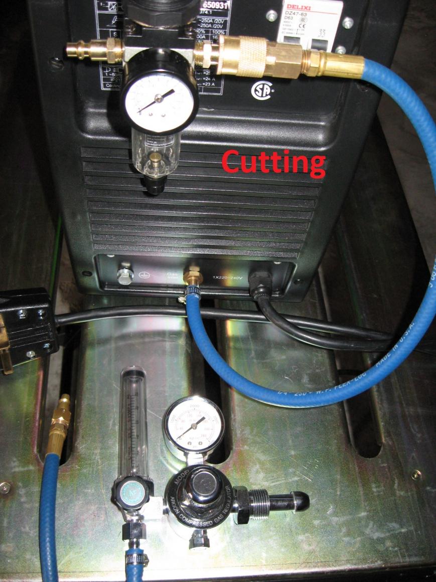

    If you're feeding the pressure regulator on the welder with 80psi you should be able to maintain 60psi at the torch. You could bump the line pressure to 85psi if need be.
    I don't have any problems with the pp256 or the pp60 running QCs from a 100' hose reel.

    I`ve got the same set up as Zoama. no problem so far and the nice part is if i have to move the machine for cutting to another building or location i don`t have to lug around the argon regulator, with the yap style you would have to.

    I agree on the moisture issue. Good quality air hose fittings will work as long as you put the fittings on in the proper order. Male directly on the back of your unit and female on the hoses. Either leave the compressed air regulator connected from the outlet to the rear of the machine or cap the inlet at end of use. This will ensure no contamination and should eliminate any moisture issues. After doing a lot of reading, this was the setup I put on my 205SI and works well. Great machine

    There is absolutely no issues using a Quick connect in regards to having moisture enter the lines. After all we are talking a Multi -Process unit that uses compressed air . As the plasma and tig function share the same lines / solenoid you are introducing a lot higher percentage of moisture in the system even with a Dryer inline than simply connecting and disconnecting a Quick release .
    Zoama's set up is nice clean and simple
