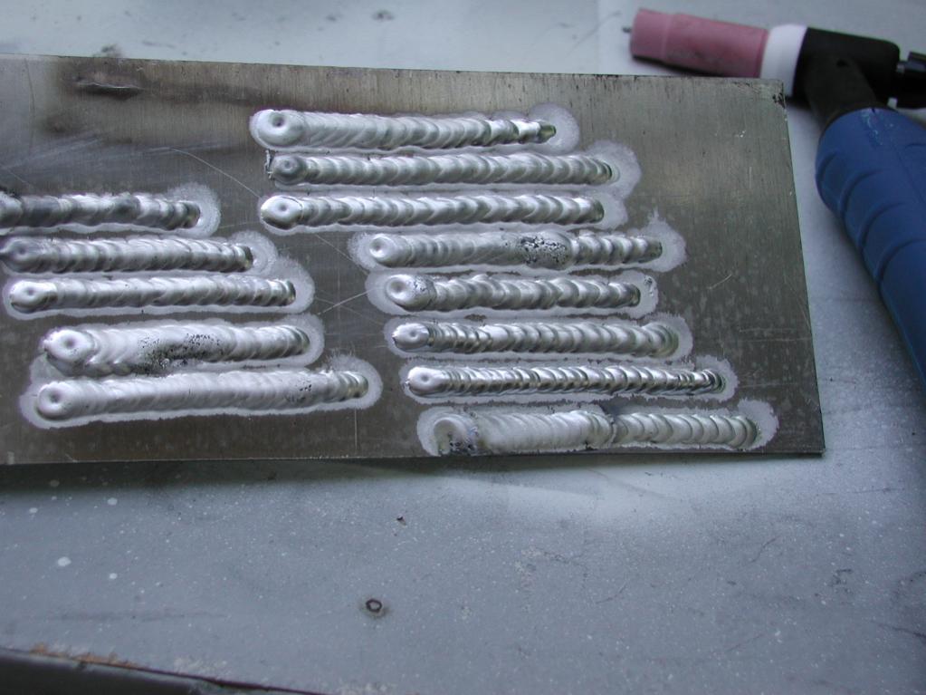

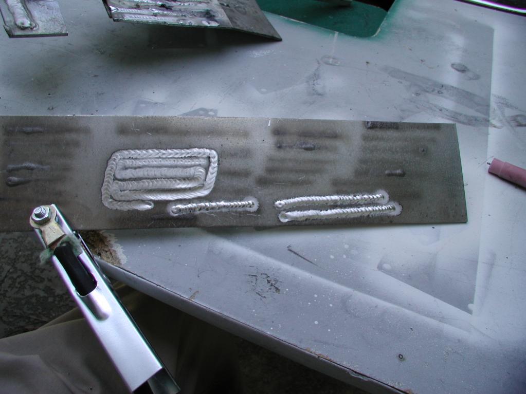

    Well I had a chance to weld up some .250 aluminum plates today ,, the machine is awsome I have to say..I played with the 2T 4T and pulse for about 6 or 8 rods of 5356 and the problem that I was having after 10 minutes of welding was remembering the difference between the AC freq and Pulse Freq I think I am going to stick a post it note on there until I can remember that AC freq is AC FREQ that effects arc timing and Pulse Freq is the pulses percent in TIME not freq..I just kept thinking AC freq and would adjust the wrong knob.. so some welds got messy.. And also I cant believe the difference in welding amps between the Miller Diversion and this unit..I would have the miller turned all the way up and take 5 seconds to get a puddle and the 256 at 130 amps was puddling the .250 aluminum within a second and a half..Then turning off pulse was a totally differnt monster..
    I will throw up some practice pics but will be hard to tell what my setting where because I was all over the place and had 5 diffent setting when welding these few pieces today but the one inch or so real smooth weld was with no pulse , some where 2T and 4T. The metal was kinda of clean so I had ac cleaning all the way down and still does a fine job,The etching is a little deaper than I would like but it cleans the crap out of the weld puddle in a heartbeat..
    Here are a few pics:
    Gary

    Thanks for your time in posting on the AC/aluminum mode, I have had a couple of recent tech calls I sent to the forum to read your information.
    It's sometime easier for people to see the panel and read, and saves me time setting their knobs by phone.
    The welds look strong.

    I also had to swap out my argon in the middle as well , you can see the black marks , that bottle got sucked dry . Didnt realize it was going dry until it burned up an electrode
    What I would suggest people to do is set the welder right next to them so they can make adjusts without getting up and down , today I had mine just off to my right so I just had to reach over and turn a knob.Thats why all of the welds look a little different I think I did an inch or so and then make a change just to see what would happen..
    But I am getting used to it and actually love being able to make all of the changes with the turn of a knob . just takes getting used to what does what..
    Gary
