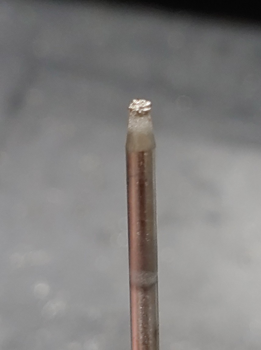

    I'm putting this out there to see if anyone else has ever experienced it. Once I started welding more aluminum, and moderately thick aluminum (3/16 - 1/4 plate), I noticed that my 3/32 tungsten would form a cluster of tiny balls on the end instead of a small, clean ball. I have tried ceriated, 2% Lanthanated, 1.5% Lanthanated, and multi-mix. At higher amperages above 150amps, they all do the same thing, but the 1.5% Lanthanated seems to hold up slightly better despite some deformation.
    For years I had used Miller Dynasty welders while welding exactly the same materials in exactly the same method, and I have always had good results from any and all tungsten except 2% thoriated or pure tungsten.
    I first noticed the problem with my 210EXT and thought for sure there was an internal issue causing it. I currently have a Return Authorization, but I have waited for my new 325EXT to arrive so I could do further side by side experimentation. I found that the 325EXT does the same thing to tungsten at the higher amperages, although the welds are much cleaner than the 210EXT, which I am still troubleshooting that problem.
    For the past two days I have been welding thinner aluminum (.063) at lower (100 amp) amperage with the 325EXT and I have had no problem and the welds are beautiful. The tungsten has remained in perfect condition the whole time. Tomorrow I will hook up the 210EXT and try it with the same material.
    Is it possible that the Everlast Inverter machines are just harder on tungsten at a given amperage? I don't know what else to think at this point. Do I actually have to use 1/8 tungsten to weld 3/16 aluminum? I have never had to in the past with other inverter machines.
    I have attached a couple of photos of the tungsten condition that I am talking about. Not the greatest pictures, but if you can zoom in, you should be able to see the disfigure ends.
    Any input or thoughts are welcome.
    Thanks!

    First, 3/32 has a limit of about 160 to 180A. The balling and nodules form from overheating. Yes, the square wave we use has a fast wet in and it has a more sharp shouldered design and it's a little different on the 325 from my understanding. But you are in 1/8" territory. Personally if I go over 150A, I switch over to 1/8".

    Sorry, it's been a bit since I followed up on this issue. I have since tried 1/8" tungsten (1.5% Lanthanated) and I continue to have the same results. The end of the tungsten never obtains a smooth ball surface, instead, it ends up with tiny balls all over the end. I never set my balance above 30, and I typically run 25 - 28. Also, if I try different wave shapes, such as Triangular or Sine, the amperage is significantly lower than in Advanced Square setting. Not sure if this is normal. This applies to my 210EXT as well as 325EXT.
    Don't ball to begin with. What you are experiencing is nodules. This can do with tungsten contamination from the metal, or with tungsten quality itself, even grinding angle and grind quality. The difference in Amperage is that the meter is calibrated to Advanced Square wave. Since the wave form is different, it reads differently even though it does reach the same level. The shape of the wave form of each is actually cooler because less time is spent at the max part of the sine wave.

    Sorry for posting on an old thread, but I've been dealing with the same issue with my 210ext since I bought it a couple of years ago. I was so excited to find this post showing exactly the issue I've been experiencing with my tungsten.
    I've tried blue, chartreuse, and purple tungsten, 3/32 to 1/8. I grind parallel to the tip with a dedicated diamond wheel and have tried multiple wheels. I've tried a gas lens and standard collet bodies, 5 to 8 cups. I've verified the gas flow CFH at the torch with a flowmeter is 2x the cup size + 2, so if I'm running a 5 cup, I'm running 12 CFH. I've tried 20 to 40 for the balance. I've varied the frequency from 60 to 120. 1 sec pre flow and 10 post. Multiple argon bottles. I'm also welding at higher amperages, so I can't really say if it looks better at lower amperages.

    What brand are you using? Quality is one factor. We see a lot of bad "batches" and variation from pack to pack, and brand to brand. Turns out quality isn't strictly controlled if you read the fine print on the documentation. Additionally, higher ranges will do that to them. Here's an article that may help: https://www.thefabricator.com/thefab...right-tungsten
    But overheating tungsten, which happens at lower amperages on an inverter will cause it as well.

    Thanks for the article. Midwest and ck Lazer. As I mentioned, I tried several types and thickness of tungsten. Always get nodules, just varying degrees.
