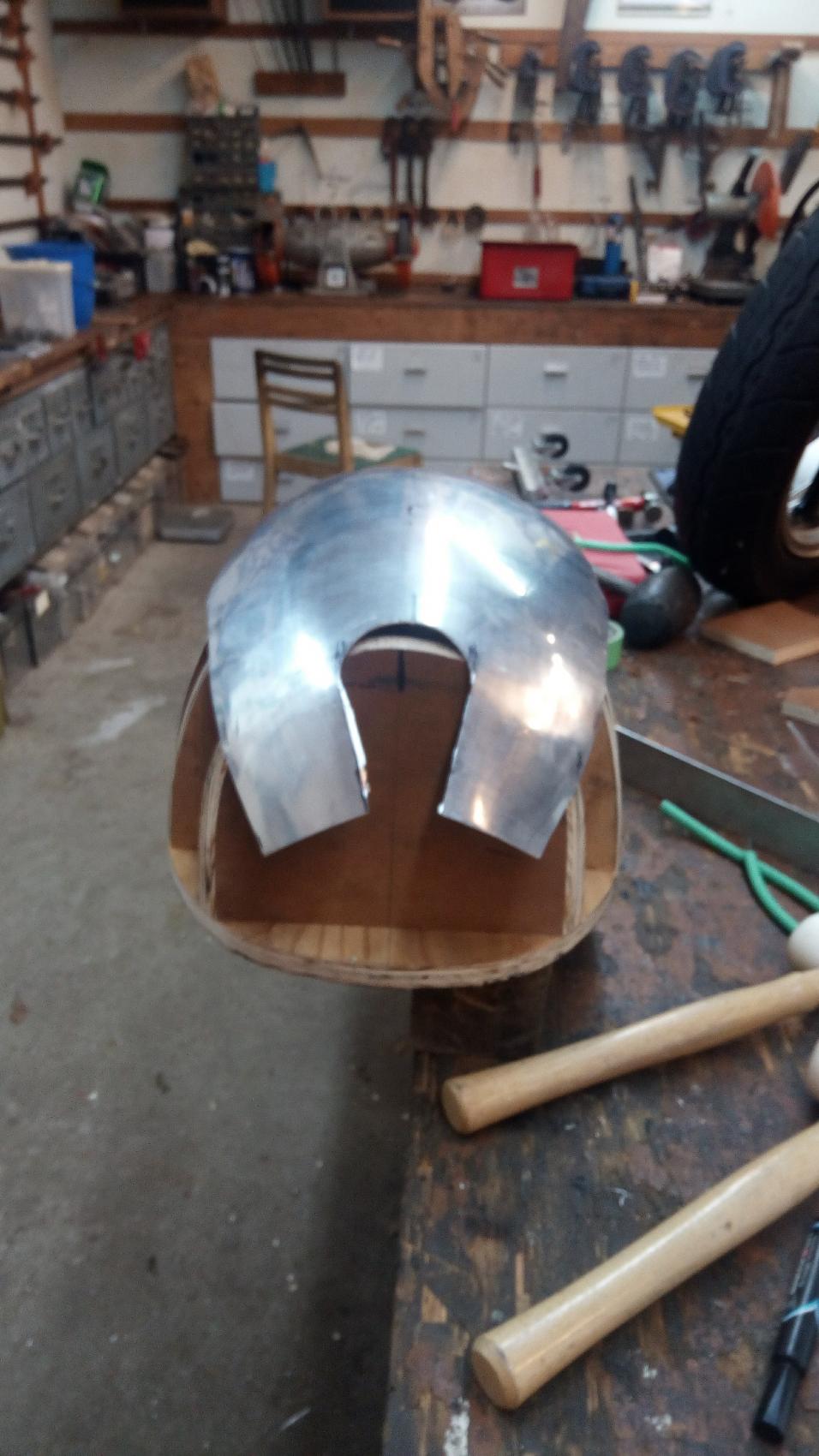

    I recently built this tank for a Norton project bike. The plan is to use a Triumph Thruxton fairing at front, so the fuel tank top skin had to match a Thruxton R shape. The bottom has to be made to fit the Norton Commando.
    I have a Thruxton R so it wasn't too difficult to copy the shapes and come up with a wooden buck to build from.

    Starting in to shape the sides and topClick image for larger version.

    The red tank is on my Thruxton R. It holds 14.5 litres, not much more than a Commando Roadster tank (12litres).
    I wanted a bit more capacity so the buck was made with an extra inch of height vs the Thruxton tank.
    The goal was 18 litres minimum capacity.
    The end result is 22 litres. I picked up a lot of volume in the tank bottom shape, mostly in the cutout for the frame tube.
    Here are some more progress photos.Click image for larger version.

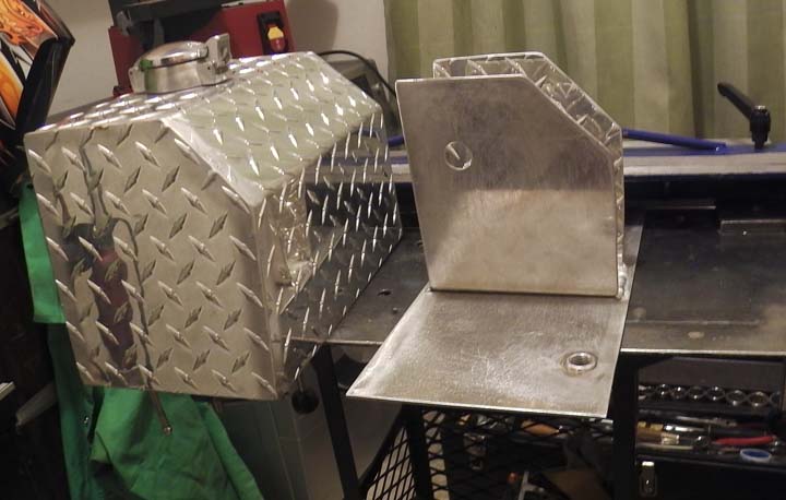

    I did an aluminum gas tank for a zero-turn mower a few years ago. I went to an electric fuel pump on it, rather than gravity-feed, as the location was then much different. And, of course, diamond plate is a favorite material of mine, even before I got the AC TIG welder for aluminum.

    That tank was about my first significant project doing AC TIG on aluminum. And, I chose a flip-top cap reminiscent of the one on that Norton, and is also similar to one on a Triumph TR6 car (interestingly, a 1971 too) that was my first car as a teenager. It was cast aluminum, so it was a little nasty getting a pass or two of clean bead on it. And I welded it on the underside, rather than a fillet up top.

    Anyway, this tank ended up at 2.7 gallons, and the OEM poly tank was 2.2, which was a fitting increase since the mower also got a motor repower from a single 12.5 HP to a twin 20 HP.
