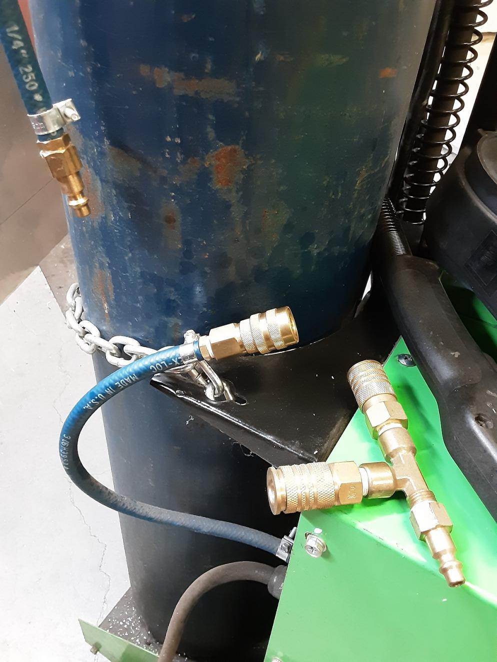

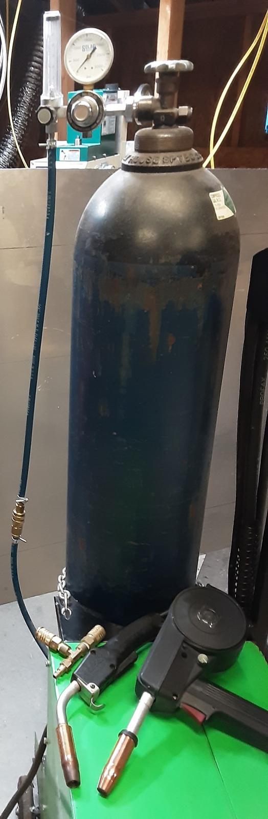

    If you have a 75/25 tank, plus a pure argon tank and two regulators you can mix the two through a tee or wye to get the percentage of co2 you want.Click image for larger version.
