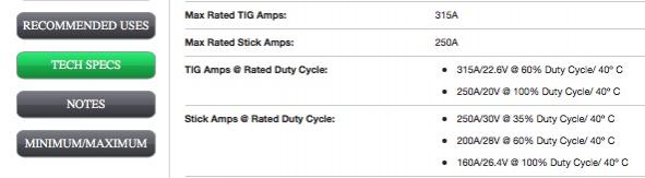

    You're not going to find any brand of inverter 200 amp TIG machine with 100% duty-cycle at max amps.
    The Everlast 315LX is 100% duty-cycle at 250 amps, which represents a duty-cycle value that even some higher amp Miller Dynasty's can't match, on single-phase, unless you step up to around five times the price, e.g., the Dynasty 280 is only 25% duty-cycle at 280 amps, so maybe a Dynasty 400 or 700 could match the 100% duty-cycle of the Everlast 315LX at 250 amps.
    But, of course, the 315LX is only $1999.
    So, I'll recommend looking at higher amperage TIG units, in order to get 100% duty-cycle at 200 or more amps. You'll undoubtedly want a water cooler too.

    I challenge the person to weld at 210 amps continuously for 10 minutes without what seems like a need for a fire suit. You will self combust at that level of heat imho without some serious protection. I can tell you that most people waaaayyy overestimate their need for duty cycle. Next on the list would be the 255EXT. If you are welding at less than that, duty cycle increases.
