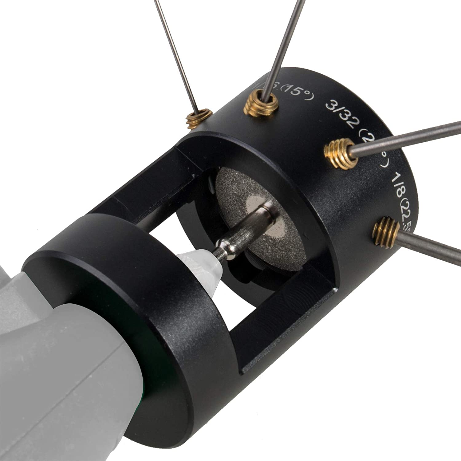

    OK,
    The old method or mentality of balling a "Green" tungsten (with increased AC Balance, briefly changing polarity, or adding amperage) for welding on aluminum with a transformer unit, I think, is a needless holdover when it comes to an inverter machine on aluminum AC welding.
    I think a 1/16" diameter tungsten is small enough that the degree of taper is not so critical, and truncating the tip probably isn't either. But, of course, do as you like. I sometimes do truncate the tip on a 3/32". My dedicated tungsten grinder fixture head (fitted to a Dremel tool) has a semi-fixed angle for the taper, even though it's easy to change it, either way, if I want. I think it's set to 20 degrees for the 3/32' collet right now.
    So, that's what I use for my tungsten prep, AC or DC, with a 3/32. electrode. And if the tungsten tends to start balling on its own, or loses its taper after a while, I'll usually resharpen it then.
    The grinding head that I have, by default, seems to use longer tapers for the smaller diameter tungstens. But, 20 to 30 degrees is all good to me.
    And I never chuck-up the tungsten in a cordless drill like some people do while grinding the tungsten on a belt sander or flap disc, as that could put needless horizontal or diagonal striations in the taper.
