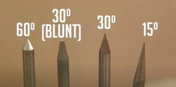

    I am getting back into welding after 11 years of QC and R&D work with GMAW. Its been many moons since I hit a real lick welding aluminum. I picked up a 255 Ext and so far am impressed with the current DC only use. I have been attempting to run some 1/16th Tungsten and get erratic results with it "balling" up. I initially had some that were sharpened way to sharp and backed off to a 30 degree prep and a blunted point.

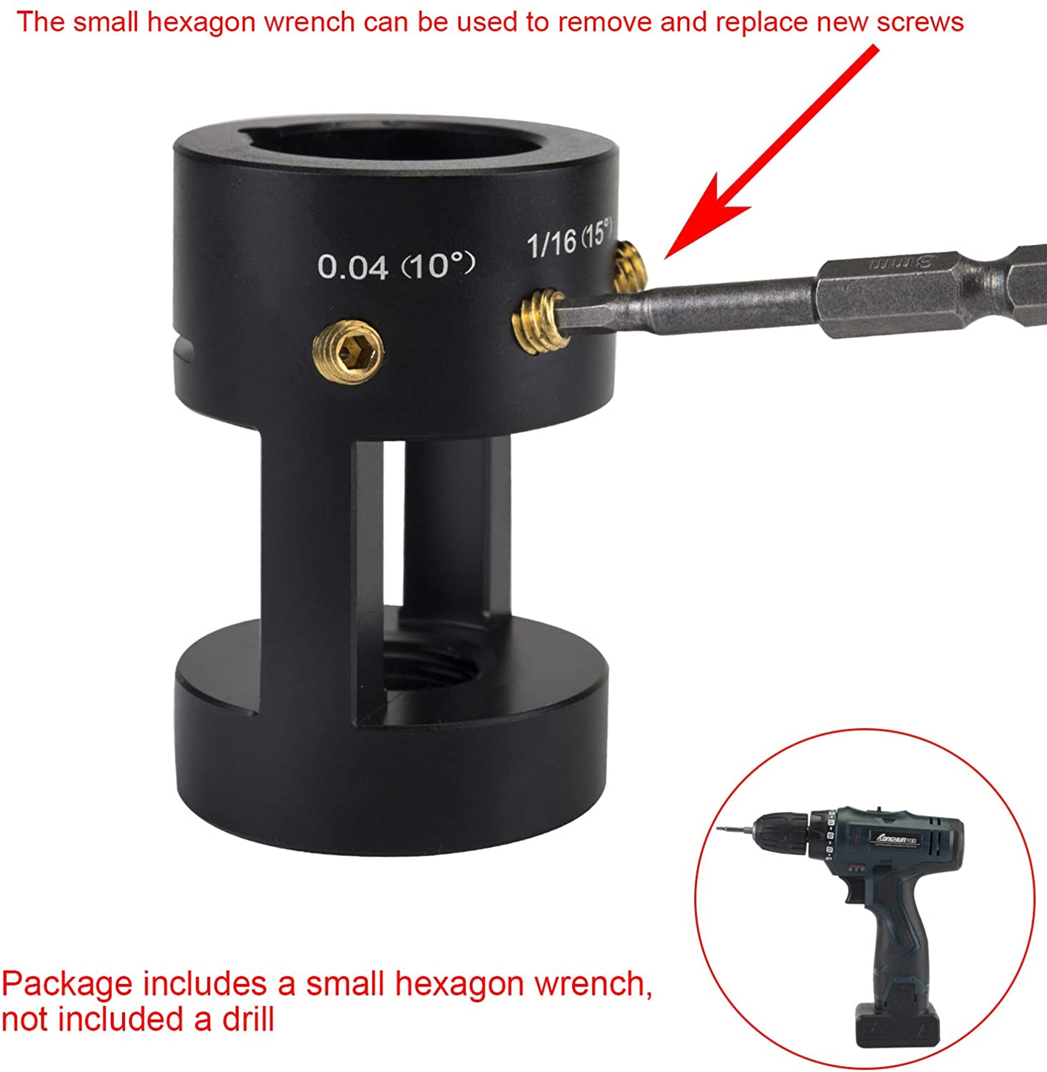

    The old method or mentality of balling a "Green" tungsten (with increased AC Balance, briefly changing polarity, or adding amperage) for welding on aluminum with a transformer unit, I think, is a needless holdover when it comes to an inverter machine on aluminum AC welding.
    I think a 1/16" diameter tungsten is small enough that the degree of taper is not so critical, and truncating the tip probably isn't either. But, of course, do as you like. I sometimes do truncate the tip on a 3/32". My dedicated tungsten grinder fixture head (fitted to a Dremel tool) has a semi-fixed angle for the taper, even though it's easy to change it, either way, if I want. I think it's set to 20 degrees for the 3/32' collet right now.
    So, that's what I use for my tungsten prep, AC or DC, with a 3/32. electrode. And if the tungsten tends to start balling on its own, or loses its taper after a while, I'll usually resharpen it then.
    The grinding head that I have, by default, seems to use longer tapers for the smaller diameter tungstens. But, 20 to 30 degrees is all good to me.
    And I never chuck-up the tungsten in a cordless drill like some people do while grinding the tungsten on a belt sander or flap disc, as that could put needless horizontal or diagonal striations in the taper.

    Your setting seems fine, but I'll recommend that you start with any taper, and resharpen after the tip gets balled like that.

    I'd taper it. Don't worry about blunt end. Make it sharp. It will dome itself over that way and provide a better point that if it were blunted.
    Thank you.
    Suggested angle? Right now I have them at 30 degrees with a blunt.
    The grind length should be 2 to 3 times the tungsten diamter. Don't get super concerned about the angle.
