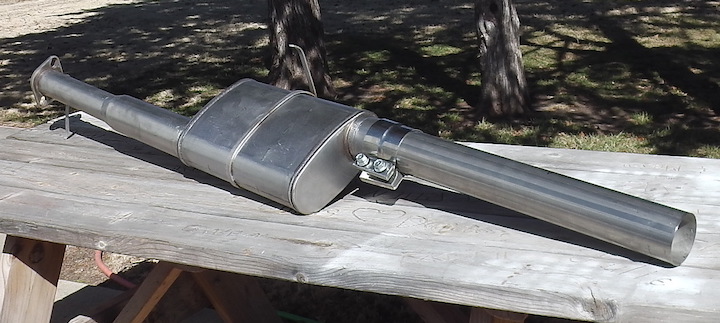

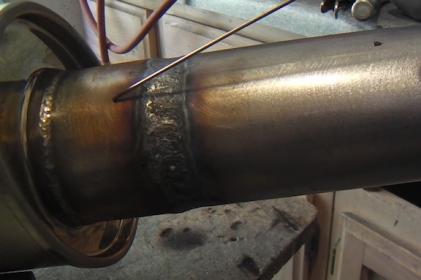

    Step down to an .045 or even a .035 Dia filler material. I find when welding stainless tube that 80 amps is a little hot. I use the 1 amp per .001 rule and with stainless 60 amps can be too hot for making square butt welds. Make sure all your fits are as square cut and completed butted up as possible. NO GAPS.
