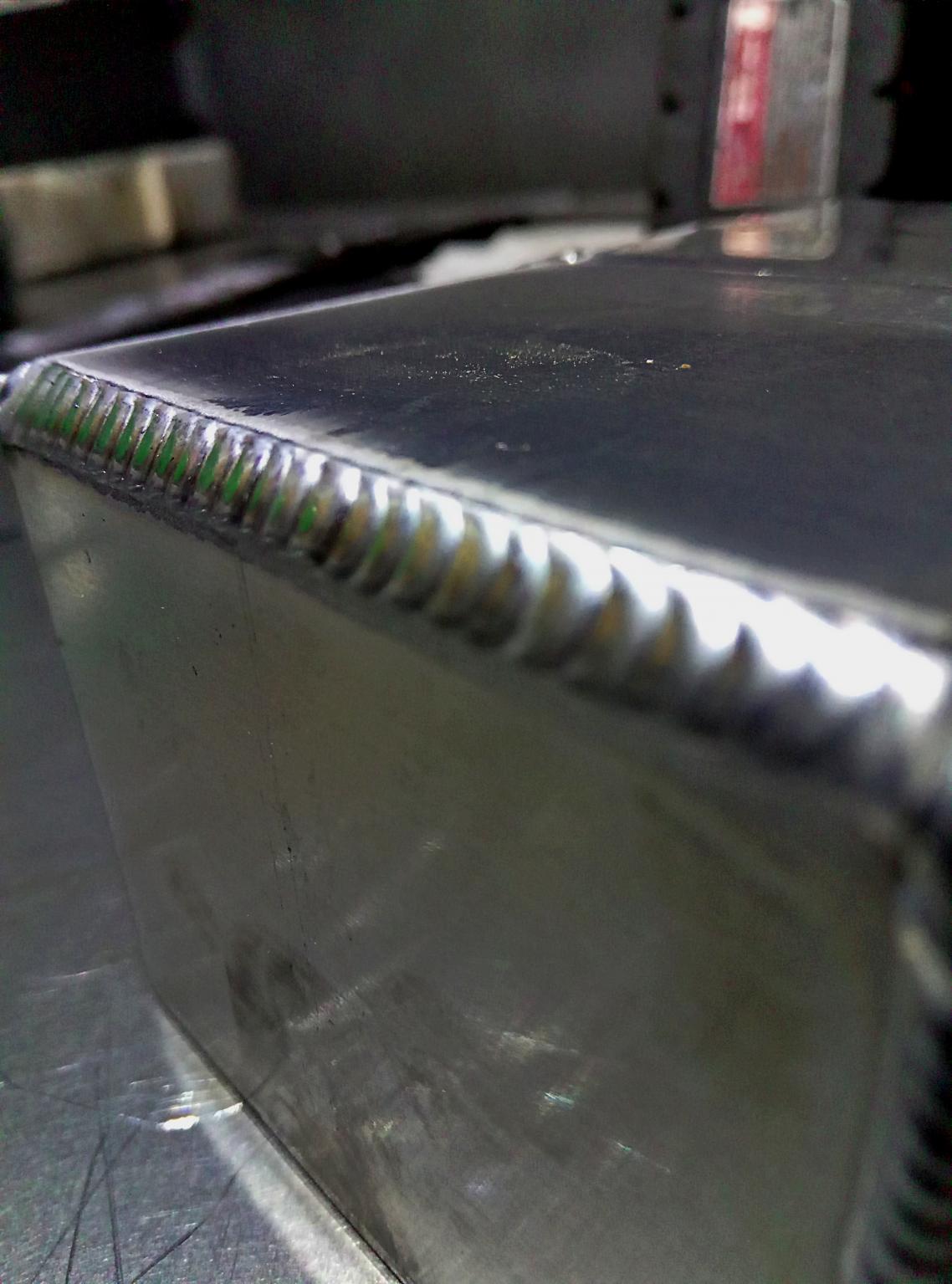

    allright ,
    so i was able to do more test on the machine , turn out im a complete goof ball ( as i was hoping ) .much cfh , enough post flow to keep your tungsten clean ( i mean keep your tungsten clean ) and enough amp to get a quick puddle. i didnt know how peculiar an AC arc was at lower amp , everytime i welded aluminium with other machine was 150 amp and up so i guess the higher amperage help clean up any mess that is on your tungsten. so i think the main mistake i did was not taking care enough of my tungsten and not running enough amp for the material thickness. so now machine is running awesome heres some pic i did today , im really stoked to be able to practice aluminium on 120v outlet. sorry about all this, i think a was too excited to get the machine running the first time and didnt take care about the basic stuff. thanks a lot all for the support !Click image for larger version.
ID:	13976Click image for larger version.
    Nice,
    You're going now.
    Everlast dual-voltage units do very well on 120V power.
    My 210EXT does 125 amps (maybe more) on a 20 amp breaker at an unattached garage that has no 220/240V.
