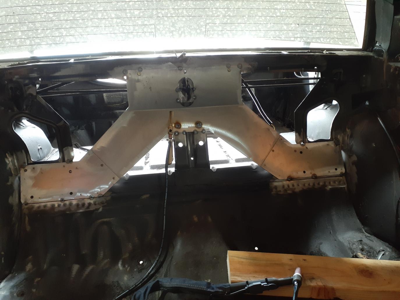

    Thanks for the reply Christian. I changed the cup to a #7 and using 3/32 Tungsten and things are going well on metal thats 1/8in thick or more. I am getting better. Issue is thin metal like automotive stuff. I am either burning through it or when I lower amps it doesnt start a puddle. I am hoping to tig weld a 14ga thick steel brace to 16ga steel. So I am playing with the amperage , any tips on this would be grateful.

    I spotted welded the brace in place. Went very smooth but scared #### to starting rolling beads down.

    Gee,
    That looks great.
    Try just putting more tacks by jumping around a lot, and giving little cooling periods often, until you've got tacks at about each 1" or 3/4", which may give enough extra metal deposition to prevent the tendency to burn through or keyhole too much, for an actual bead length.
    Then you'll know if you can pull off a semi-continuous seam for a few inches, and if a pulse or back-stepping is called for.
    Otherwise, a series of contiguous-looking tacks is an actual technique for body work, even though I've never had a need or opportunity to do any.

    Also,
    After some quick practice pieces, you could use a combination of a lay-wire technique and a slow pulse, by doubling your amperage and setting Pulse to 1 Hz (pulse per second), 50% Time On, and 50% Background/Base current. The filler wire laid along the lap weld would help keep the edge from key holing away a bit, and the 1Hz pulse would give a nice TIG bead appearance without having to be too worried about hand coordination of the filler rod.
    Or, you could try a higher speed Pulse, and fill normally by dabbing, at that same higher amperage, which will average down to wherever you're at without Pulse, setting to about 50Hz (pulses per second), 50% Time On, and 50% Background current.
