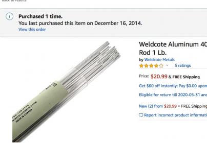

    Otherwise, I most often buy Weldcote filler in 1lb clear plastic tubes, usually 1/6" and 3/32". I've got 4043, 5356, and the newer 4943, which has a damned State patent on it by Hobart (making it more costly, a mini-monopoly, and trickier to find). Of course, filler rod is cheaper per pound when you buy in larger amounts.
    I buy online via Amazon, most times, as it's usually free shipping and no State sales tax paid, since Weldfabulous is the seller on Amazon, not Amazon itself.

    I like those clear plastic tubes, which just cling to the side of my welding cart/cabinent with a bungie cord. And I can easily see the color and sizes of filler.
    That 4943 seems to have previously only been able to be gotten in 10 lb boxes though. And I now use it as my default or go-to filler for aluminum, since it seems as good or better than 5356, and easily better than 4043 too, to me.
