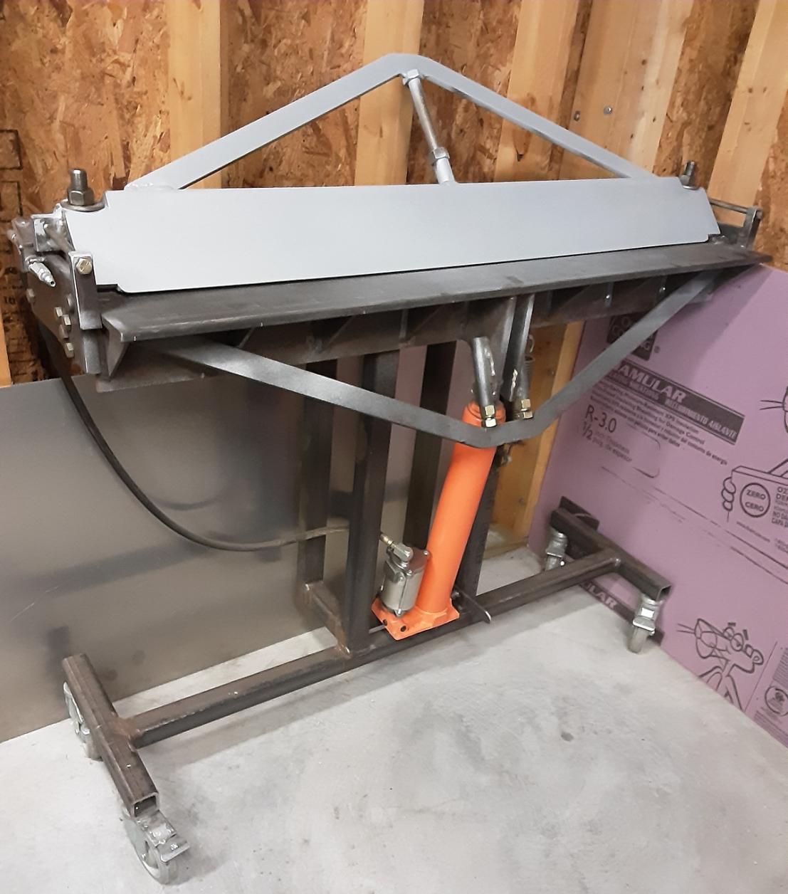

    Went rummaging through the drops at my local metal supplier and made this 50" air/hydraulic brake that can bend 11ga steel on a tight radius it's full width. I added an 8 ton air/hydraulic ram from harbor freight to make bending effortless.
    I built it years ago and it still works awesome.
Name:	50 inch brake -.jpg

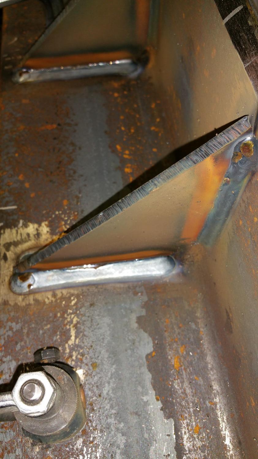

    Spray arc from the 250p using regular 75/25 gas.
Name:	spray arc -.jpg

    Wow,
    Nice brake capacity and design on the cheap.
    The welds look great too!
